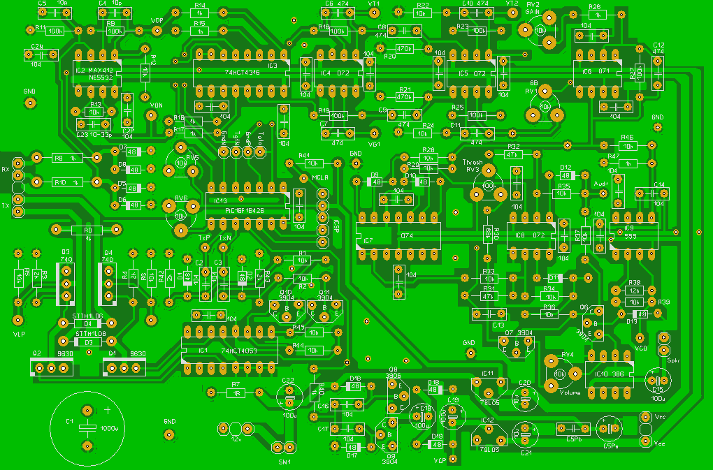

                    In the meantime, I "customized" Carl's pcb design to my own preferences.
                    It is possible that I overdid the ground plane on the top&bottom layers!
                    Carl, please in case you have completed Bipolar PI; to write here the first experiences.
                    In case something needs to be changed or repaired; that I would not order a pcb build until I add any corrections.
                    Here is my "rendering" of the pcb in Sprint Layout.
                    Click image for larger version  Name:	image.png Views:	0 Size:	74.6 KB ID:	433365
