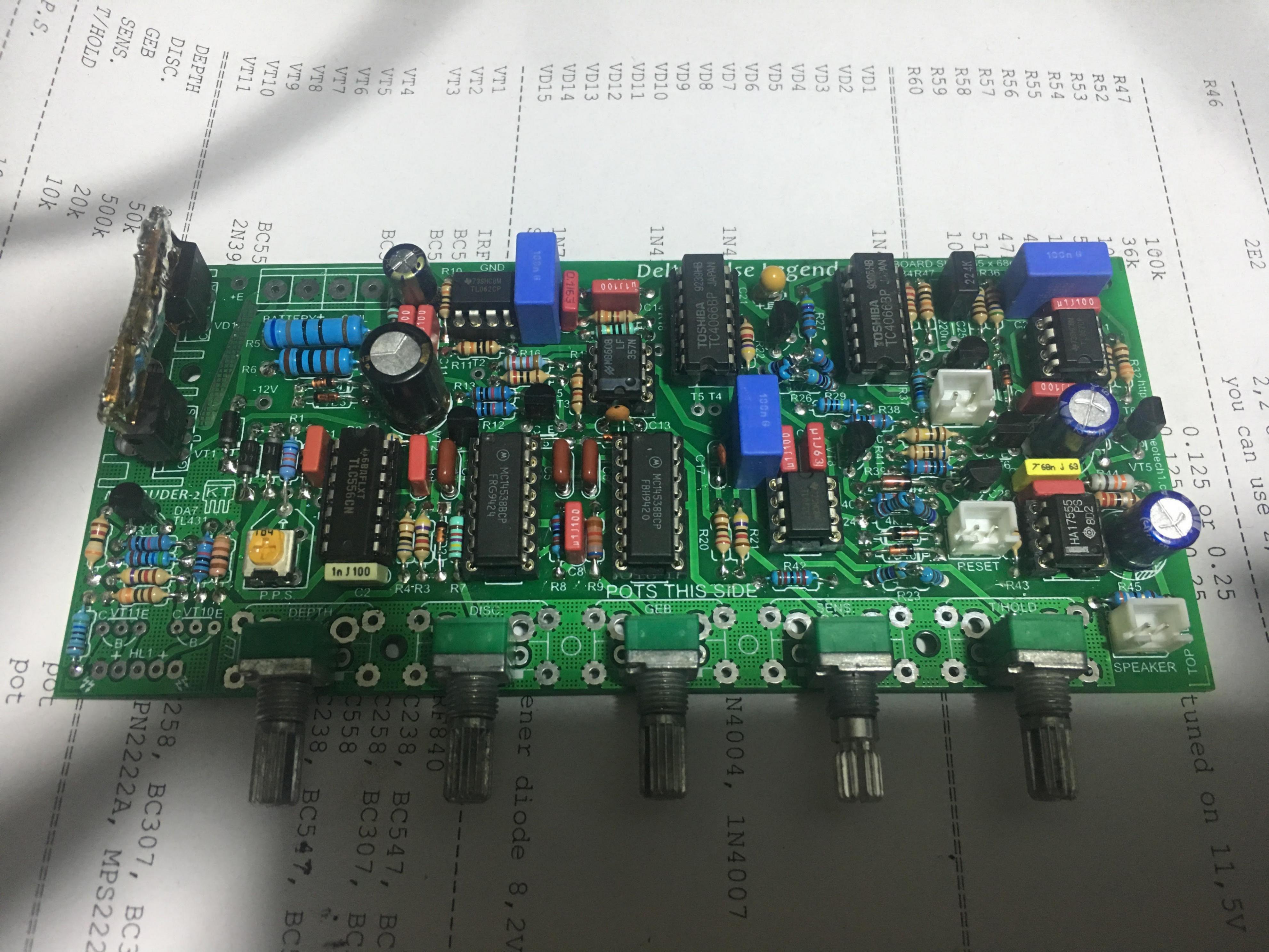

              • hello my friend how much does assembled board? Xr-71 sniffer to send to Greece
                • mainly i sell bare boards. i waste much time on soldering. if you are ready to wait
                  just i do assembled for keith767. sinko price 114 ebay. i will send for half.
ID:	351631 thank you my friend I made a mistake this plate meaning
                      • yes. this is my layout done by chinese guy. it was exchange. he paid for 2pcs pcb but refused and asked to send gerber files.
                        • sorry in russian.
                          my suggestion --- вытащить 555 и прозвонить пины сокета между собой на замыкание. а также каждый пин сокета с платой. 4 и 8, 2 и 6 замкнуты на плате между собой.
                          Vrolok answered:
                          Огромное спасибо за оказанную помощь!!! Под колодкой оказалось что замыкают 2 ножки которые не должны.Исправил, и прибор заработал!В цепи динамика поменял резистор R46 на 47 ом а то тихо работал.

                            • Hi again kt315
                              how is the soldering of the Delta Pulse/Sniffer XR-71 coming a long....
                              • hi keith777
                                i did meet small problem... i noticed there may be a unwanted connection between pots' pins. so i bought isolate tape and wait arrival.
                                that takes a time.
