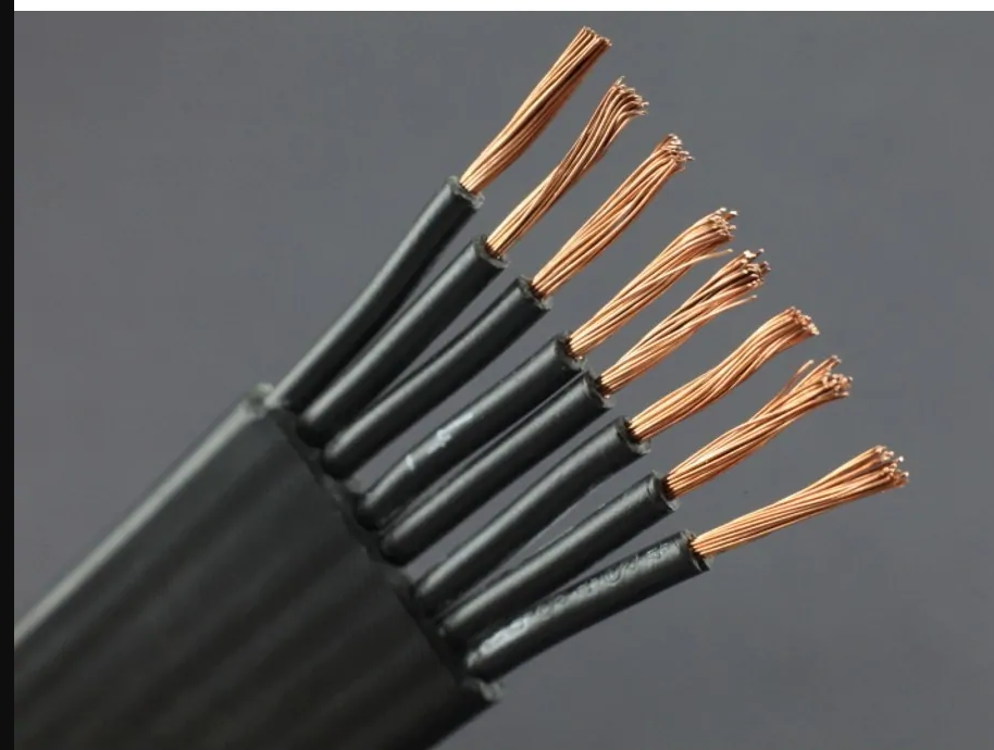

            My precious friend. Thank you very much for your help. I'd like to ask you something. I have such a cable in my hand 8x0,75 pure copper. can I use it to wind a coil? And this cable has to stand vertically horizontally

            • may be good. do two windings and connect its ends in serial.

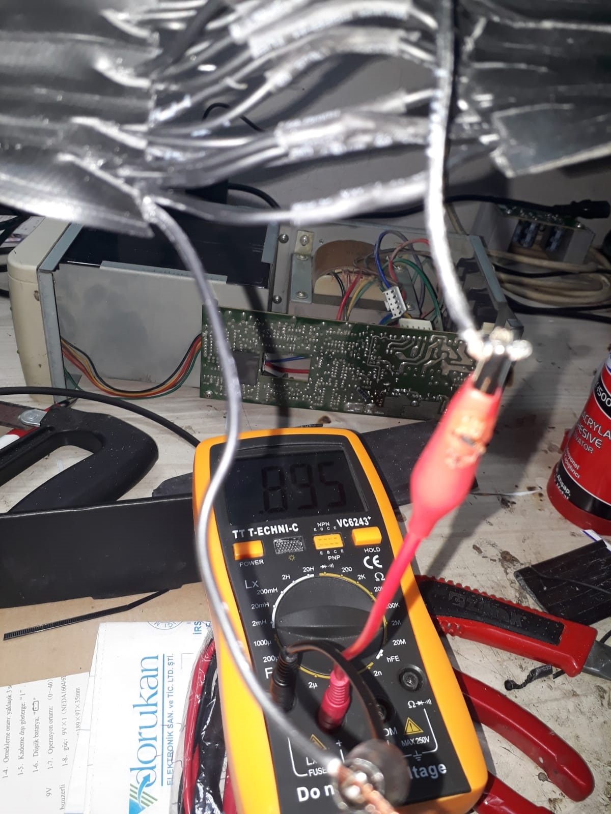

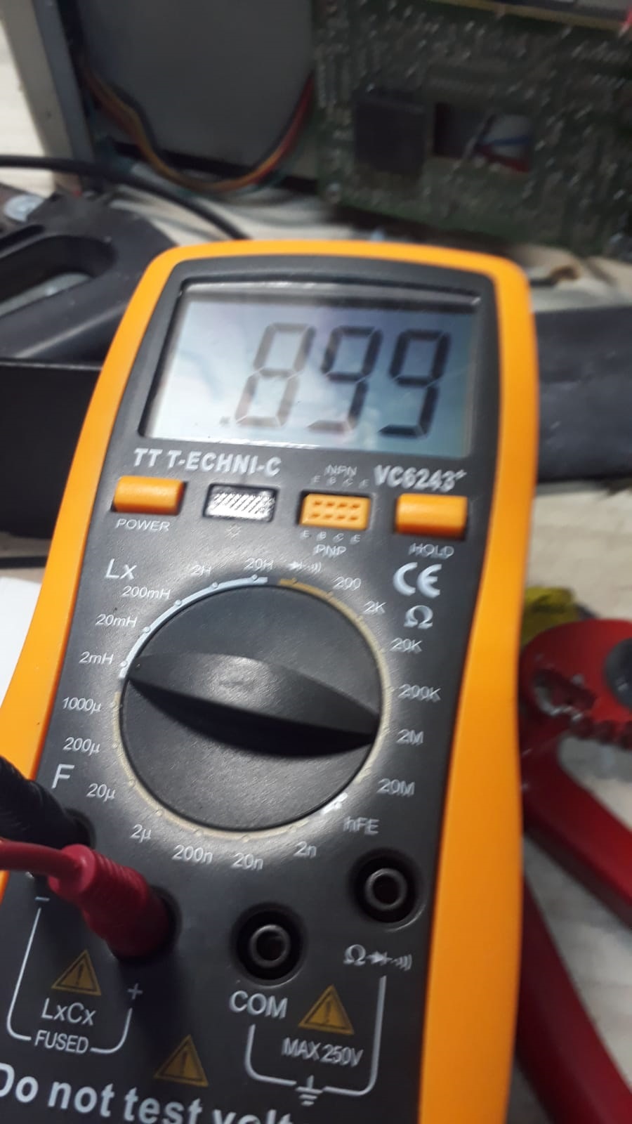

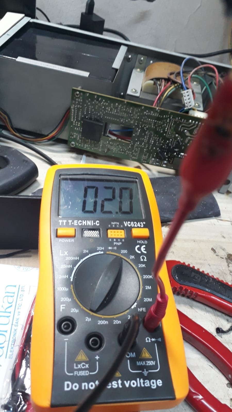

                    salute KT 0.75 mm cable 17 coils wrapped for 1x1m. 2 ohms and 900mh inductance are measured. Is it suitable for delta?

                    • salute. micro is not milli. right 900uH. i think suitable but you have to check yourself.
