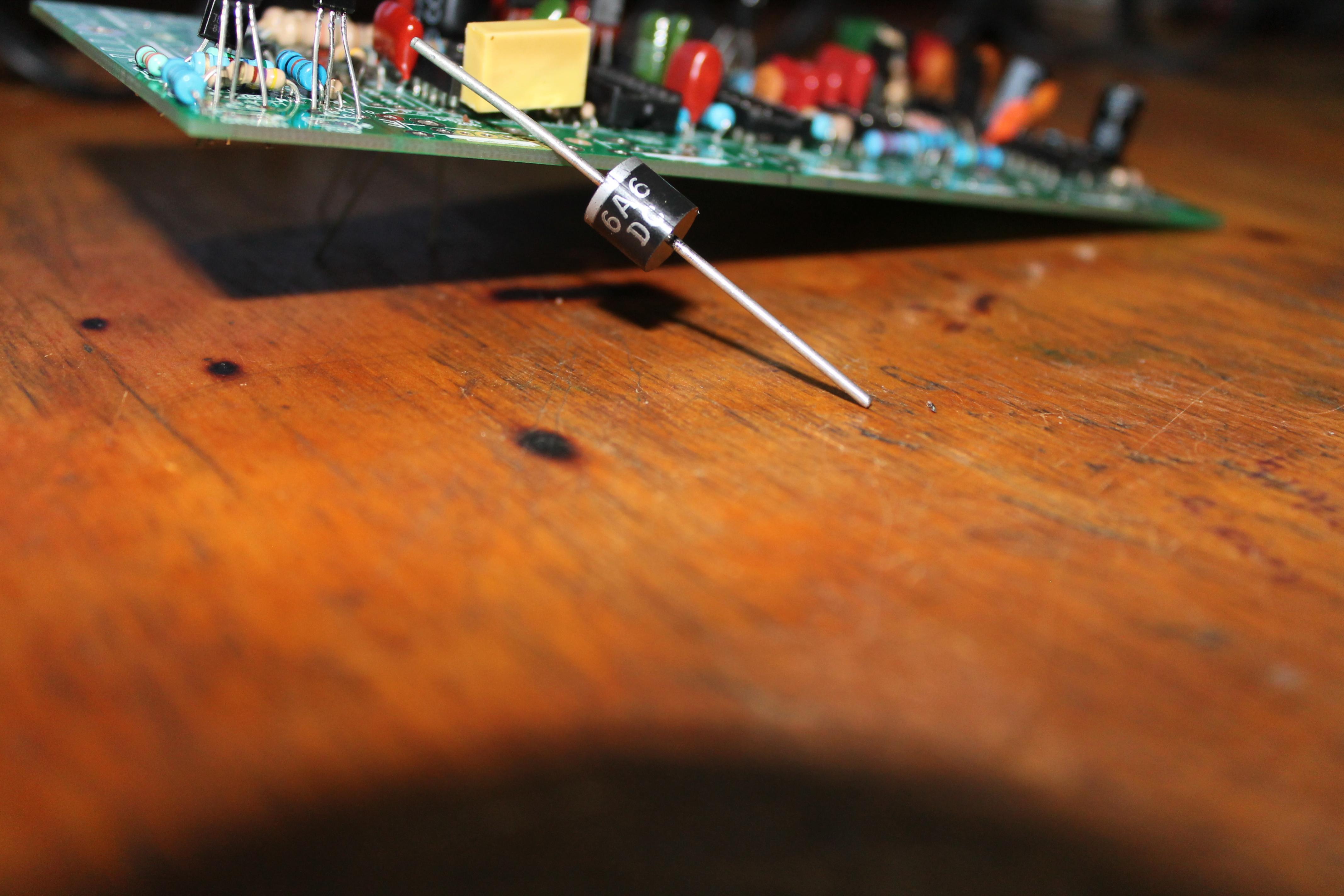

      So, could serve the 1N4739? This what I have in my hands ...
      The Zener diode 6A6 DC, I could also be used to replace the STT??

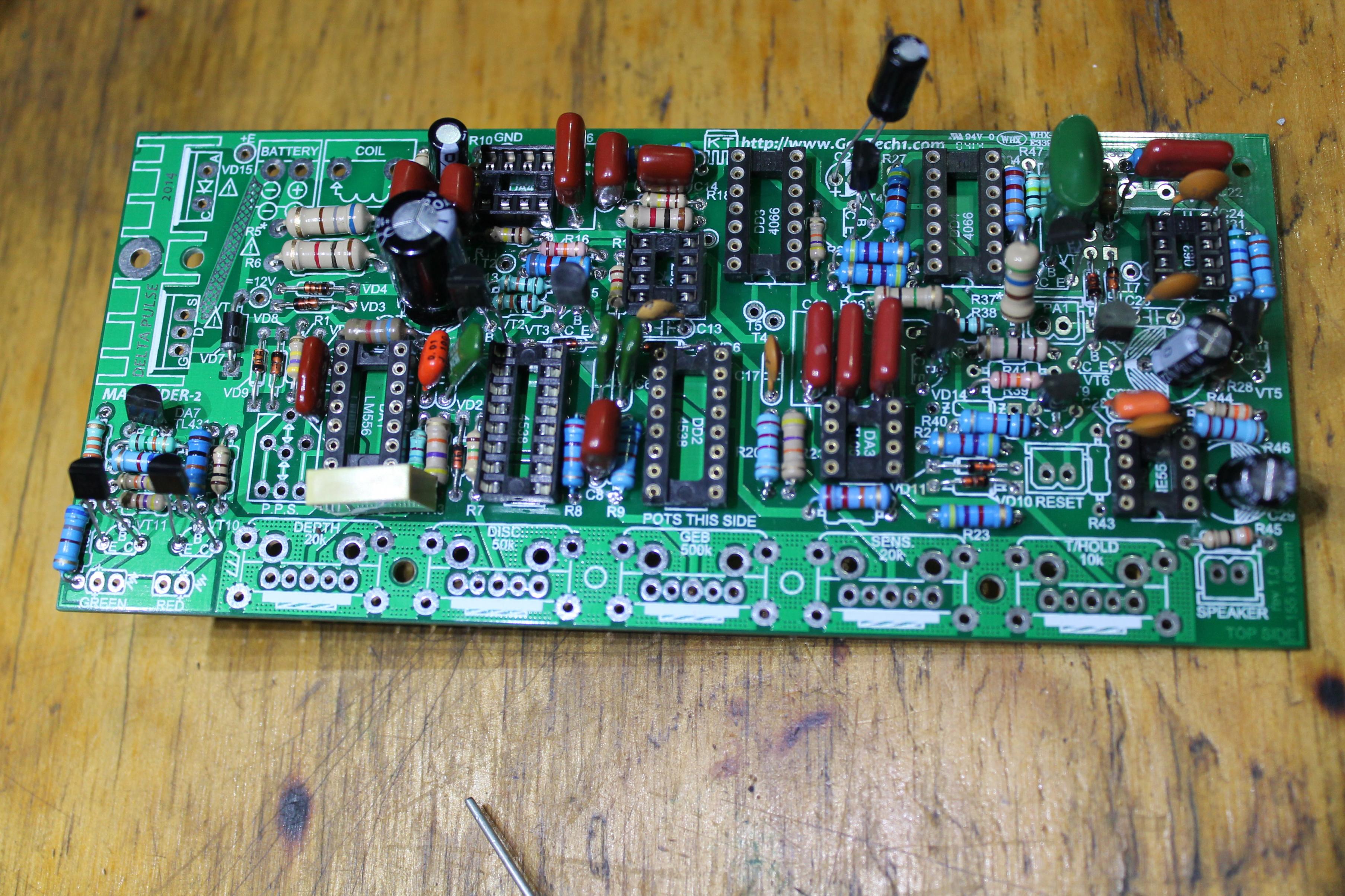

      I attached a photograph of the Delta Pulse I'm building right now ...
      Archive DVD Sniffer ... I found that the C27 is 220uf 16V, but the picture that you have is 470uf 16 V. ..
      While the C29 is 220uf 16v, but I have another file in C 29 is 100uf.
      you confused .. and help me my friend ...
        a voltage is low. you need 1500 V = or > than 10 Amper diode. 6A6 I see a datasheet 600V and 6A. a case is unequipped for an radiator tier.
        nice but why you use 0,5 Watt resistors??? you can use 0,075 Watt resistors if you can not get 0,25 or 0,125W ones around.
        more capacitance will be may be better in some cases. if sizes are allowing you can set 330...470... 680... 1000 uF etc.
        last revision part list attached. delete please all old files my friend from your PC.

                Hello everyone in the forum! Hey Kt315 ... my friend... Forgive my insistence ... I searched like crazy, STTH1210D and I have not found. However, insisting on an antique store, I found the FMGG2cs is an Ultra-Fast-Recovery Rectifier Diodes 1000v ... But I do not know if I could work for me ... I looked rectifiers tv and not found ...
                not affect the Delta Pulse performance?? Thanks and forgive my ignorance ...

                    Hi dear friend Kt3155 ...!
                    I hope you are well! I am the pesky and annoying Heriberto ...
                    I asked some components that I find in my city, I bought on ebay and take 20-30 days to reach ...
                    By the way, almost finished assembling the Delta Pulse ...
                    But I some doubts ...
                    And are those relating to the "T": What connects there? All I know is:
                    PA1: 0-100 mA Panel Meter
                    T1: ?
                    T2: ?
                    T3: ?
                    T4: ?
                    T5: ?
                    T6: ?
                    T7: ?
                    GND: ?
                    = 12V: ?
                    = E: ?
                    However, the large holes in the ends of potentiometers carries an inverted E, it is connected to the copper shielding plate which is placed in the box?
                    Sorry for the trouble I give you, but I think I will have no doubts, my friend ... I hope that when they get the remaining components, the Delta Pulse works perfectly.
                    Best regards
                    Your friend
                    Heriberto
                    • #55
                      Dear Heriberto,
                      I hope there will be first working mexican DP very SOON!
                      PA1 - 50 or 100 NOT MILLI-amper, but MICRO-amper my friend (1/1 000 000). this is why written uA, but not mA.
                      T1-T7 not for wire, these are test points, for checking by o-scope.
                      GND -12V(=12) -E(=E) are test points, for tester measure if there will be necessity. also NO WIRE. (in P-CAD a sign (-) is restricted for designation, so I used a sign (=))
                      the large holes carries +E via R59 (+E is battery clemma PLUS, directrly connected to PCB) so corps of the pots will be touched to shielded layer inside the housing.
                      you may check it by tester that the large holes go on R59 and more nowhere. the copper (or aluminum) shielded plate is connected also to +E but via R60.
                      this is standart way for impulse detector to shield from +, ir MOS-FET is N-channel structure, example is Hammerhead, and from -, if MOS-FET is P-channel,
                      example is SURF PI. in our case we have N-channel and shielding we take from +E.
                      Good luck!
