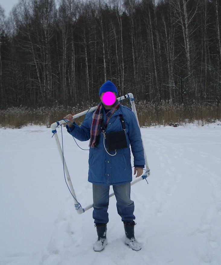

          • Have you used this metal detector yourself? What size coils you used? What treasures you found?
            • i hope you will seek the treasure. job with ramka coil in winter is hard. DP seeks very much metal on bottom of the lakes.
              main problem is how to lift that up from 2...3....4 meters of deep, not to find something on bottom. search magnet does not lift big metal.
              you have to plan where seek the treasure, not me. i went all this way.
              i use 1x1 m coil. people asked me about how to do small coil and i did it. for bara.

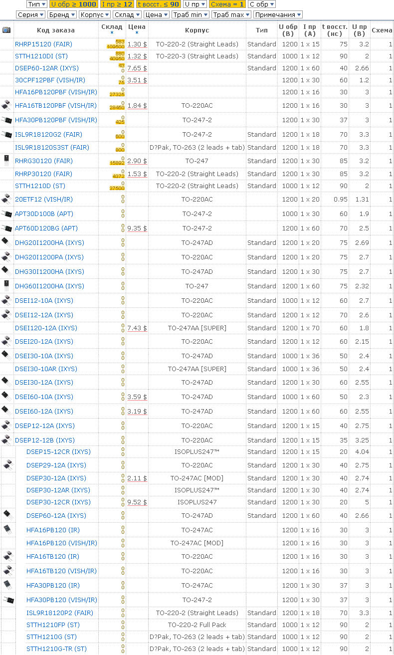

                    • Stth1210d not in my country.
                      We have by359f-1500 schottky rectifier and rhrp30120 600v 15a hyper fast....
                      Can i use these?
                      • you refuse pay for:
                        - high voltage diode
                        - DVD with archive
                        - operational amplifier tester board
                        close by a jumper the pins of the diode on board and forget it.
                        • i many time answered on this question.
                          http://catalog.compel.ru/vd/list?SCH=1
                          1000V
                          -!!! you must seek 1000V >=12A one.
