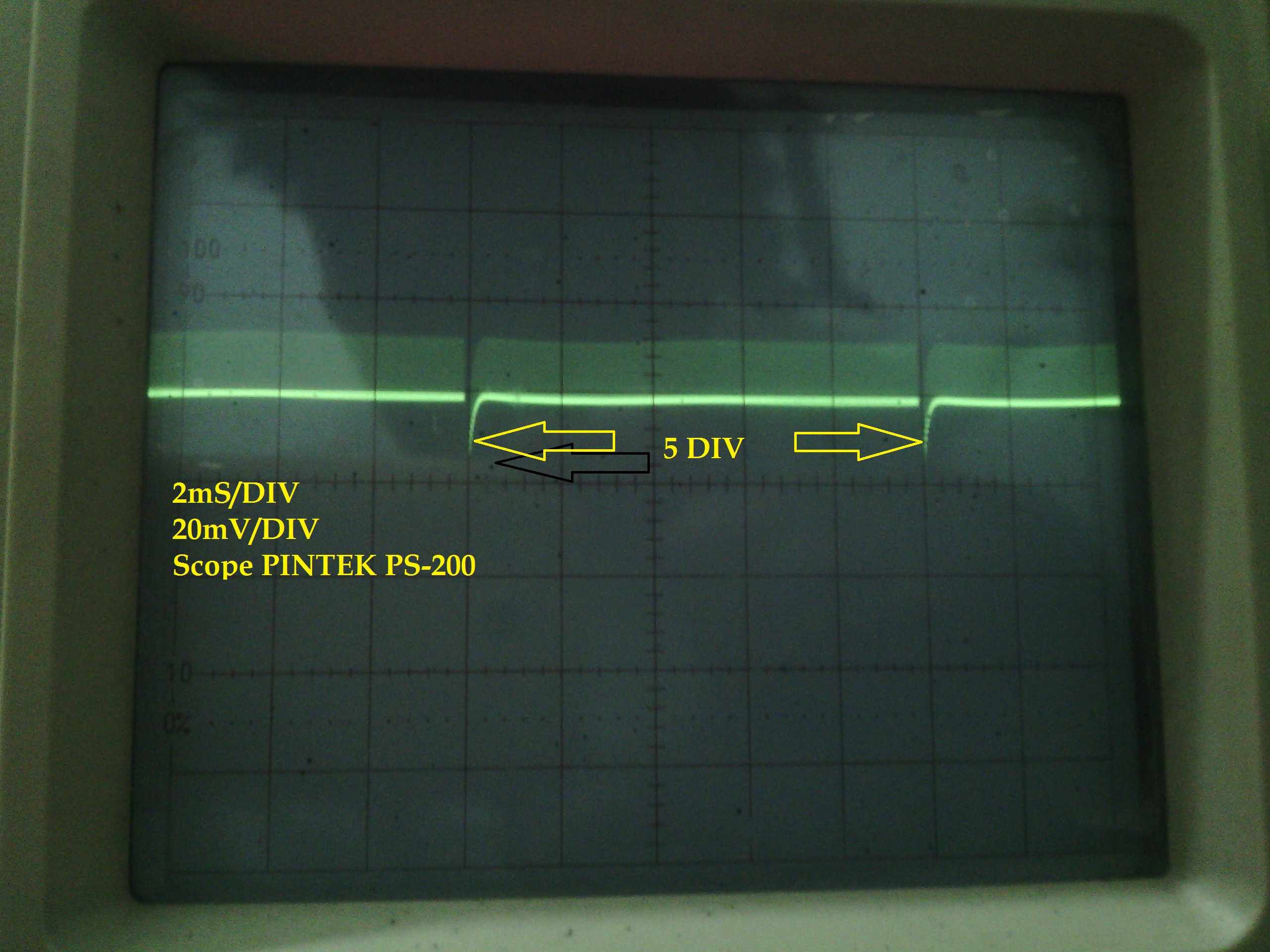

          This is AC voltage 20mV/DIV 2mS/DIV 5DIV = I have tuned PPS to achieve 100Hzs. Is this ok? It gives a totally different look on X-Y mode !

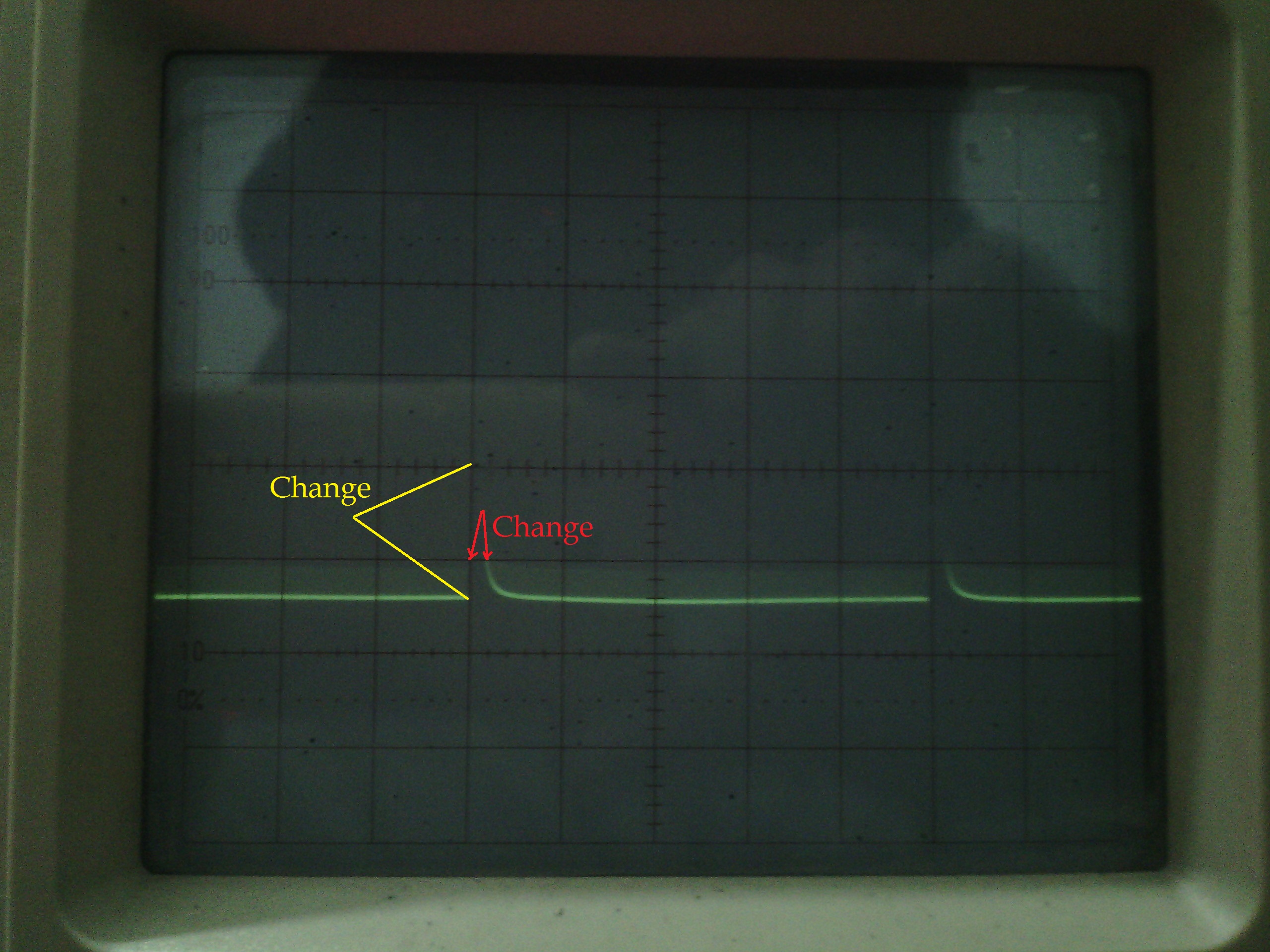

              With same settings of oscope i touch the probe to T3 and nothing changes. See this picture when DEPTH pot is turned to full left. Click image for larger version
              Now i turn the DEPTH pot to full right and there is very small change in frequency a significant change in Y scale (volts??) Click image for larger version

              • switch o-scope timing range on 100us and give pics 'full left' and 'full right'.
                you voltage range on 0.5V. with probe x10 you get 5V on cage.
                  switch o-scope timing range on 50us and give pics 'full left' and 'full right'.
