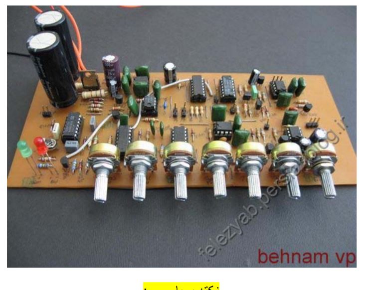

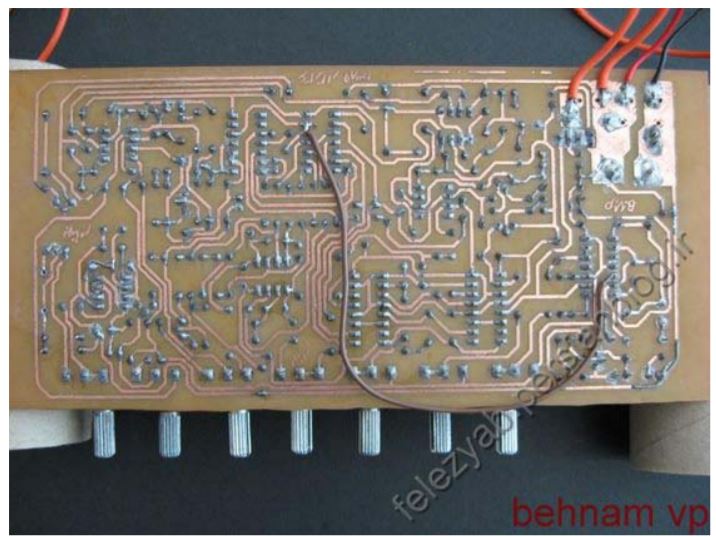

          Does this look like your Delta Pulse Rev 5 board?
ID:	355356 Click image for larger version

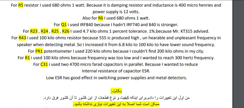

          Are these the components used in Rev 5?? Click image for larger version

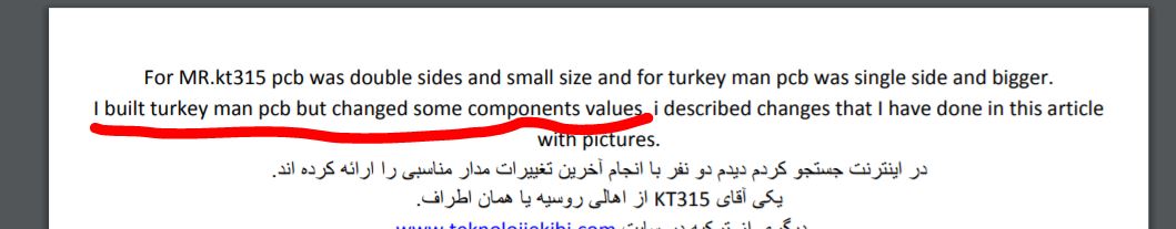

          Have you seen the frequency used by him ??? This PDF can be gold for those building this brand and model for these settings but for DP REV5 it is trash. Why you misquote the work of right alien ??? You know very well about my level of skill and knowledge. It clearly says this is turkish board. Click image for larger version
ID:	355359 You disowned turkish board many times and refused to discuss about building and performance problems faced by members. But now you are giving me same design as guide for building DELTA PULSE REV 5 !!!

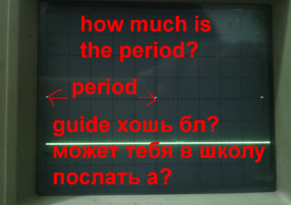

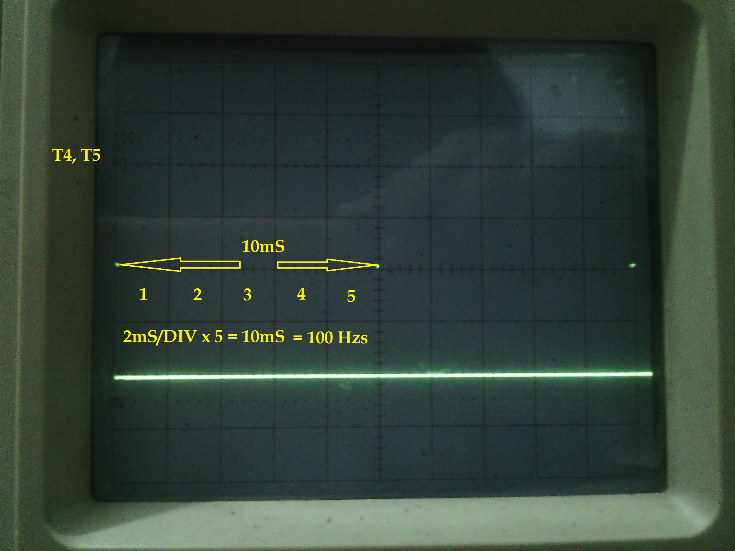

            you have to see whole period. click timing scale on 2ms (MILLI--).
                [ATTACH]47935[/ATTACH]
                T4 and T5 time period is 10mS or 10000 uS. The frequency is 100Hzs.
                Now to next test please.

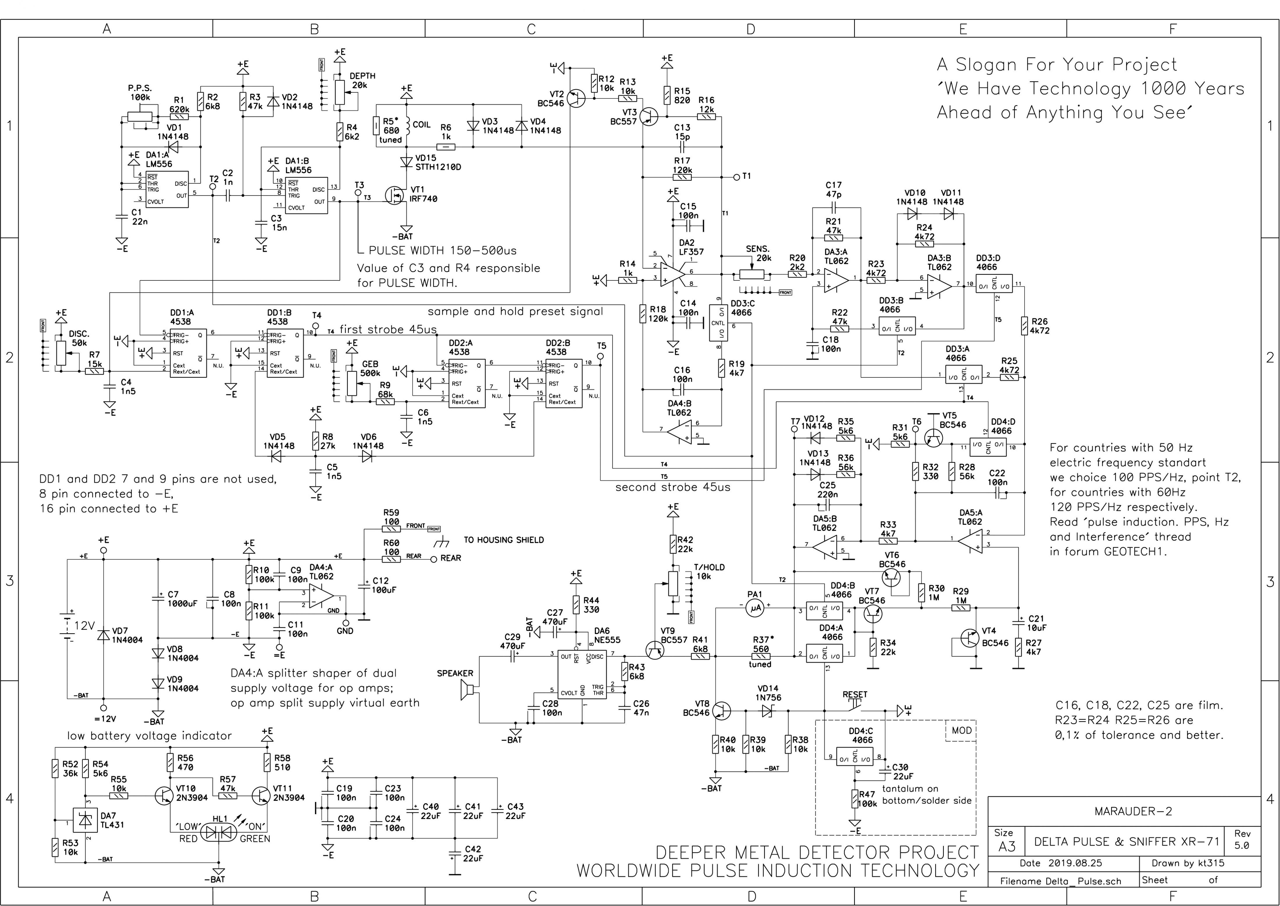

                      • sch file
