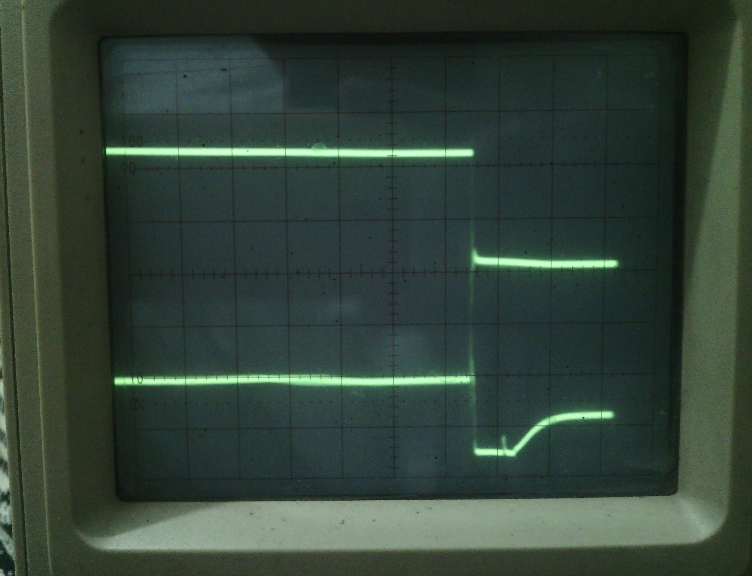

  • is your oscope two channel or one?
    • My oscilloscope is Two channel 20Mhz

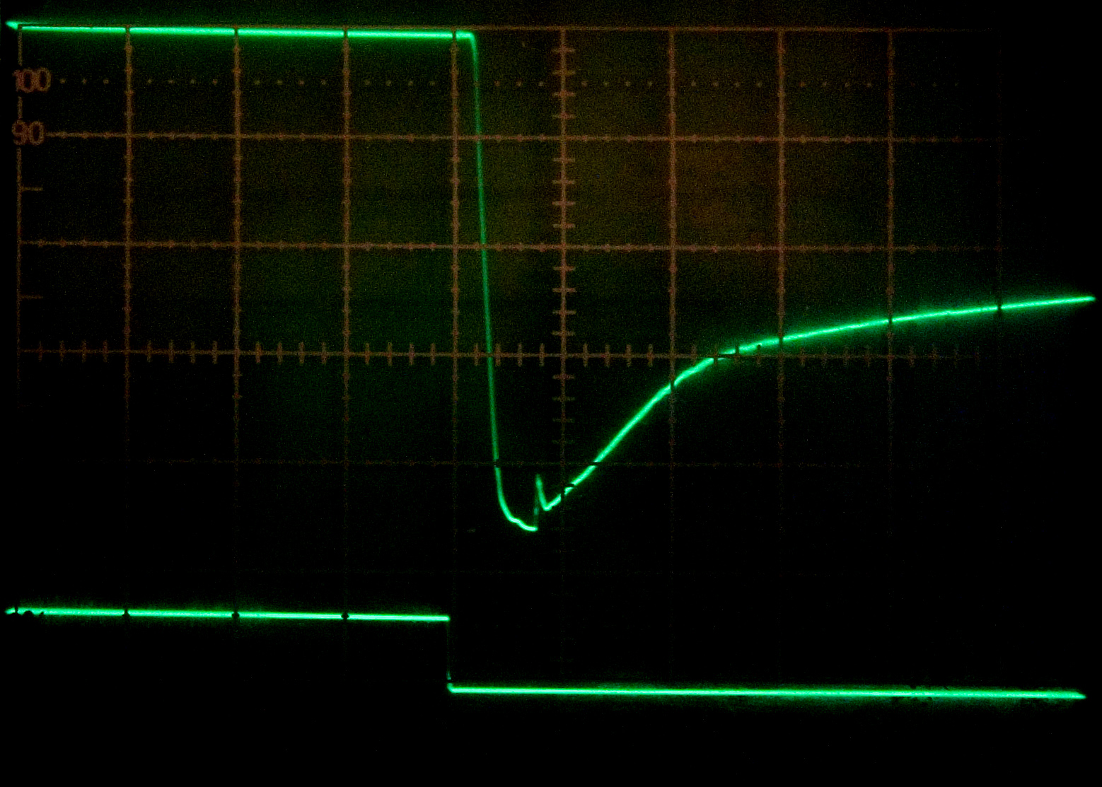

      • set 1st probe on T3, 2nd probe on T1. 0.5V/div, 10us/div.
          [ATTACH]47938[/ATTACH]
          I have this result Click image for larger version
          T1 Click image for larger version
          T3 Click image for larger version
          • increase DEPTH and SENS, look a reaction on copper.
            • Ok Now it is detecting copper.
              • you have to shield a case and then put the pcb inside.

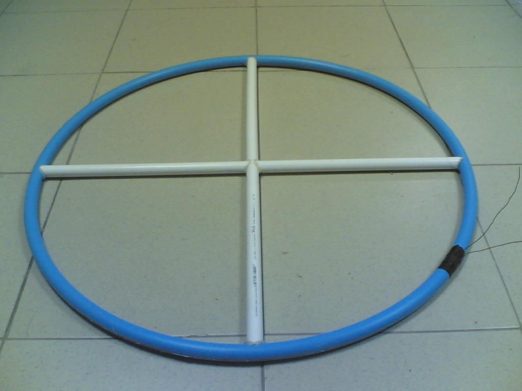

                      What minimum size coil i can use with this ?
                      Thank you very much for assistance.
                      • I have installed all tantalum capacitors.
                        • Originally posted by chuubaba View Post
                          ok
                          on pics

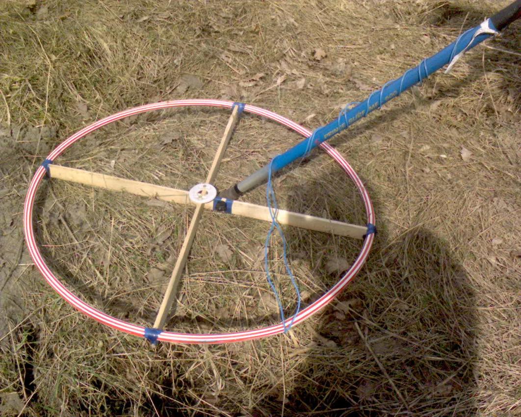

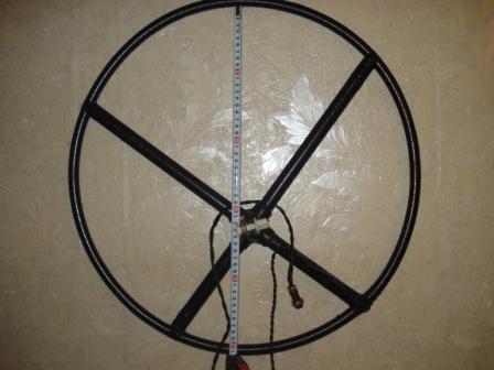

                          • I made round shaped 500mm coil. It is 400uh. 2.15 Ohm resistance.
                            It's detecting a 400ml can of WD40 upto 43cm. I am not impressed with depth.
                            What can be the cause?
                            Also the test coil was giving excellent iron rejection but with 500mm coil the discrimination is gone.
                            • Sheilding the board will cerainly improve the performance but will it be sufficient?
