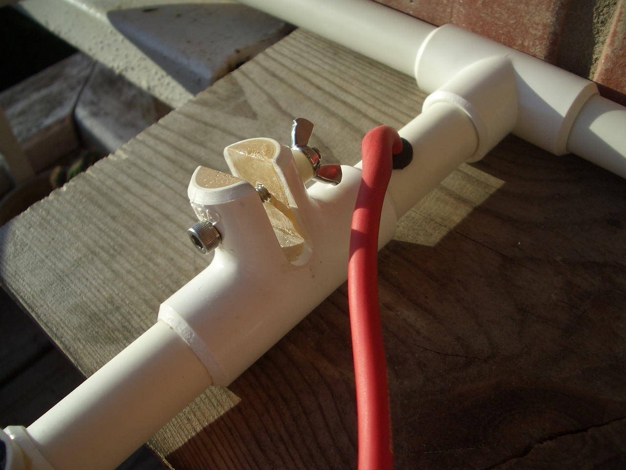

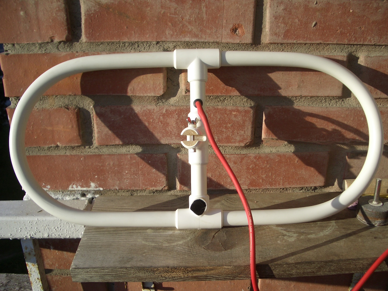

        • small coil from DEEPERS 10DD. i do not remember a size, maybe anyone can reminder.
