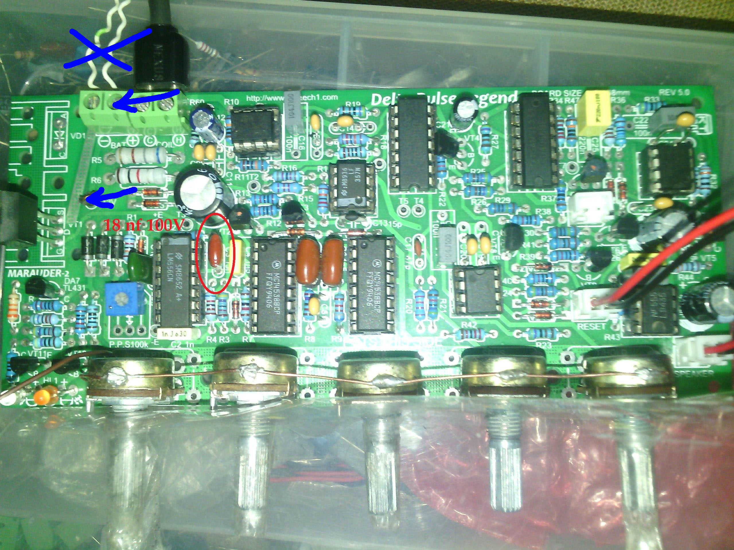

    ....measure voltage on pic [ATTACH]48157[/ATTACH]
    +E 11.99v
    • measure voltage
        measure voltage
        [ATTACH]48158[/ATTACH]
        -E 0.08v
        • you burned negative copper trace somewhere.

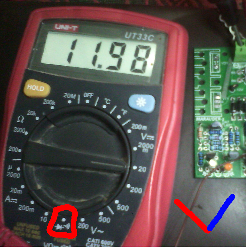

          choice range RING-OUT on your tester and do closing the probes. you have to hear a sound. is it ok? Click image for larger version
            you burned negative trace anywhere.
            choice range RING-OUT on your tester and do closing the probes. you have to hear a sound. is it ok? [ATTACH]48159[/ATTACH]
            Yes
            • disconnect battery from board. in this tester mode set its probes according a pic
              sound?
                sound?
                [ATTACH]48160[/ATTACH]
                +BAT + -12v = No Sound
                • sorry, BAT- and -12V.
                    No Sound "BUT" meter reading is 1699 then 1599 then "OL"
                    • Originally posted by chuubaba View Post
                      This also has NO Sound BUT meter reading is "always" 532

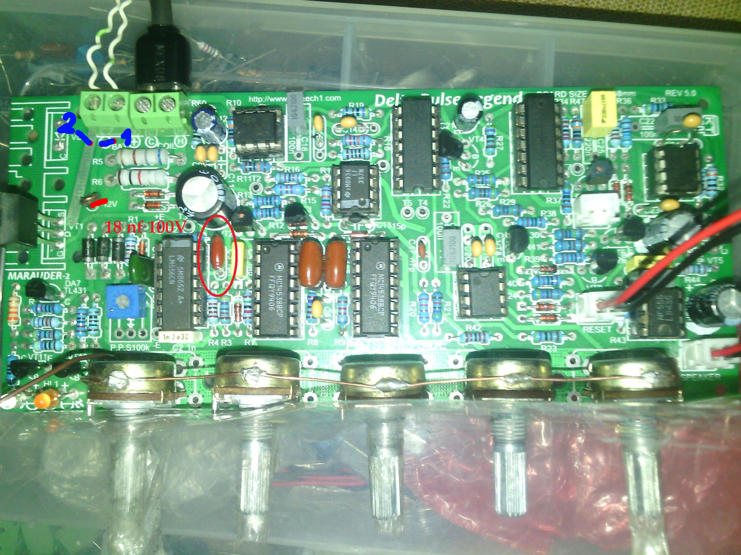

                      • in point 1 delete a 'green varnish' by scalpel getting a contact to copper. just little spot.
                        set probes on red and 1, then red and 2. you do not have to delete copper layer/trace.

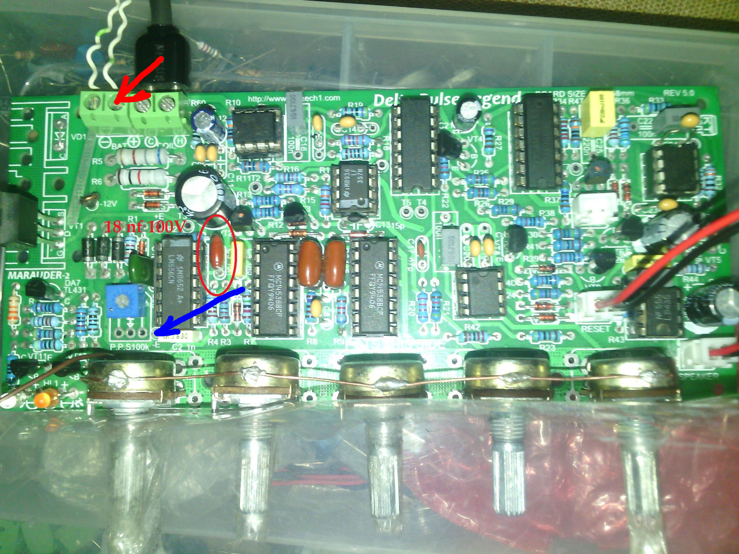

                          [ATTACH]48163[/ATTACH]
                          There is sound if i connect -12v with Source of MOSFET.
                          -12V + MOSFET SOURCE = SOUND
                          • i think you snatched off the metallization of -bat pad of terminal block desoldering.
                              Should i connect -12v with BAT- using insulated wire on bottom of the board?
                              Or i lay a wire "on Top side of the board" ?
                              • YOU SHOULD FIND THE CAUSE OF LACK OF (-) VOLTAGE ON BOARD.
                                DO NOT FANTAZY "WHAT YOU SHOULD DO" -!!! I AGAIN SAY YOU DO NOT FANTAZY.
                                seek around. sniff the board up with magnifier.
