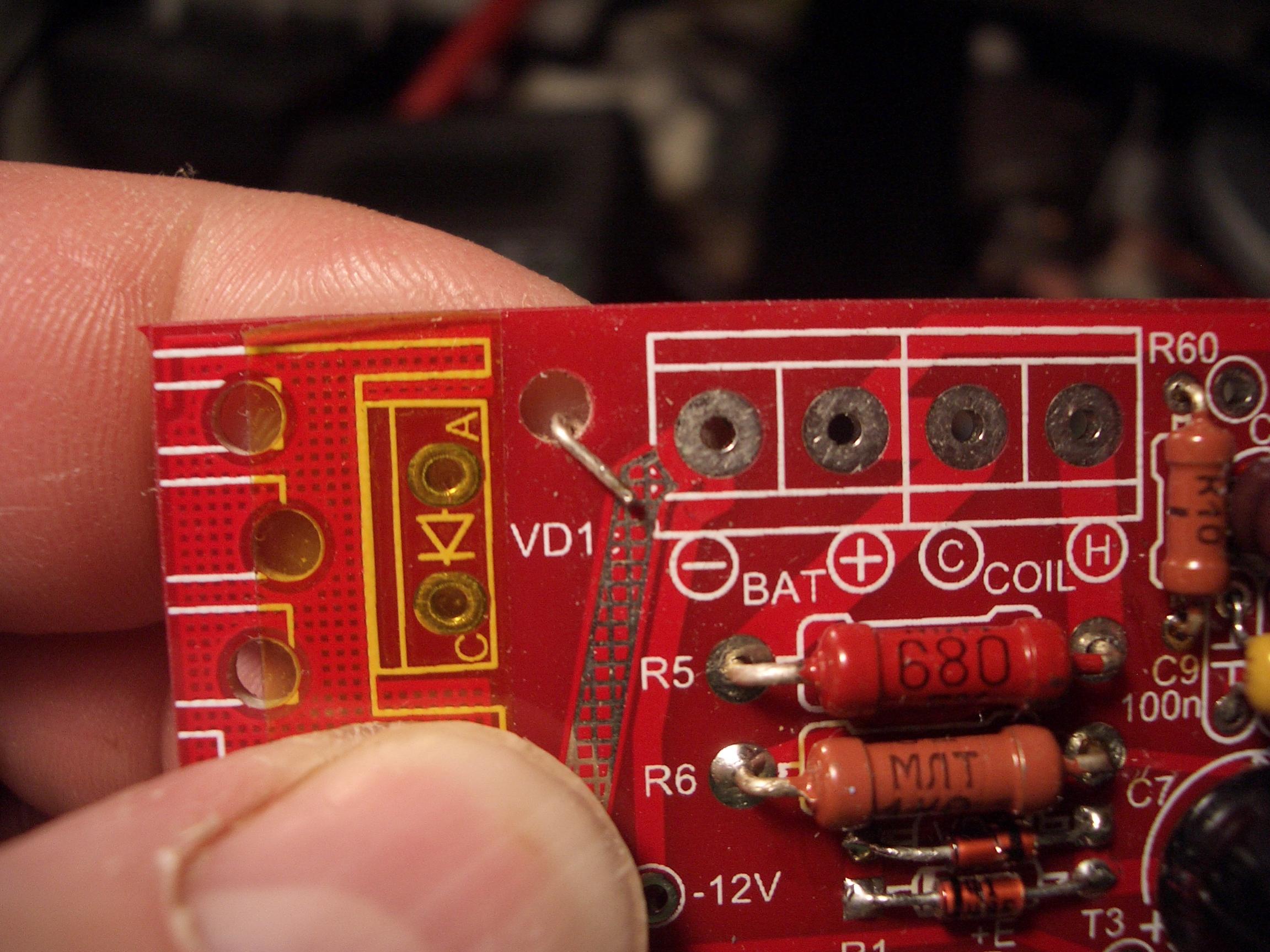

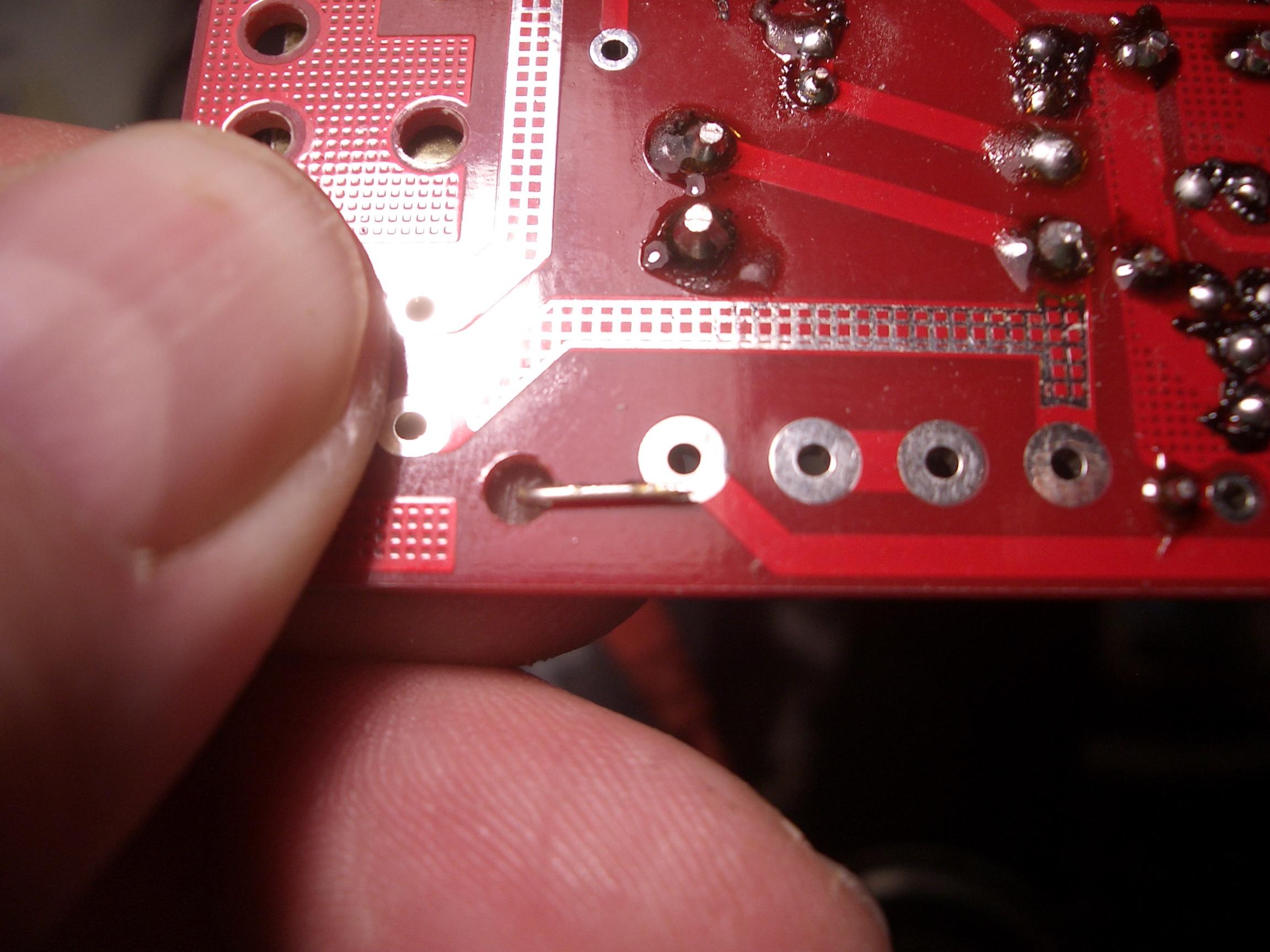

    • "Pulling" and "prolonged solder iron" on the terminal block disconnected BAT- from -12v.
      • take a piece of naked wire (cutted pin of resistor or cap) and solder its ends on both sides of board via hole.
        on pics
          on pics
          [ATTACH]48165[/ATTACH]
          [ATTACH]48166[/ATTACH]
          I have soldered as shown in the pictures.
          • ok. connect wires from power supply and look on LEDs.
            • But there is "no sound" between BAT- and -12v
              • I bed your pardon. The power plug was "off"
                Yes it working now.
