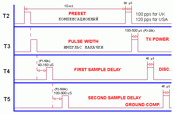

      Please tell me what's these pin's
      T3
      T4
      T5
      T6
      T7
      E+
      E-
      • hi
        those pads are control points to tell main working principle of sch, a work of the sch, testing and fixing in case
        of a problem via o-scope.
        E+ and E- are points for checking of power supply and for connection of extental additional device pcb (LCD module of DP2, just for example), also other points too.

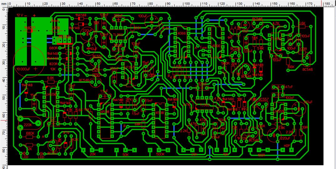

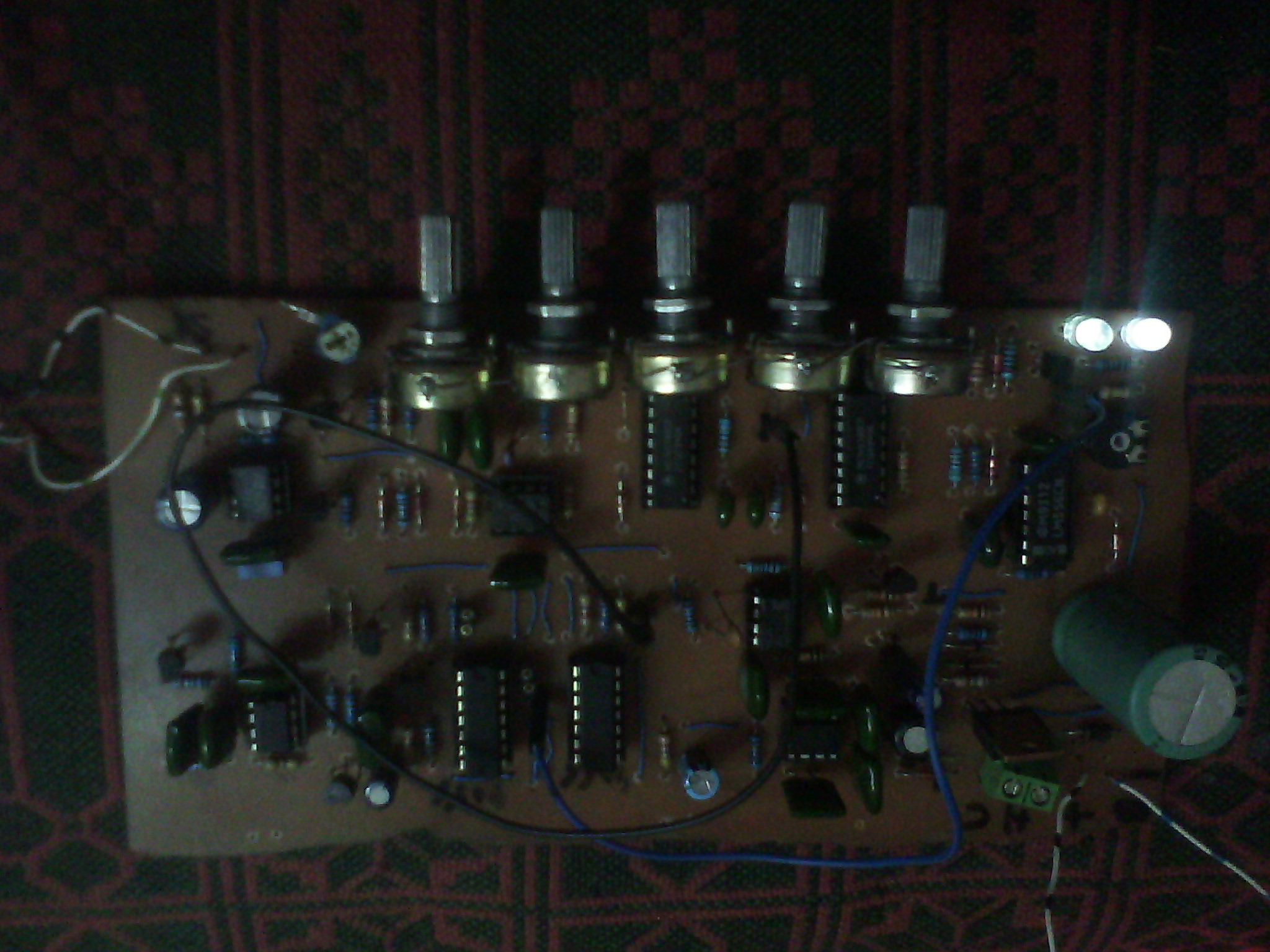

        • I Need help in testing and working thiis board. Made this from KT315 "MILAN KARAKAS" file.
          Both LED are ON and it makes very very faint sound. It is not detecting anything.

          • The single layer 'milan karakas" board is now working with the 28cm test coil. It has shown excellent discrimination with the test coil. Again lack of depth. Also i am unable to find what is the function of 220k variable and how to see it work on oscope.
