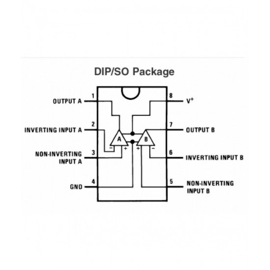

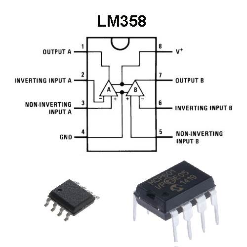

                              Secondly, I have another problem with me regarding this piece"LF357" , can I exchange it for this one "LM358" ?
                              thanks
                              + Reply
                              • sure NOT. LM358 is NOT JFET type, NOT 50us/v speed having. in DP you can not use LM358 somewhere.
