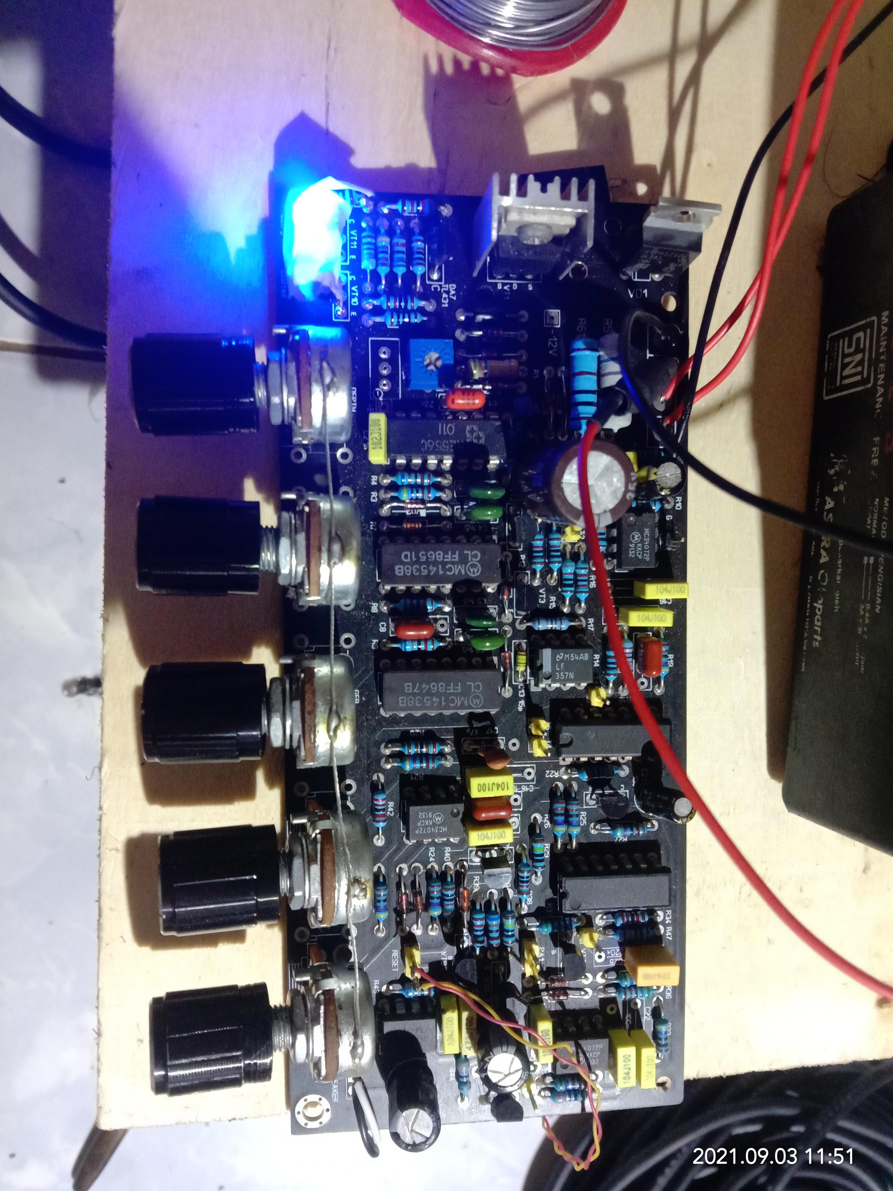

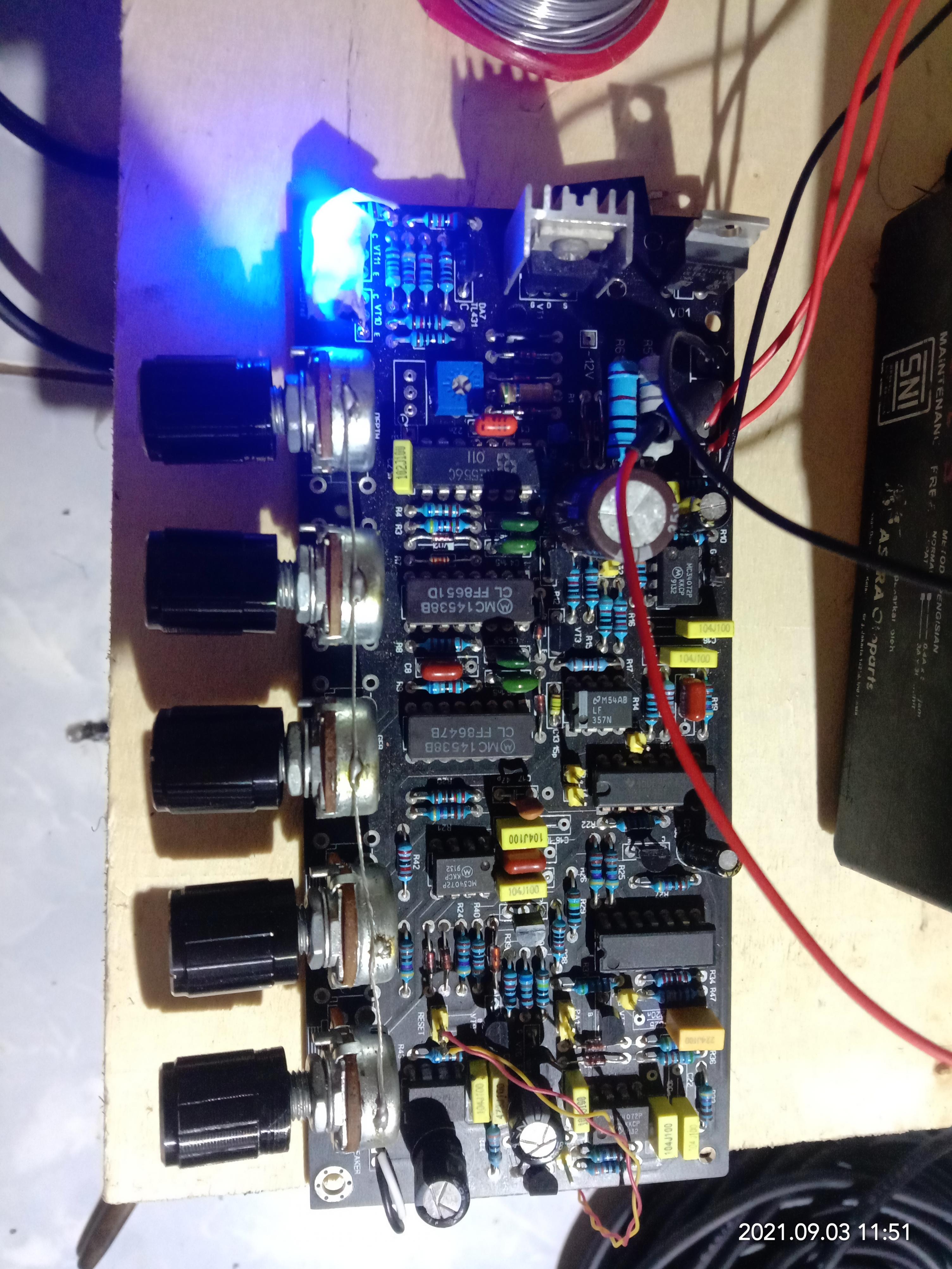

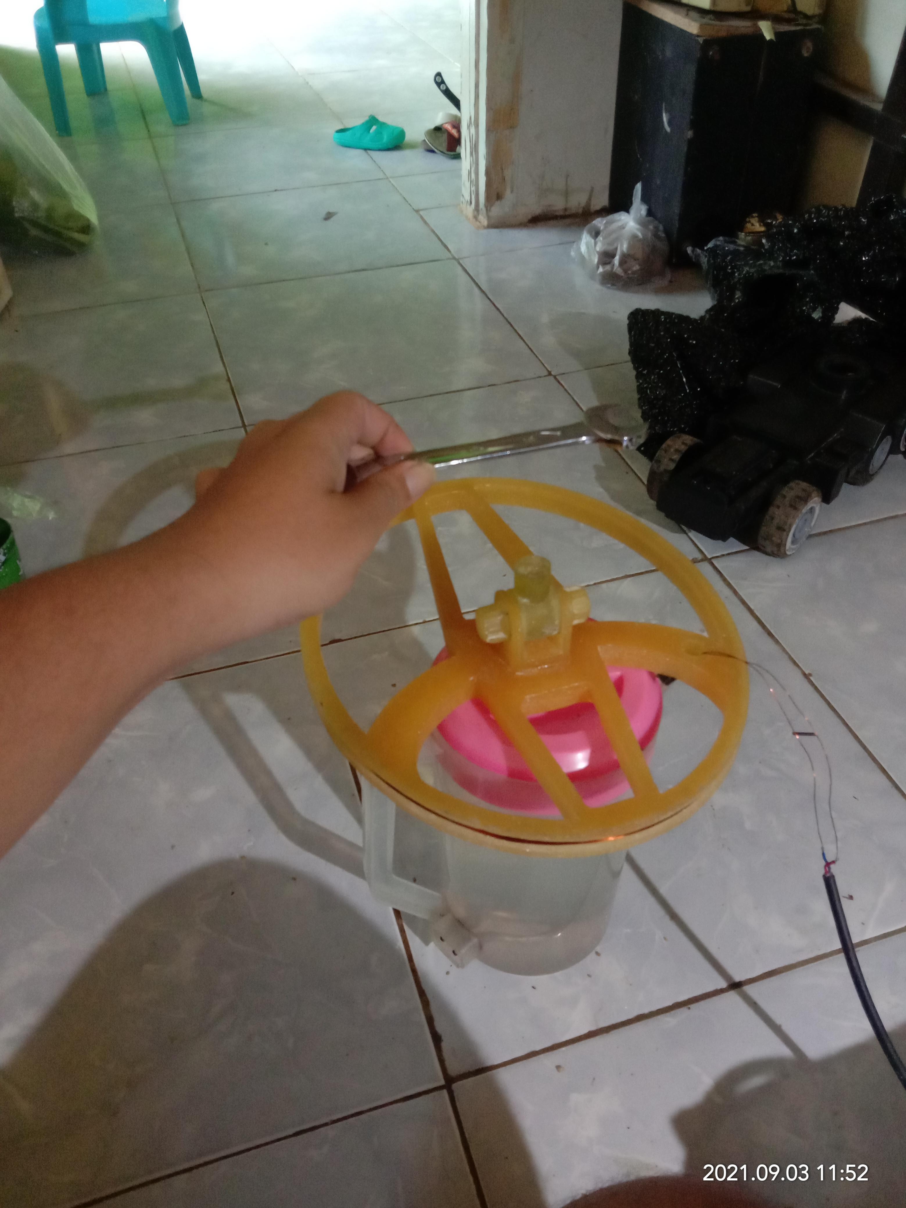

                      • hi kt315 hope you are always healthy, I learned a lot from you about metal detectors, this time I got a problem with the delta snifer, my delta detected very close, my coil uses 420uH, and the layout is in accordance with your lcb, can you help the power to fix it , detection spanner no 19 is only detected 10cm, please help me
                            • are you able to read sure right the BOM file? its CLEAR THERE that op amps are JFET -!
                              JUST JFETS
                              while you use ordinary one. https://html.alldatasheet.com/html-p...2/MC34072.html
                              FOLLOW STRONGLY THE BOM FILE AND DO NOT TURN UP YOUR FANTAZY.
                              hope you are always healthy -- i'm psycho if i see a newbie thinking 'kt315 is the crazy idiot because i will do what i want to do. anyway DP must work!'

                                ��������my mistake, I only saw the pin out without looking at the datasheet, I think it can work,,,, okay I will try, thank you for your service master, I hope you are always healthy
