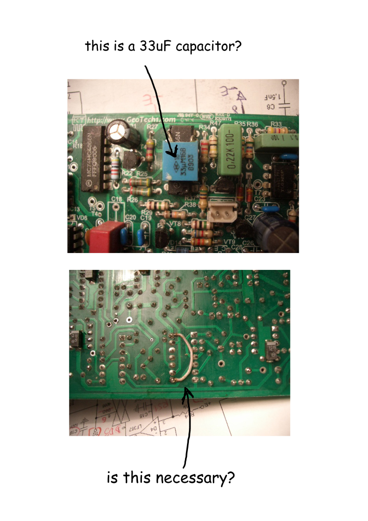

            • Not to sound silly.
              Hi I have some questions.
              why did this photo marking the doubts I have.
              1. is proved necessary to put the elements of the picture.
              2. R23, R24, R25 4.72k resistors are but I want to know if I can put something on that I found not.
              3. I found the R1 620K also can put another in its place and what would all those endurance replacement.
              otherwise just out of curiosity, this is not you can put the lcd right ...?
              thanks in advance.
              • questions
                I forget that silly photo
                why did this photo marking the Doubts I have.
                1. Necessary PROVED is to put the elements of the picture.
                2. R23, R24, R25 4.72k resistors are but I want to know if I can put something on That I found not.
                3. I found the R1 620K Also can put another in Its place and what would all those endurance replacement.
                Otherwise just out of curiosity, this is not you can put the lcd right ...?
                thanks in advance.

                • I forget that silly photo
                  pls do not do a mod if you do not know -
                  1. where the mod was described;
                  2. what gives the mod.
                  5% 10% tolerance resistors have a nominal 4.7k, but 6 band colour 0.05% 0.1% tolerance resistors have a nominal 4.7xk (4.72k). because THE TOLERANCE.
                  you can put any value resistor but have to get 100Hz in T2 point, for electric net standart 50Hz in your country, or 120Hz, for 60Hz electric net standart.
                  FOR USA - 60HZ - 120HZ
                  FOR UK - 50HZ - 100HZ
                  and what this give you? more depth? discrimination? what? DP is not THE sh.ttector to put lcd in every hole.
                  thanks in advance.
                  good luck
                  • the R1,620k and found it but I can not find the 4.72k resistor, only found the 4.7k, 4.75k with a tolerance of 1% and I wonder if any of these are used.
                    else in a photo I saw that you can also replace the LF357 by TL081CP.
                    It's true.
                    • ok, use 4.75k. you can use - 4.68 4.7 4.72. 4.75 4.76 4.77 etc. they have to be EQUAL in couples - R25=R26 R23=R24. FOR EXAMPLE - you can take
                      4.68 for couple R25=R26 and 4.77 for R23=R24.
                      yes, I use TL081 because I have not LF357, but I have to DEMONSTRATE for my potencial orderers that MY BOARD IS WORKING
                      BOARD, no MISTAKES, NOTHING OF NECESSITY TO DO ADDITIONALLY.
                      why the part list to DP board is NOT enough for you???
                      • a link I told about successful testing of autoreset mod http://www.geotech1.com/forums/showt...-Pulse/page102
                        you have to get working board at first, then to think the mod is needed for your or not.
