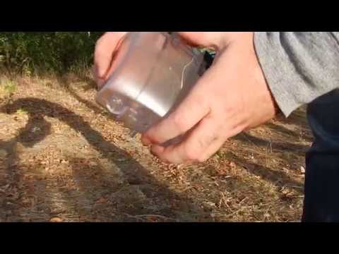

                      Boxing material - polycarbonate (very strong, but also very soft in respect of scratches)
                      Boxing was made taking into account that search will be run in the mode - on foot.
                      That is not small depths - in actual practice ~ 1 meter of boxing (the searcher up to a breast, a neck who as will get used). For these reasons it is possible to use any earphones with the socket big Jack (mono).
                      Is established on a regular place of the control unit.
                      Special skills it isn't necessary for installation.
                      Testing was held at a depth of 3 meters (successfully, at this depth I lay within days)
                      We take average figure 2 meters, it and will be the guaranteed boxing immersion depth.
                      Boxing has positive buoyancy, when finding the purpose it is possible to release the detector and he will swim near the searcher.

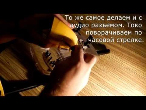

                      Connection of the coil standard - it is a little necessary to finish the socket:
                      To disassemble the socket, to miss the mark with silicone adhesive contacts (goes in a set), and after drying to fill a socket cavity same with silicone adhesive and to collect.
                      Then, after full drying it is necessary to grind off a socket end face approximately on 1mm.
                      The sealing ring is inserted into the coil socket on boxing (in a set)
                      the end face of the socket of the coil is greased with silicone greasing (in a set),
                      the nut on the socket is inserted and is standardly tightened (not strongly)
                      The exit to earphones, also has a sealing ring which doesn't allow water to get into a nest.
                      I ask to pay attention that at the case of boxing there can be inclusions of vials of air, and on a surface there can be small scratches.
                      These factors don't influence durability and working capacity.

                        crash test
                          moding of connectors
