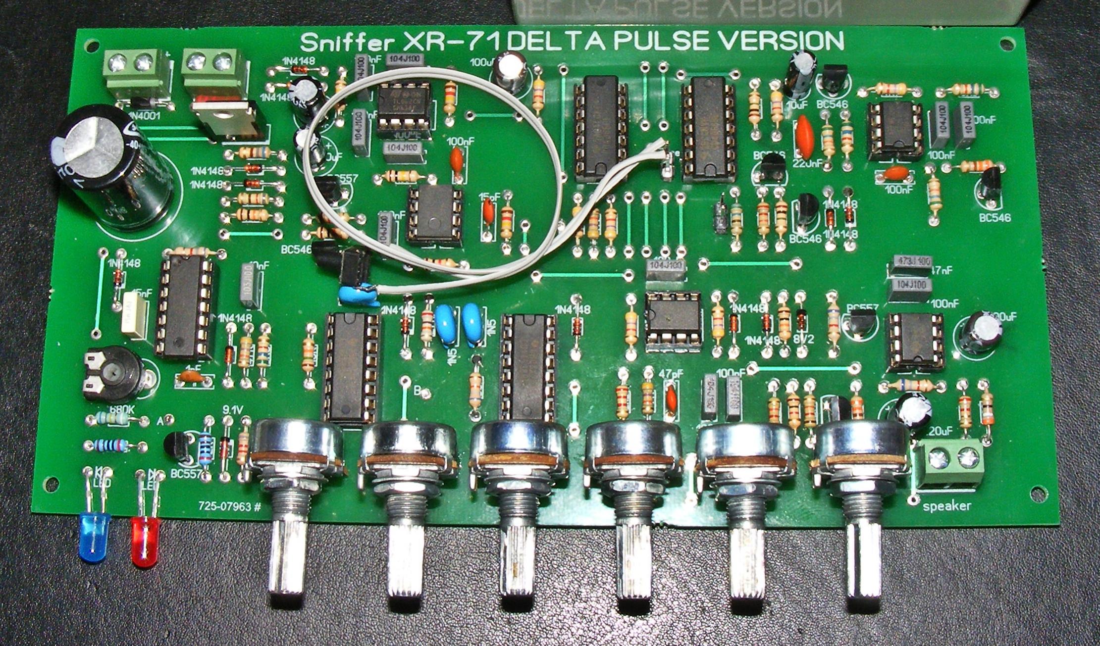

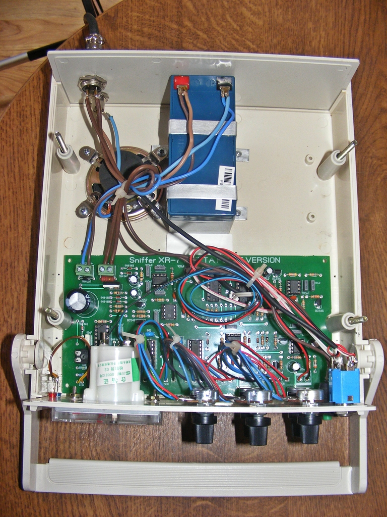

    i was wondering if anyone has a decent pi board that allready has its electronics components on for sale. i want to replace it with the Sniffer XR-71 DELTA PULSE board that i have in the enclosure showing.
    i bought the Sniffer XR-71 DELTA PULSE board from off a seller from italy on ebay last year. the board has never worked properly. two of the settings don't seem to do any thing. the detecting depth is very poor. no matter what you do with the setting. 10" detecting depth on a pop can is as good as it gets.

              when i bought the board it was already made up with all of it's components etc fitted to the board. all that was needed to do was fit a speaker, battery and coil and you were meant to be ready to go. as i said there was a couple of guys on this forum who also bought the same board from the same seller in turkey and they had the exact same problems as i was getting.
              since i am not an electronics expert. trying to work out what it's faults are, well that isn't going to happen. i did contact the seller a few times about it but they were no help at all. they did emailed me a schematics for the board, but that didn't even match the board i had. it had 7 potentiometers fitted on schematics but my board only had 6 potentiometers fitted.

                  i bet that sniffer has fake ic's on the board, there were some turkish pre built and kits that had crap components, nothing wrong with the boards per-se but the ic chips were fake, removing them and replacing with correct ones fixes the boards(as well as any other sniffer lol).
                  it looks like your board has sockets so no soldering needed, just identify each chip and replace, silverdogs shop is reliable get what chips you can there then source the others, even bought from digikey or mouser it would not cost much to replace the chips.

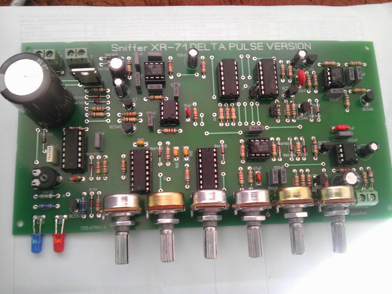

                      i would prefer to start from fresh again to behonest. or if someome can show me what needs replacing on the board, with what etc. here is a photo of the board when it was advertised for sale and a photo that i took of the board myself back when i borught it.

                          Hello keith777. I had problems with chips, diodes and transistors 546 and 557. some of them were fake. From 10 pieces LF357, ordered from China, worked 4 pieces. Assembled by me, the Turkish scheme does not like coils with low inductance.
                          To check the performance of the Board requires an oscilloscope, a multimeter with a frequency meter.
                          The DSO 138 oscilloscope from China is very cheap.
                            Just change all chips on the PCB. These are garden variety IC's. Altogether will be very cheap. You can find them everywhere. Even salvage from other old PCB. Then retouch soldering joints throughout the board where they look suspect, with soldering iron to make sure components properly soldered. Then check the transistors. Easy to test them in circuit without desoldering. This is easy fix. Or send board to me.
                              In your case, replacing chips is easy, just remove them from sockets. No problem.
