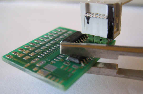

            Anyway to complete the pcb in the way, like Koala suggested, you will only need solder paste, a tweezers and simple head magnifier. My solder point is with 0,8 mm, not very small.
            The goal of any homemade detector, is in my opinion the fun to create your own stuff and of course to safe a lot of money.
            With a proofed design of course, it is much more simple.
            Also I think, SMT is faster than THT, you not need to turn your pcb so often. You can place all parts with the same value and solding them successively. Check all connections and place all parts with the next value...etc.

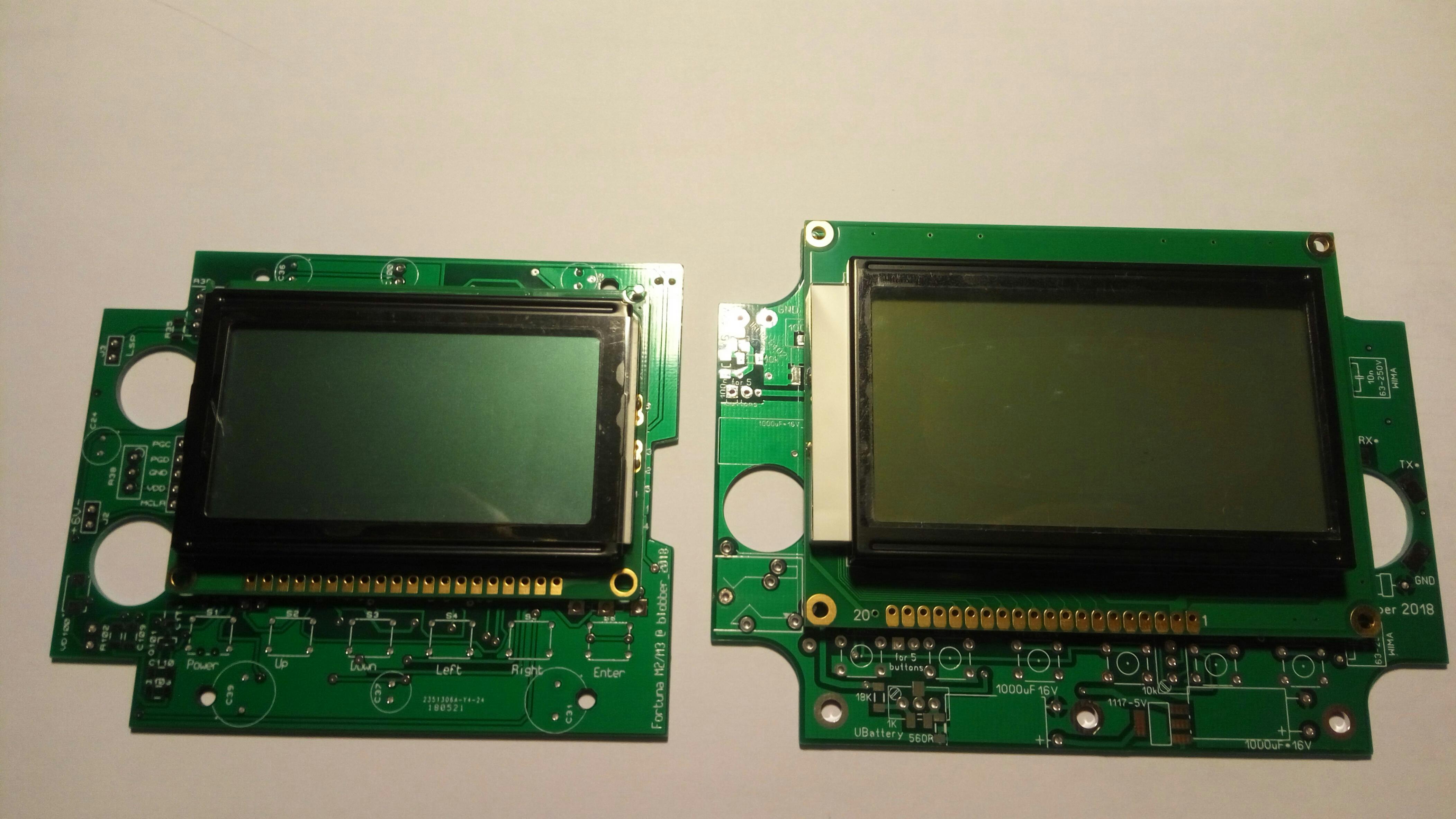

                              Some components and displays arrived, time to complete a few boards. But the weather is too nice, to stay at home.
