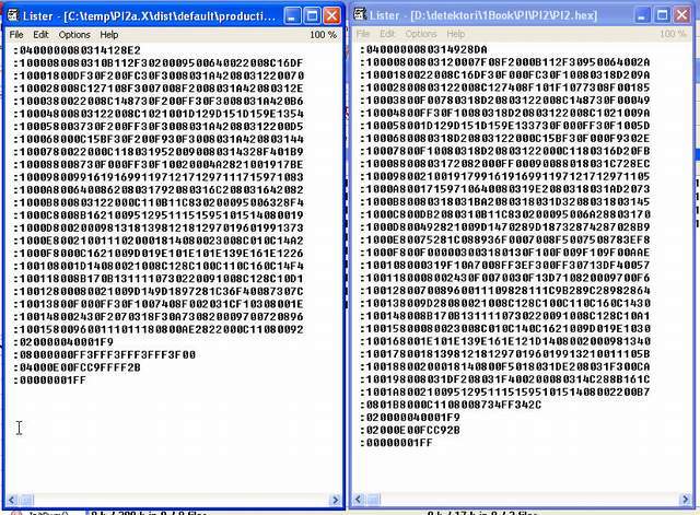

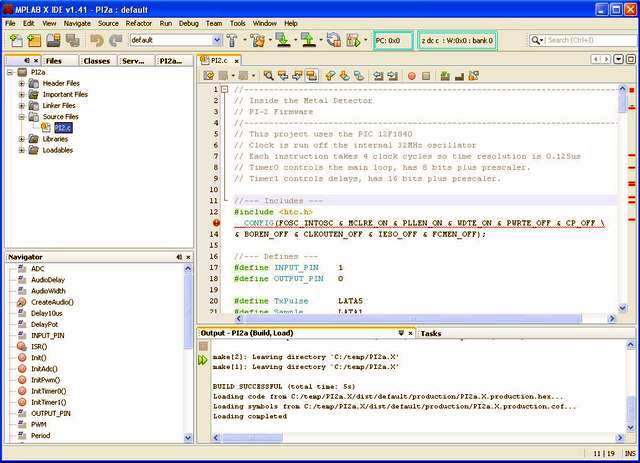

                    So, after downloading and installing MPLAB® X IDE v1.41 and MPLAB® XC8 Compiler v1.10 i tried again to compile the code.
                    It is complicated as much as it can be.
                    Yet, with a patience, trying this and that; finally i stumped through different adjustments and options and did something.
                    I did most simple way i could; open a new project, adjusted all necessary options i had to and hit "build"!
                    So it did!
                    No errors, no warnings!
                    Finally i got HEX file.
                    Comparing to Carl's HEX i got somewhat smaller file and right now i am not sure whether is about optimization or i made some mistake again.
                    I guess i will have to wait to obtain PIC, program it with one HEX, check, than program it with second HEX and check again.
                    If both HEX files works than difference in sizes is only because of the optimization methods.
                    Well... at least i got somewhere!

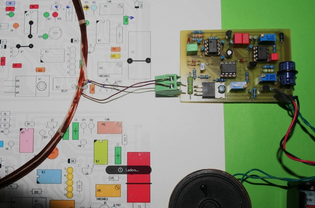

                            Last Saturday the 12F1840 arrived (thanksVoti’s fast shipment..) so today..testing’s day.
                            No problems with the hex file getting in the Microchip, used a Chinese Pic 3.. and MPLAB .
                            From the small pcb’s went 4 on a Euro card so it is really a small pcb.
                            First impression:
                            Sensitivity depends much on the connected coil , but for such a small circuit the sensitivity is not bad. For power I used 8 x 1.2 volt cells .. so total 9.6 volts.
                            The current the PI-2 take’s was much coildependent, variable from 80 mA – 130mA .
                            For Power FET I used the IRF9640 and for‘switching’ fet I used the BF245b (different pin layout)
                            The zip file has the Sprint Layout file etc. .... if someone finds errors or improvements.. let us know !
                            Best regards.
