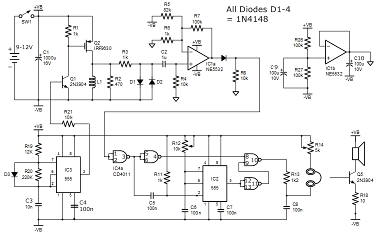

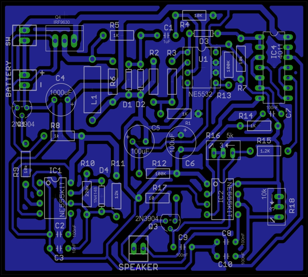

                    PI5 #4 - fried again
                    Can someone look this pcb over good and see if there are any mistakes. I used the new updated schematic from George.
                    Let me know what you think, it is not working and I cannot see what the problem is or figure out why. I have tried many times on this circuit.
                    Attached the schematic and new drawn pcb.

                      Did you check signal at pin3 of IC3 and then at collector of 2N3904?

                        will look this night for Errors, pcb looks clean so far
                        a short look on schematic and you will see that it would make sense to add an Option for a trimpot pulsewidth on the next improoved layout
                        IC3 NE555 but first it would be our Task to make this Basic Setup workable
                        last evening i etched pcb for baracuda and nes500
                        so my Equipment is still in range
                        could you upload gerber files of top and bottom layer i would adapdt this for sprint layout
                        btw wm6 is right
                        http://www.ecs.umass.edu/ece/m5/images/2N3904_pin_layout_S.jpg
                        and please name all parts on silkscreen like on schematic
                        connectors for Switch, power coil, headphones.. should be for clamping of rm5 (pinhole width)
                        irf9630 should have some more place for a heatsink
                        p.s. this 5minute timeout for wrinting sucks

                          Geotech,
                          Hmmm, I just compared your schematic with the one I got from George and there is one difference :
                          Pin 5 (CONT) of IC3 (555) is NOT connected in my schematic!
                          The capacitor numbering is also different in mine, C6 I have twice!!!??? But C values are the same as in your schematic.
                          From what I have read about the 555, pin 5 should be connected to GND with 10nF when not used.
                          GEORGE, what has happened here

                              • #45
                                Geotech,
                                The updated PI-5 schematic (sent to those that requested it) was created prior to ITMD Second Edition being released. The circuit posted by Geocash is from the book. Hence the slight differences.
                                If you're not using the control voltage input (pin 5) on a 555, you can add a small capacitor (usually 10nF to 100nF) to 0V to prevent intereference. I typically add the capacitor if the 555 is being used as a monostable, but it's not always necessary if being used in astable mode. Depends on the application. Here (in the TX oscillator) you don't need it, but you can add it if it makes you feel better.
