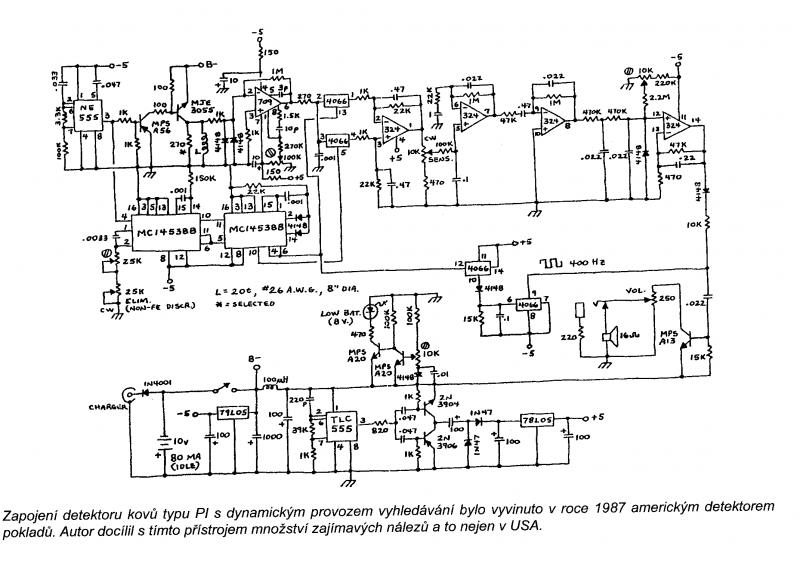

                  The purpose of my simple micro based hybrid project is to bring together a great number of PI ideas that I have been wanting to experiment with for some time.
                  If it works the PI requires a 4066 switch powered from +5 and -5 volts, and the 4 gates are switched with gnd (positive battery) and -5 volts.
                  This analogue system already seems to work in the XL500 as shown in the attachment
                  One of the many goals with this experiment is to use simple power supplies, hence my question to George about the virtual earth split supply in his PI2 project, to supply the +- 5 volts,
                  as I am concerned that the 4066 may load the split supply and unbalance it, and may not work.
                  Part of my circuit requires jfets to be replaced with the 4066, as correct jfet biasing creates problems for me, thats why I got excited when Ivconic got his Bara working with an Arduino.
                  I am still recovering from the flu and my concentration level is still almost zero, but I have done a few brief tests with the 4066 and it seems to switch leds ok, but will it switch and pass a PI preamp signal is the big question, as I am not sure just how hard the 4066 switch's on.
                  You can see the power and switching in the attachment.
                    What does and switch the 4066 with virtual ground and -5 volts mean?
                    Hi Green the attachment shows the 4538's switching the 4066 gates with ground (positive battery) and -5 volts
                    if I can get this to work with a simple split supply it would be very handy. But I may have to go back to using real regulators etc.
