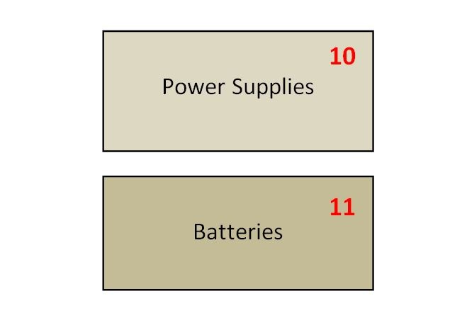

    PSU has 2 blocks; the supplies and the Batteries is made by the Pomer supplies on board , and the batteries.
    As I said in the post Design challenge, , it appears to be interresting to use a commercial Block cell like those used in handtools, like drills.

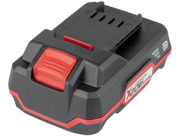

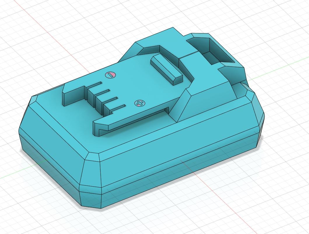

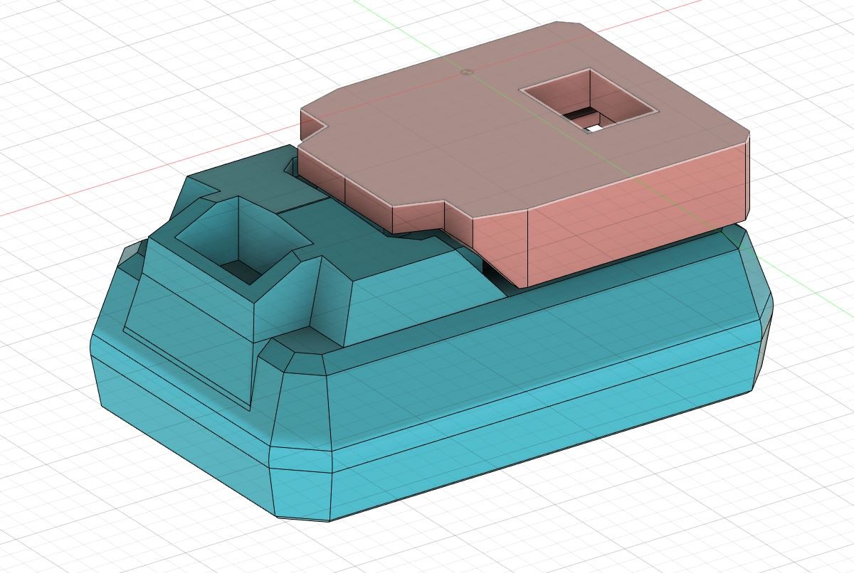

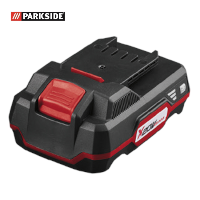

    This is a solution that will not suit a detector manufacturer, of course, but so practical for us amateurs I started a drawing around the PAP 20 battery which is 20V 2Ah, and there is also a 4Ah​
    The brand I think at is Powerfix, available in Most of the countries in Europe, , available on amazon, too, but more expensive.
    https://offers.kd2.org/fr/fr/lidl/pkZFW/
    https://grizzlytools.shop/Parkside-2...V-Family-Tools
    This concept can be also be adapted to brands available in others countries.
    I have made some drawings, not achieved at the moment. I have made trhe first 3D prints to check the fitting.

    Then, from 20v, many things are possible.
      Two Lipos 18650s, free of money, you can take them from any trash notebook batts. connect STEP UP converter and you get very stabile voltage 12V.
      you do NOT need especial board for charge, those "2S 3S 4S', "voltage balansir' board, etc.
      buy cheapest charger from ali.
        With 18650 you do not have the availability to change on the field. And the mechanical assembly need to be done, inside your box.
        You don't need to buy extra portable drill battery if you don't want. Obviously if you go on field with detector , you are not drilling at the same moment. So the drill battery can be used. In this case it is also for free.
        The battery box is already made, is reliable, and generally a power indicator is provided with it.
