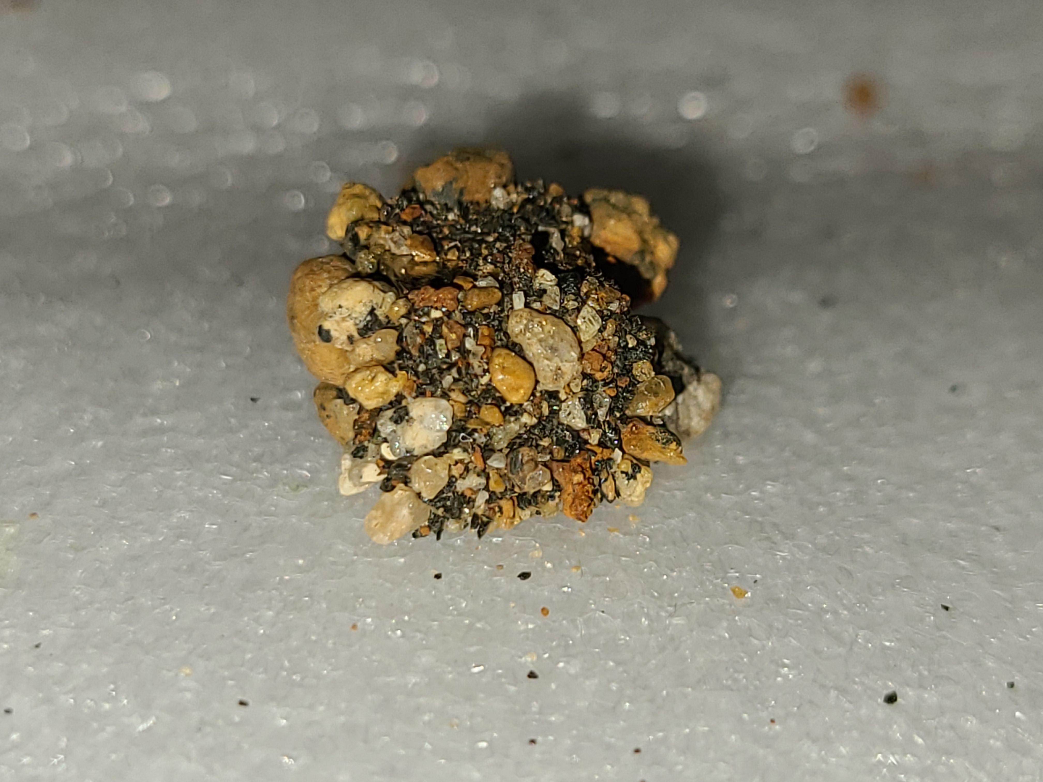

          Hi Green ,
          Now I see good old mother load red volcanic dirt clay just 3 hours away may not be the exact dirt but will get some soon.
          also see why its not east to separate it magnetically.
Name:	magnetic sand .jpg
          Looks like Tahoe sand though with all the magnetic rocks. In the picture even the granite pebbles are magnet to some extent .
          My ground balance on a bi polar machine cannot handle this ground with the stock coil no matter how slow I sweep it see's too much change in the ground and too much soil volume within any 6 inches to stay balanced.
          A smaller mono coil is capable of hunting the ground but at a very slow swing.
          Magnetite is not supposed to effect a PI and funny that holds true but not in Gb mode on this machine I still have to run down there after a windy night with the Tdi and see if It suffers the same fate.

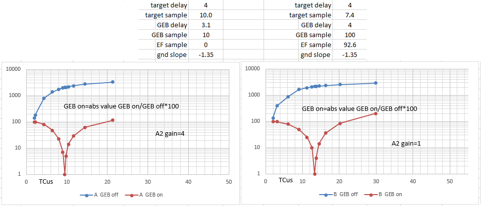

              Tried what I thing would be comparing a MPP vs a 1C integrator in Excel. First delay 4us for small nuggets. Hole is lower for MPP. Would expect MPP noise to be 4times higher with GB enabled. Peak noise is about 3times higher when I enable GB on my detector, so maybe a little less noise with a higher TC hole. Can attach excel program if anyone wants. Have in the past but might have made some changes.
