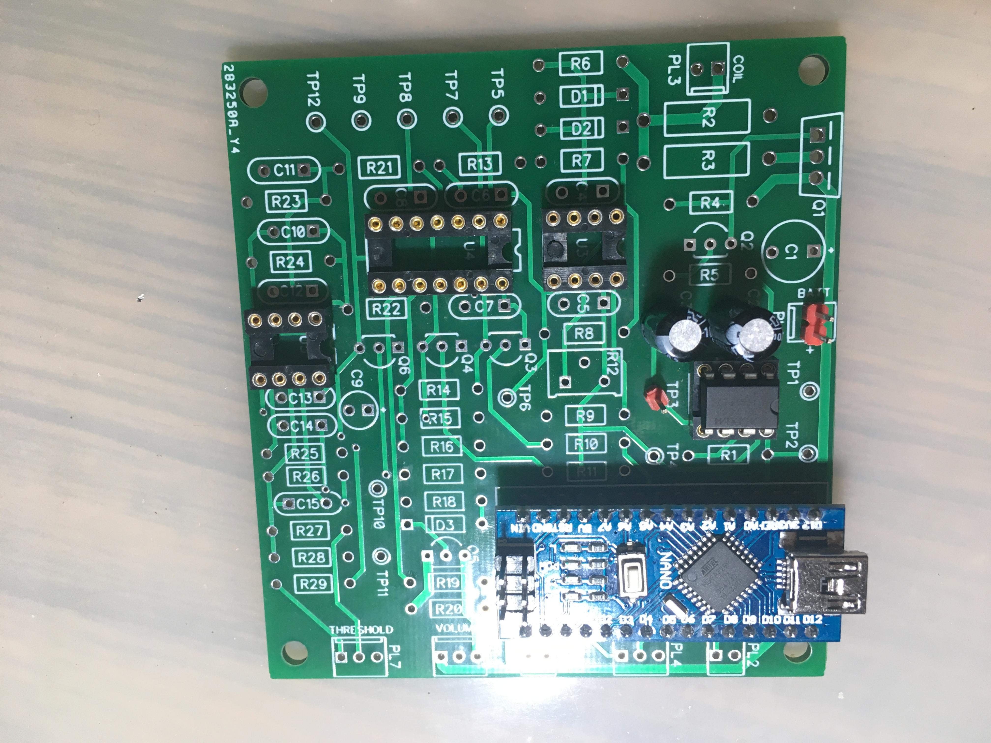

    Qiaozhi,Thanks for your information.
    I used ultimate solustion, I'll open a new PCB make it and add components step by step.
    Now,I can get -5v on TP3(ICL7662), I hope that goes well.

          • Originally posted by lc516 View Post
            [ATTACH]54941[/ATTACH]
            continue:
            1 I add R1, ok,it's working well, TP3 get -5V.
            2 add U3(NE5534P), TP3 get -3.8V
            3 Replace with another NE5534P of a different brand, TP3 get -0.6V
            I continued to add some components R7 r8 r9 r12, It was no change.
            I was upset about the problem....
            continue:
            test the current of pin5 on 7660, it's 2.8mA.

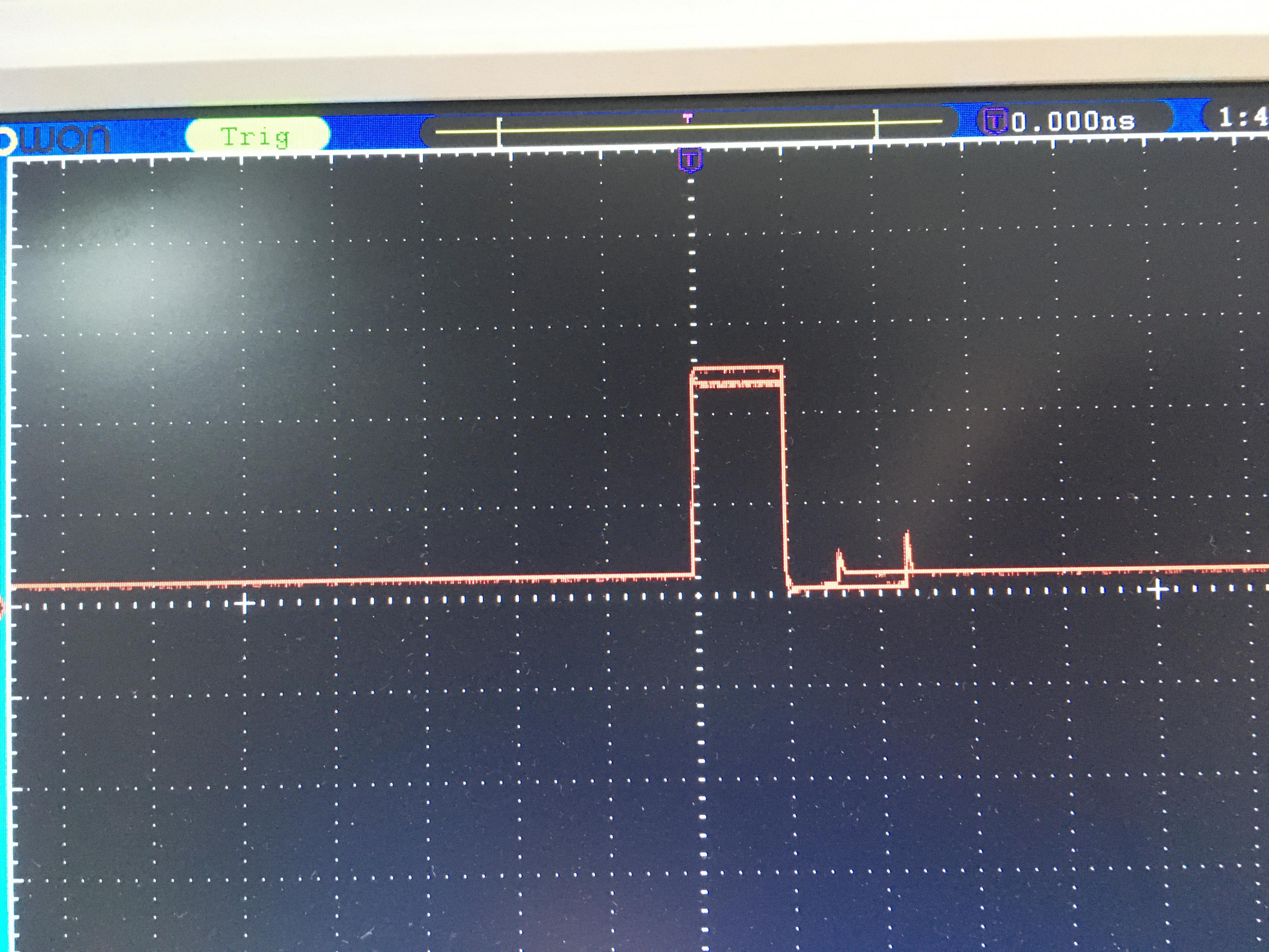

                            I got a good voltage -4.9V on TP3 after I use the new ICL7660S.
                            I use oscilloscope to check the ICL7660S PIN7, It's have a normal waveform.
                            before, I got deform waveform on ICL7662 pin7, as picture
                              [ATTACH]54949[/ATTACH]
                              That's good news.
                              Hope you receive the book soon.
