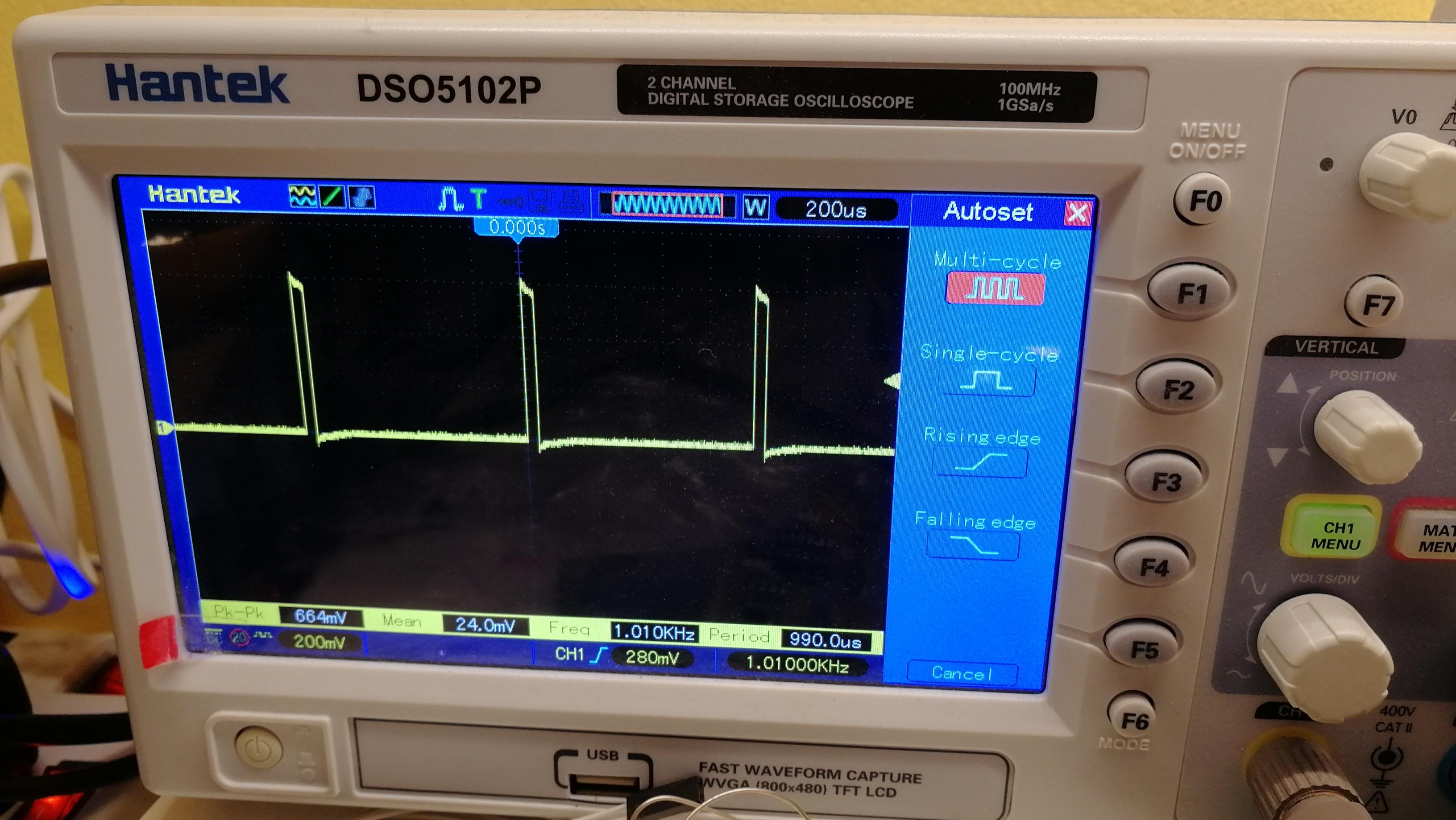

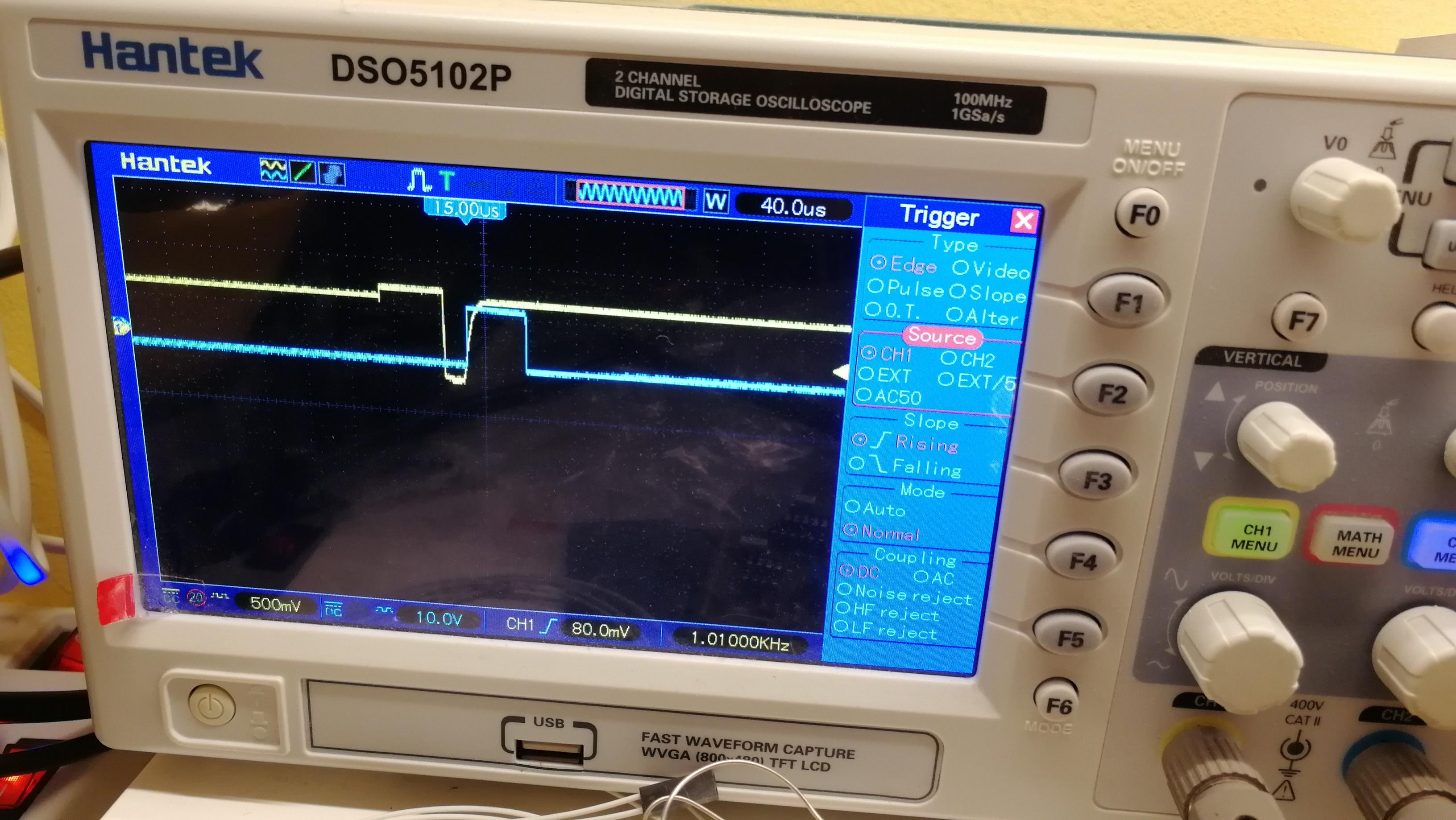

                  • Build mine ready, within one day.
                    Was very easy, all settings checked with oscope.
                    Big THX to George for Support
                    If anyone is interested in scope pictures i can upload them
                    https://youtu.be/Z2XFnPe3u58
                    • Some samples:
ID:	359552Click image for larger version
