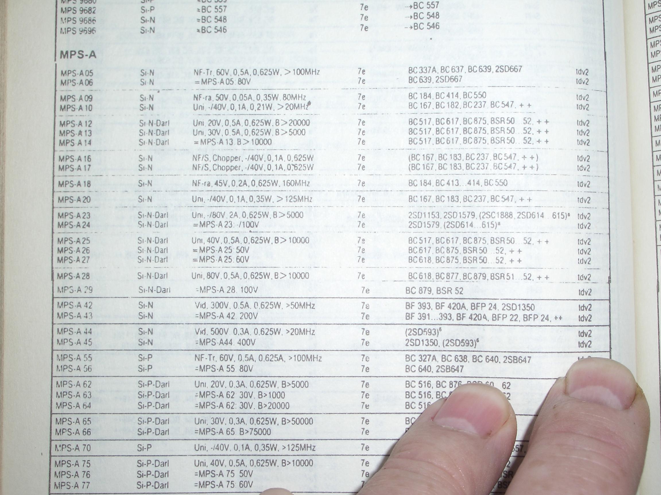

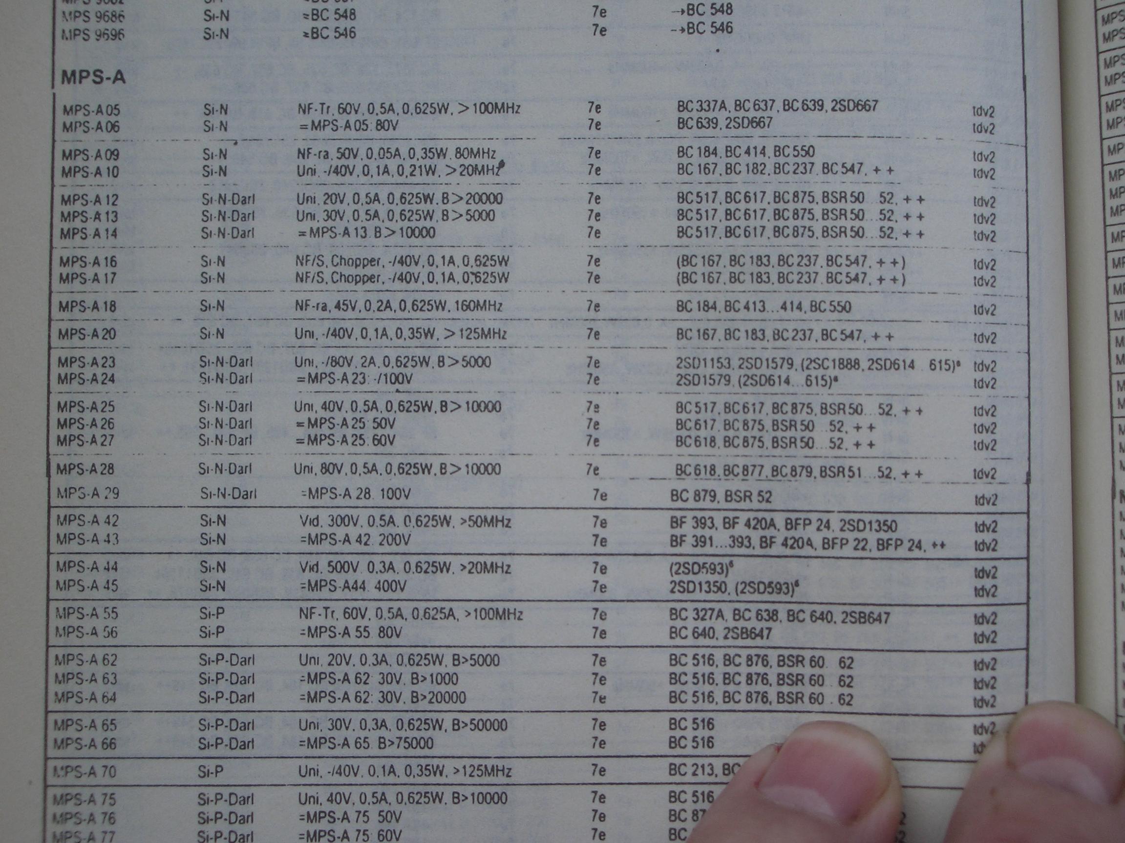

  • Thank you Marty, unfortunately none of these are available except the bc517 so I will give it a try. For the power up I wanted to see what you guys experimented and if someone tried one of those portable usb powerbanks to power up a PI metal detector.
    • reference table, look on right side of it
