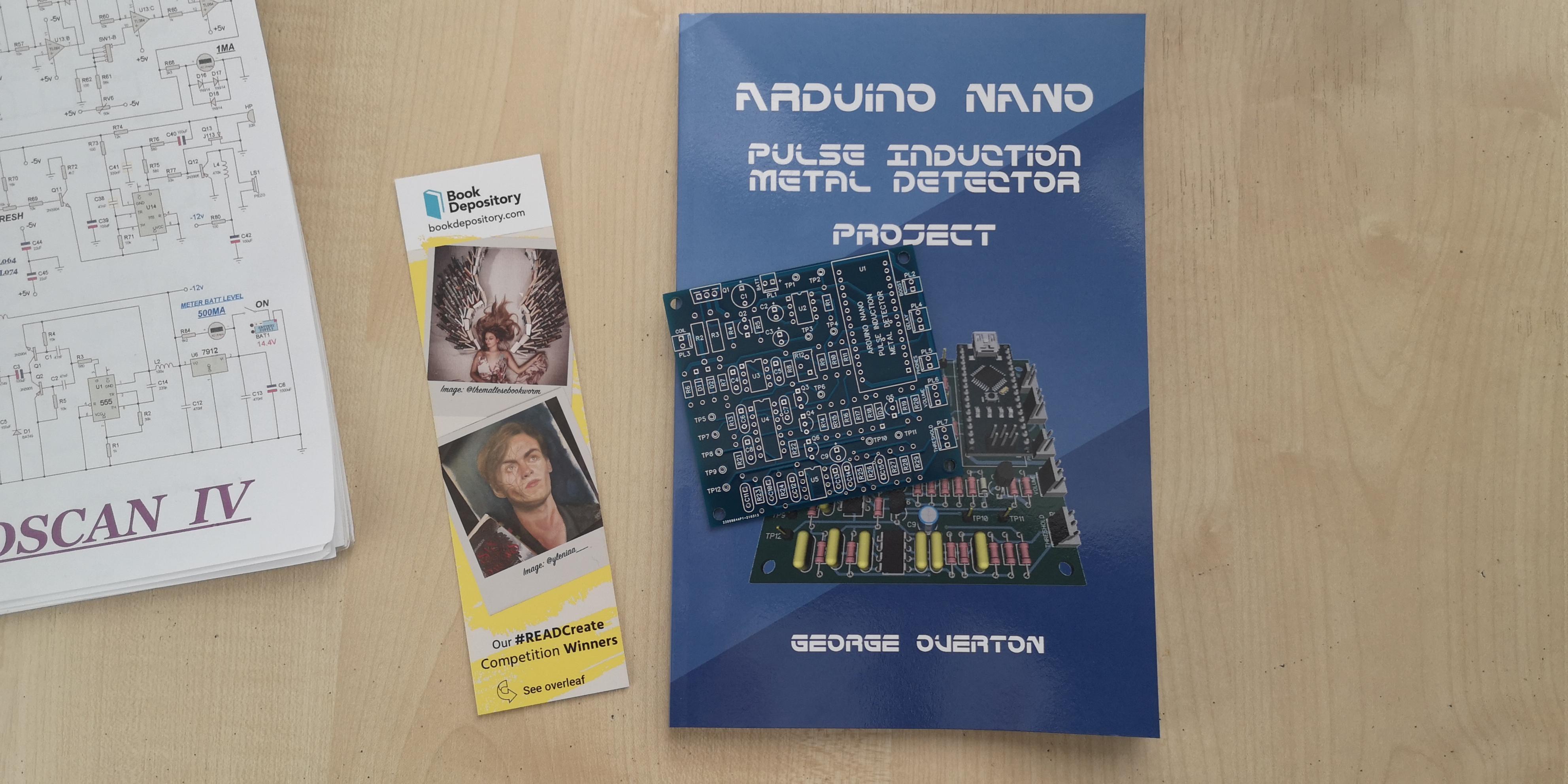

                          • Hello. Finally, the book and boards arrived. About the book, everything is very intelligible, and my opinion is that even an elementary school student will assemble this detector without any problems. One question, target detection is for a 9" coil...? It remains to wait for the arduino.

                            • Originally posted by Myntmaster View Post
                              [ATTACH]56869[/ATTACH]
                              The coil diameter is given on page 28 ( Step 8 ) as being wound on a 9" former, so that's the inner diameter. The outer diameter measurement is actually 25cm (10")..

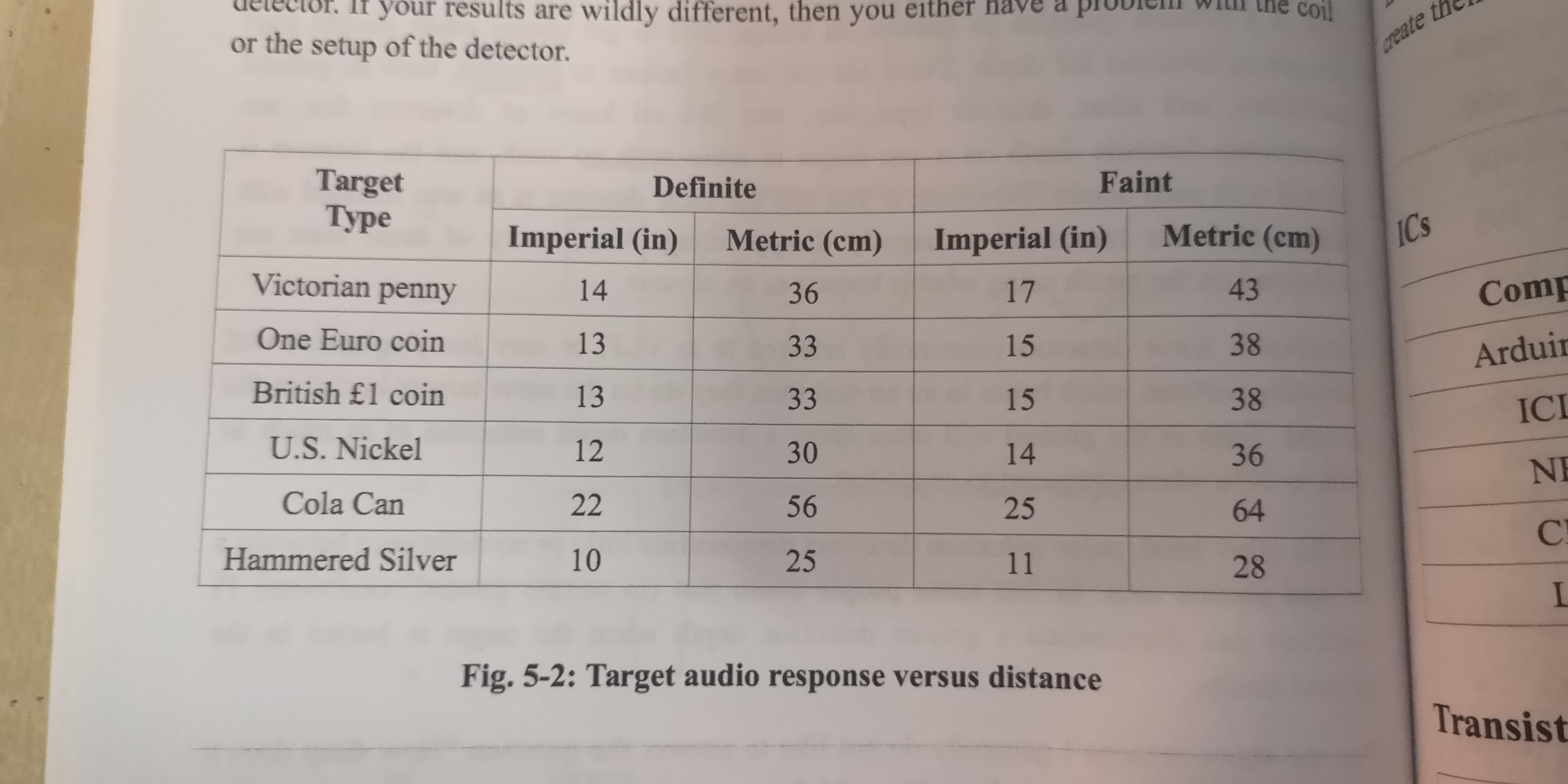

                              • I understand everything about the coil. The detection range in this photo ..Click image for larger version
ID:	362601. is this for a 10" coil.?
