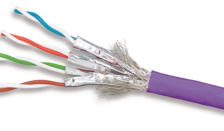

                              • ethernet cat7
                                Hi all
                                I would like to constract a frame coil of 1,20m X 1,20m, for my ANPI. Do you think that an ethernet cable CAT7 would do the job? Any other sugested type of cable for this job?
