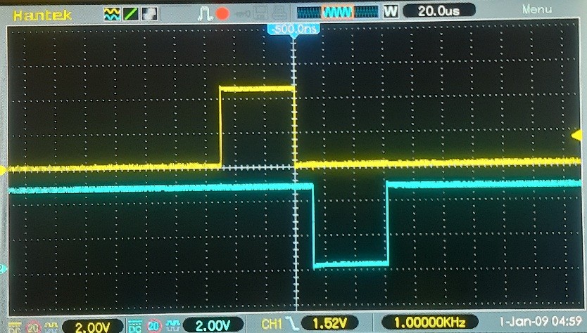

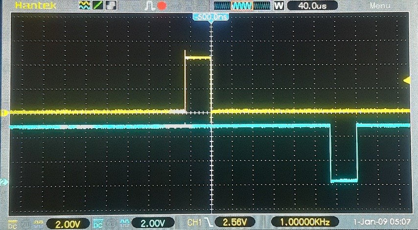

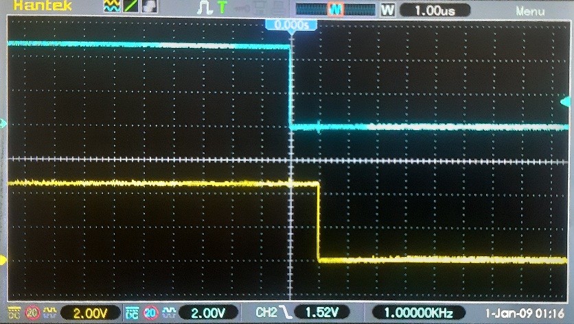

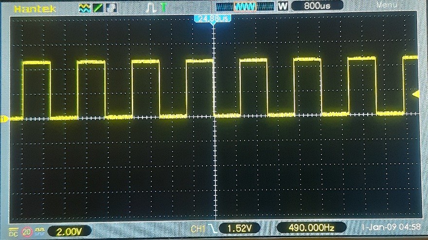

                    These are the signals I get on my setup, including sound. They match the original sketch exactly. Audio 490 Hz, period 1000ms, delay 10us, etc.
                    Using this sketch Arduino_PI2.0.1.zip
                    Tx pulse and mainSample:
                    Click image for larger version  Name:	20240209_220325.jpg Views:	0 Size:	150.8 KB ID:	420094
                    Tx pulse and efeSample
                    Click image for larger version  Name:	20240209_220252.jpg Views:	0 Size:	158.5 KB ID:	420095
                    Sound on pin 11.
                    Click image for larger version  Name:	20240209_220354.jpg Views:	0 Size:	170.4 KB ID:	420096
                    I'm mystified about the whistle cause I haven't touched the sound.
                      Why is mainsample and efeSample inverted? They should be the same polarity as Tx Pulse.
                        Here is the code. You will need to swap the pins back of course.
                          Well, no.
                          Look at the schematic and see NPN transistors Q3 and Q4 and guess the polarity of the base signal to turn them on.
                          Also look at the original code:
                          PHP Code:
                          digitalWrite(mainSamplePinsyncDemodOn); // Turn on main sample gate
                          digitalWrite(mainSamplePinsyncDemodOff); // Turn off main sample gate
                          And what are the values of syncDemodOn and syncDemodOff?
                          PHP Code:
                          const byte syncDemodOn LOW// Sample gate turns on when input high
                          const byte syncDemodOff HIGH// Sample gate turns off when input low
                          So that is not the issue.​

                                My scope images correspond to pins 8 and 10, not to TP5 and TP8 (which are inverted by Q3 and Q4).
                                So the scope refers to the polarities at the base of the transistors, not at their collectors.
                                So don't take offence because there was a misunderstanding, we were looking at different nodes.
                                I haven't changed the polarity in the code, so it won't change in the PCB either.
                                For future reference: I will always talk about the signals at the pins of tne Arduino Nano.
