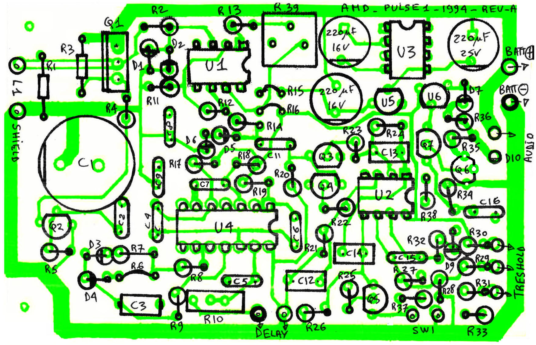

            Im not able to send email to alexis but i got the pcb size..it is 97mm x 66mm.

                thanks for answer,
                i have file in sprintlayout with silkscreen (partnumber and Value)
                it is possible to Export from srint to gerber so if you have not so much time i can send you the exported file
                if you do a new layout- so work on
                one thing i would do is to place pcb Connection terminals for Audio, power, coil
                it is easier for final Installation
                and all trimpots to one side that i could be direct soldered on pcb (16mm pots) i dont like to wire pots
                  what is with seedstudio, ditypcb and the other cheap chines pcb manufacturers did you try them?
                    and all above are in Shenzhen, China. thinking this is one fabric but with another distributors )

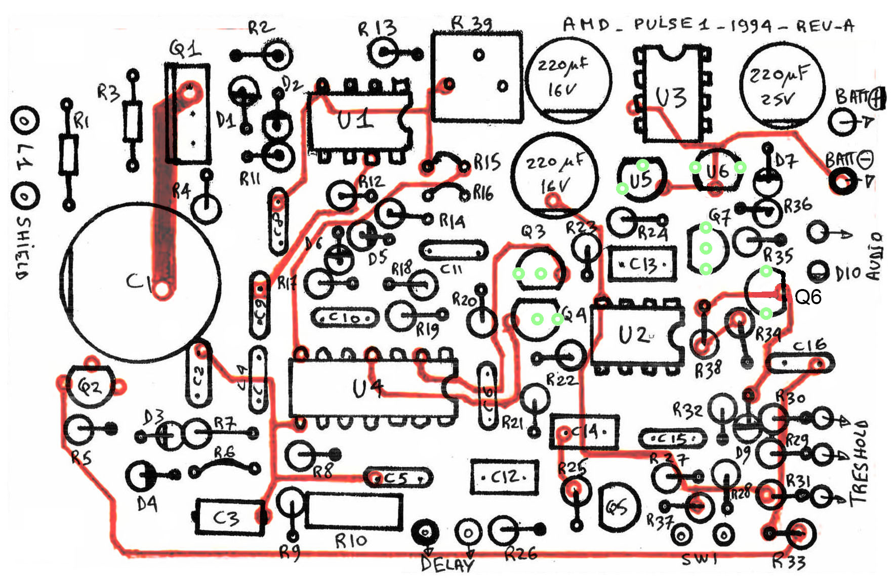

                      did some mix with correction at board top pic. Click image for larger version

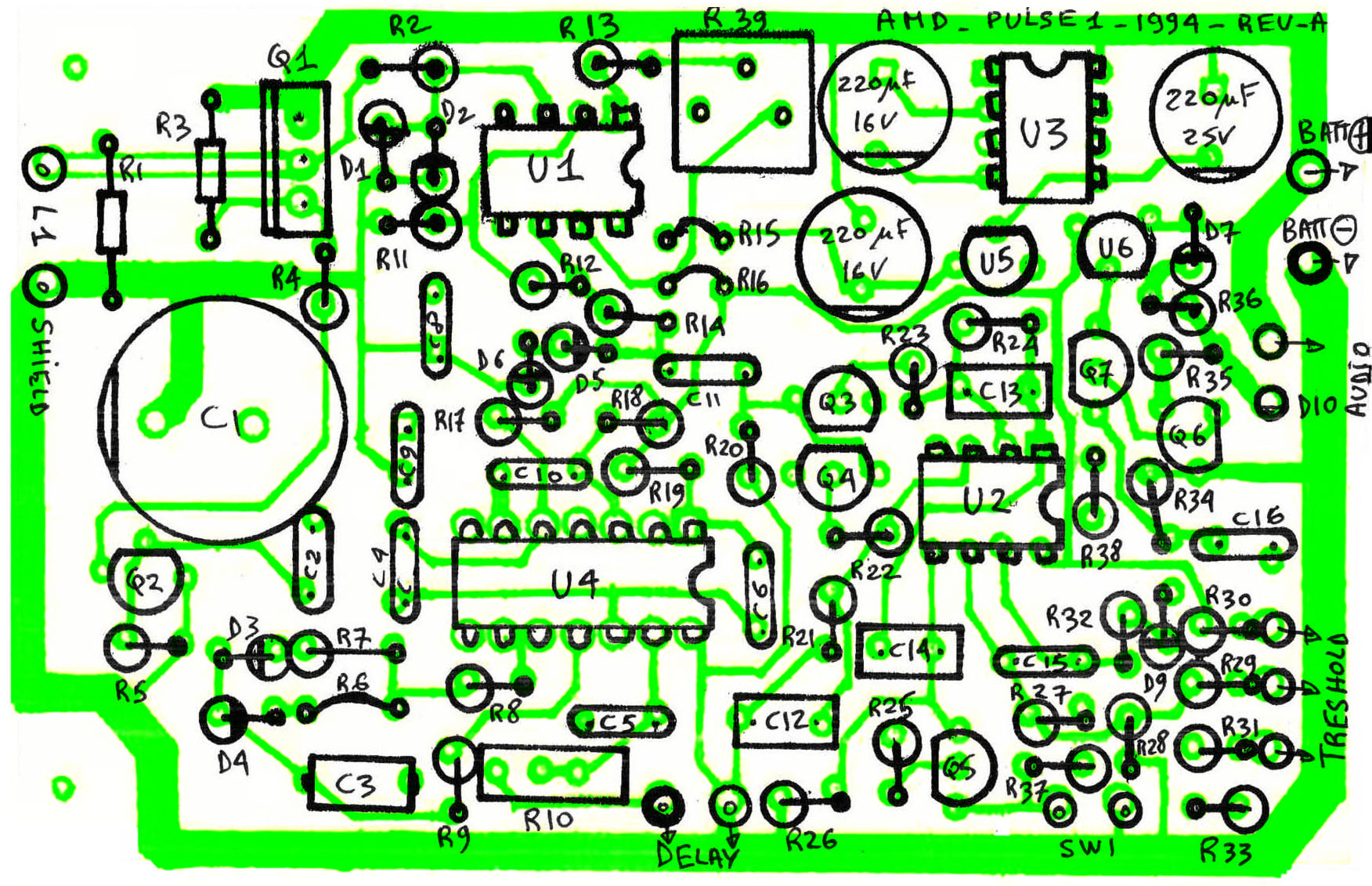

                        bottom side Click image for larger version
                          the drawing seems to beo from 1994, so i can say that the actual pcb from apberg and papa alex seems to be close to the original
                            bottom side corrected
                              check
