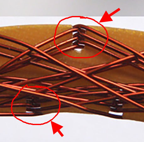

best coil for baracuda?

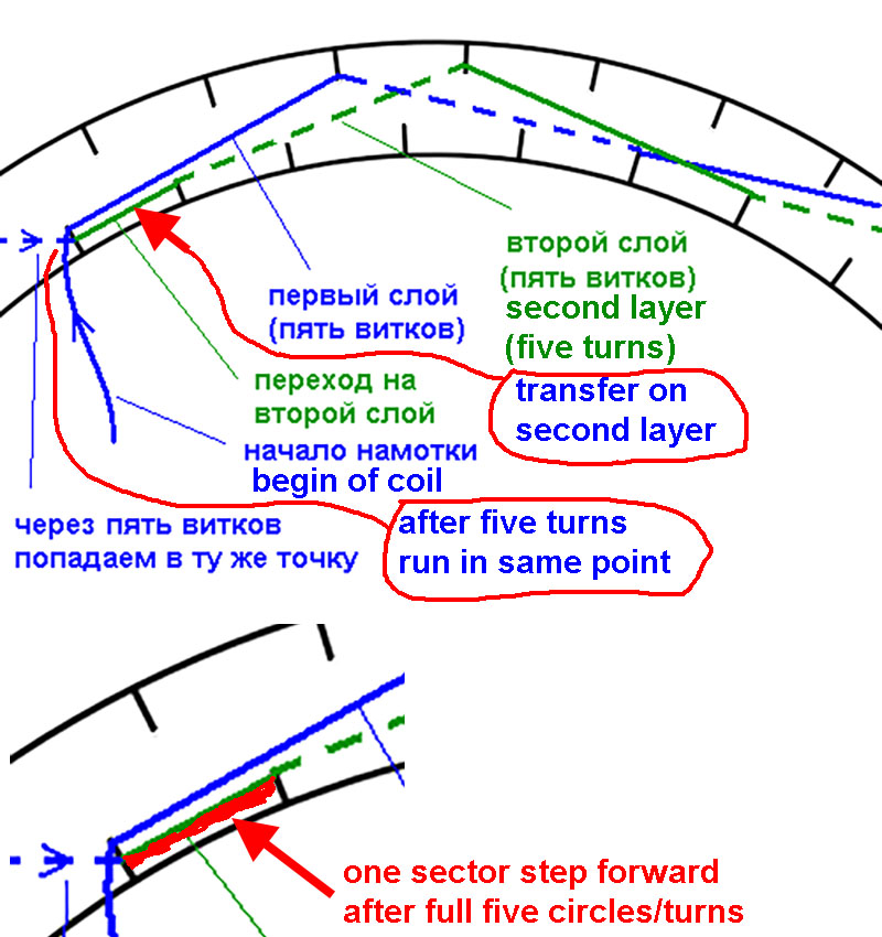

    http://storage2.static.itmages.ru/i/16/1220/h_1482228505_8783862_71d714ba1f.jpg
        transfer on another layer after 5 turns
          right pattern

                Working on one right now. Think I have the handle on it this time. Windings are coming out looking correct. One over the other.
                Posted on: December 20, 2016, 09:53:07 pm
                Basically you start winding.
                If the wire is coming from the bottom.
                Run wire to the third slot available on top.
                Do the same with wire coming from top.
                Run wire to the third slot available on bottom.
                Continue this until you have wire ran to ALL Slots. Five Rotations.
                Winding the Five will put you at your starting point.
                From the Starting Point Do Not Go Up or Down. Just Run wire to the next Slot.
                From this slot continue for another Five Rotations until you have all slots with equal wire in them .
                After each five rotations you need to adjust one slot forward or one back.

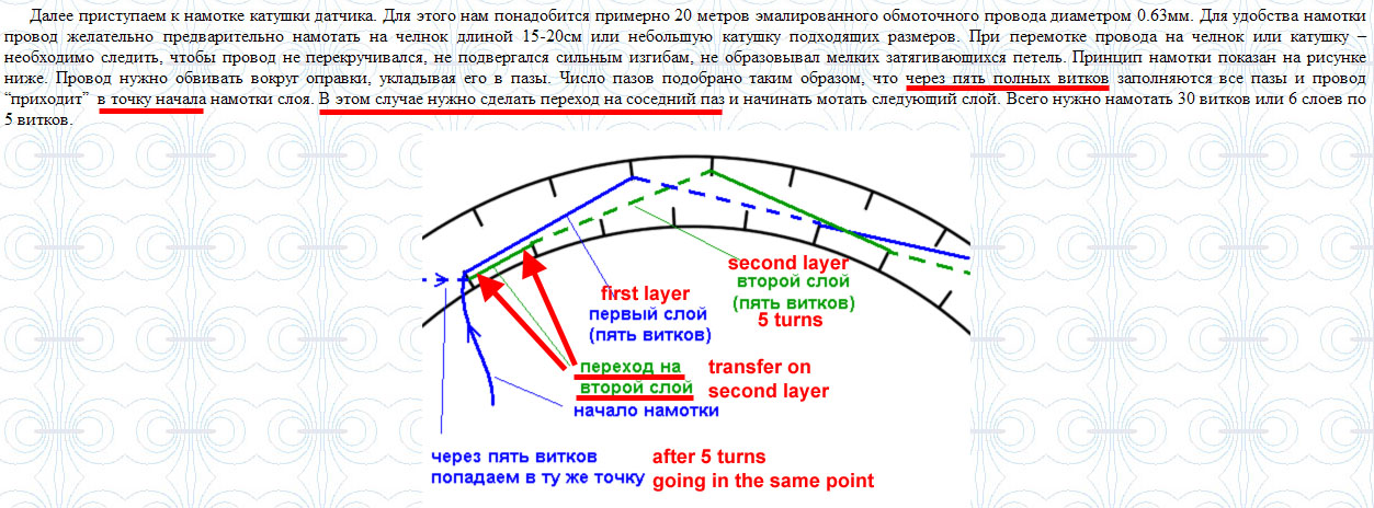

                      look here:
                        Originally posted by Toros View Post
                        look here:
                        Attached pdf file.

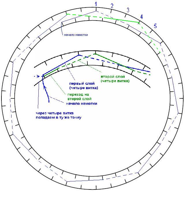

Name:	basket coil transfer.jpg
