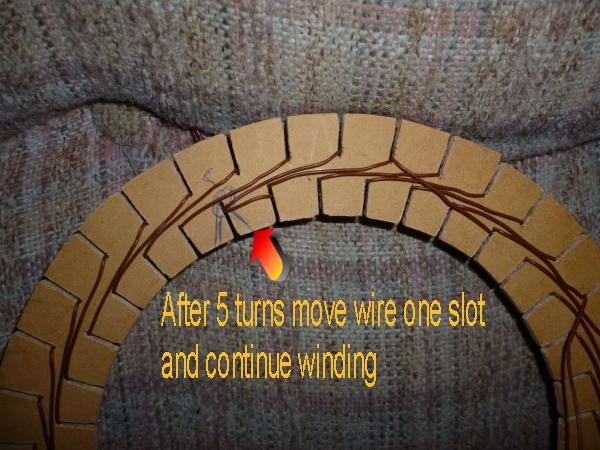

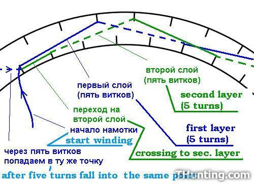

                Now here is the trick to making this coil, after 5 turns the wire will fill the same slot from where you started, move the wire one slot and continue winding another 5 turns and then move the wire one slot and continue , you should not have any parallel wires, and the wire should stack up in the slots.
                When completed 33 turns gave me 320uH.

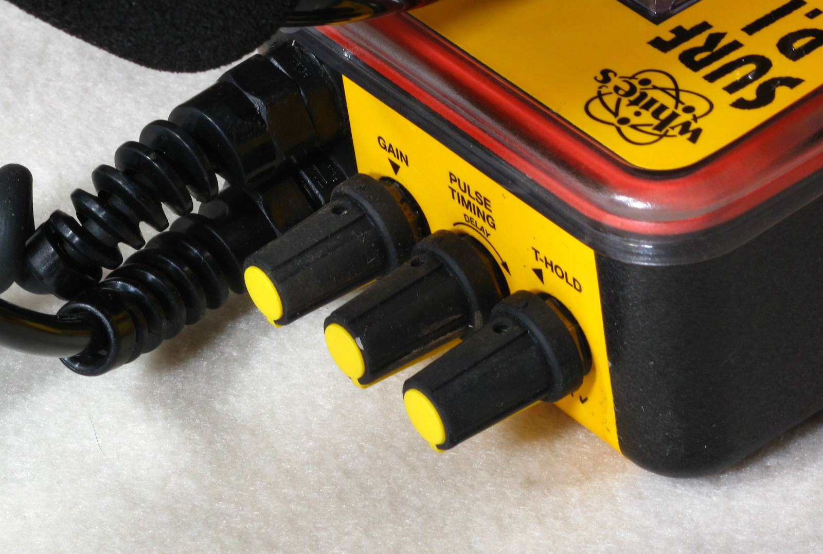

                  how to mod ordinary socket to waterproof
                    kt315, will this work on multi-turn potentiometers?
                      yes, but for what? they are expensive. do you have waterproof multi-turn potentiometers?

                        No, was just wondering if it was possible to waterproof ordinary potentiometers which can be picked up for a couple of bucks. Whilst the sealed, waterproof pots run upwards of $15 bucks each. This would be for beach and wading only.
                        • #42
                          yup i would like to know how and what pots whites uses in surf pi, but no pics.
                          Joe on dec 10 replied me
                          Hi Kt, hope u can make some sense of this. If you need other pics will have to wait til after new year when I can get back to it. Thanks for looking and taking time. Joe

                            • #44
                              For wading you dont need "water proof" pots if you build the housing correctly, build your electronics into a pvc tube with a water tight screw end, allows you to put coil into the water then make your pot adjustments, put cap on and away you go, yes it does require you to remove cap for further adjustments.
