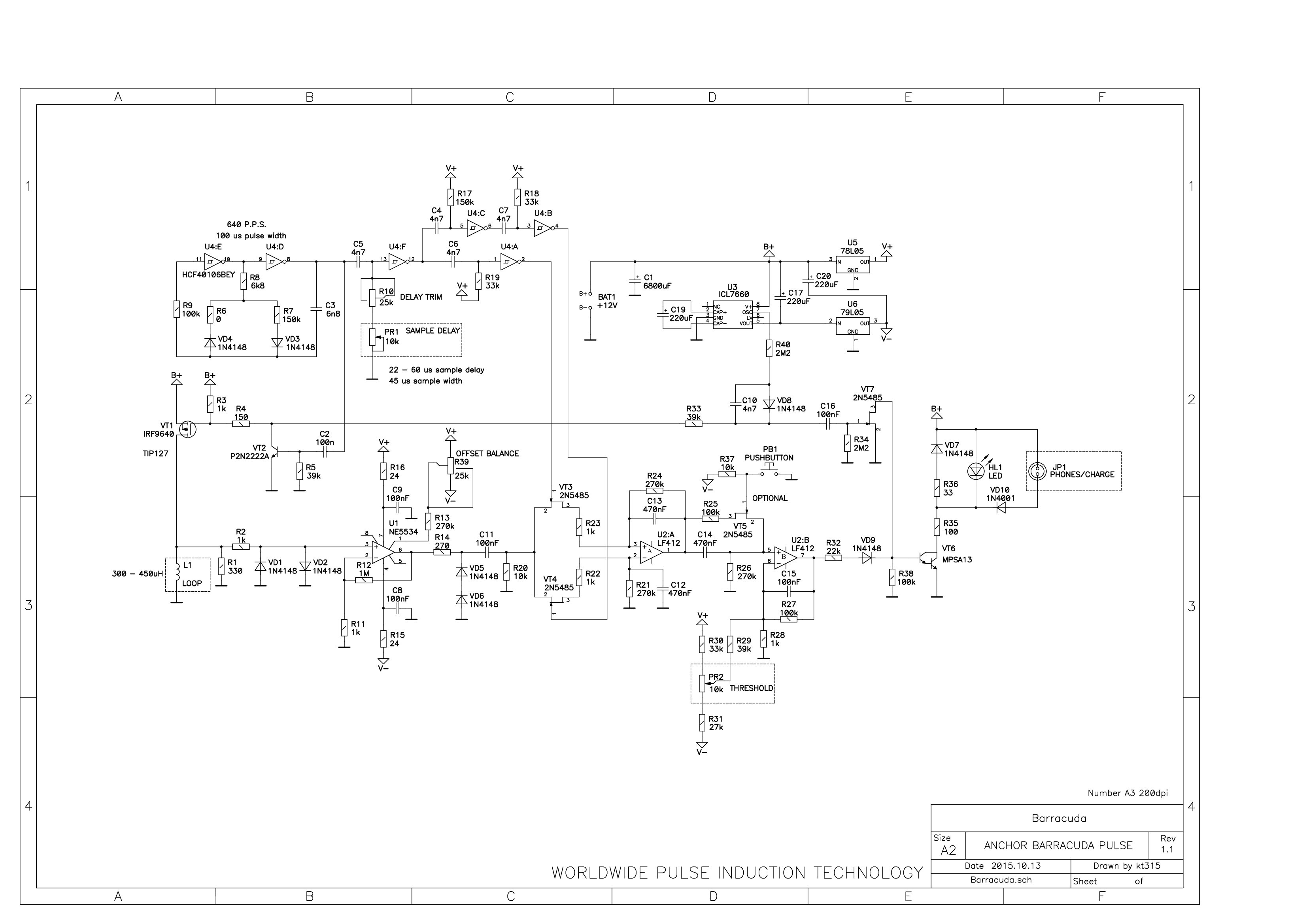

Baracuda Schematic
Originally posted by Guzzi View PostI have a question about the NE5534 schematic. The pcb layout from Apberg differs from the schematics, which is the right one?

i think this could be misunderstood
the most project published here, are fully free and have good documention
remind that most here hobby electronics, so some infos are not the best but we are here to improove thinks and our own skills
so i a project have some little errors it is at your own to ask internet
most shemes of power regulator or timers are same equal you have a audio amp or a metal detector
my biggest failure in past was to dont read datasheets but you should
70percent of my diy detectors run at first set up
20percent later after i have corrected my own failures
and 10percent never because of early stage of try and error
but i often do new projects which are not 100% tested thats my own risk
go to the Archive http://www.geotech1.com/forums/archi...x.php/f-8.html
open fisrt point there. and you ll see your question for 2002 year. 2002 YEAR! the bara schematic has 2015-2002 = 13 years OLD.

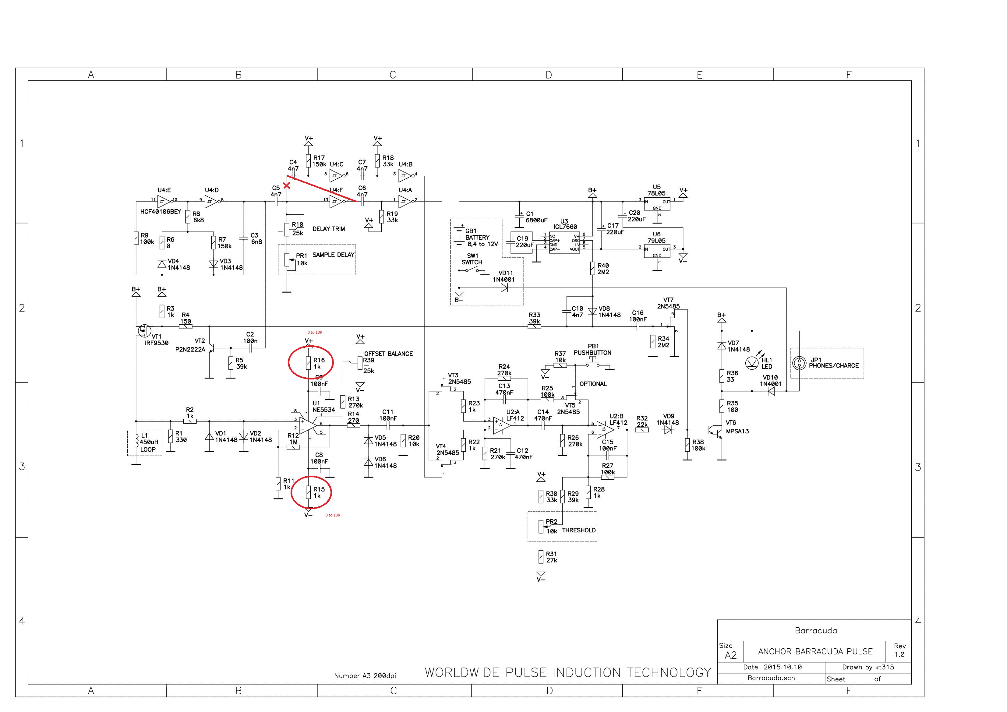

schematics and laughs when someone tries to use it. Sorry for publishing it here I didn't look closely at it before linking it...
i got best results with tip127
baracuda has ability to pseudo discrimination if you turn delay down and threshold up you loose depth but it can detect an euro coin earlier the a iron bolt
also on the shematic sheet should be a list/ table of replacement components (mpf102 - bc256) or for 2n3819 ....
http://www.guitar-letter.de/Knowledg...eichsliste.htm
coil can also be smaller than 450µH, surf pi coil work also ok
