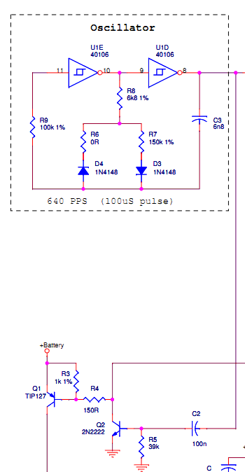

    Hey guys i joined a few days ago with the hope that i could sort my issue without raising the typical beginner post by reading others issues and checking out my board but i have not been successful yet. I bought a Barracuda Legend Kit and have put the components on the board as per the numbers i have made sure the 2222 (metal can type) is in the correct orientation i have taken it off the board to check that it isnt in short with one of the other pins (its not). I have set 5534 pin no 6 to 0v. i have a whine/tone when i plug the batt in (12v) and the tone gets louder if i turn the pot up which is what i would expect but when i put the coil on the Mosfet goes mental and over heats in 3 seconds i have cleaned and cleaned again to get rid of any rosin flux shorts. I am stumped as this is where my skill runs out, is there any good folk that would be willing to help me?

          Well the hot FET indicates it is on for too long. You need to check these components;
          Remove the coil to save the FET if you turn it on. An oscope would make things a little easier.

              Exactly the problem I had with a problem 2222 (I had order the right part but an equivalent had been sent. I did not check and fitted 180 degrees out)
              If you are using a TIP127 if you detector starts to work at lower volts I would suspect the 2222 or surrounding components.
                Describe your coil, diameter, wire size, number of turns
                A common mistake is making a coil of far too high inductance/resistance

                      hey guys my coil is 10" Dia 20 turns magnet wire 0.5mm 1.7 ohms, covered in foil for a temp shield, when i turn on the power i do not get a beep i only get the hum if i turn the pot up to much (good?) and i can wave a large spoon ( first thing to hand ) and if i play with the pots i can get a slight pick up tone but anything smaller and it will not pick it up. i have ordered another kit and will try again its like the bottem w203 pot does not work as it should ?
