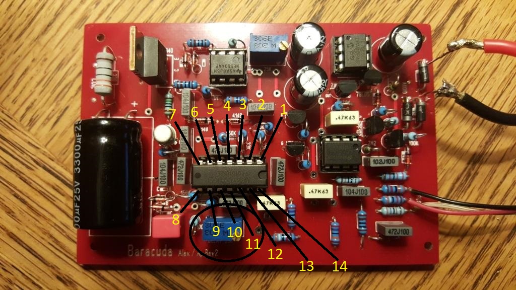

  • o and i have labled this picture so we are clear as this is what the data sheet says
    here Click image for larger version

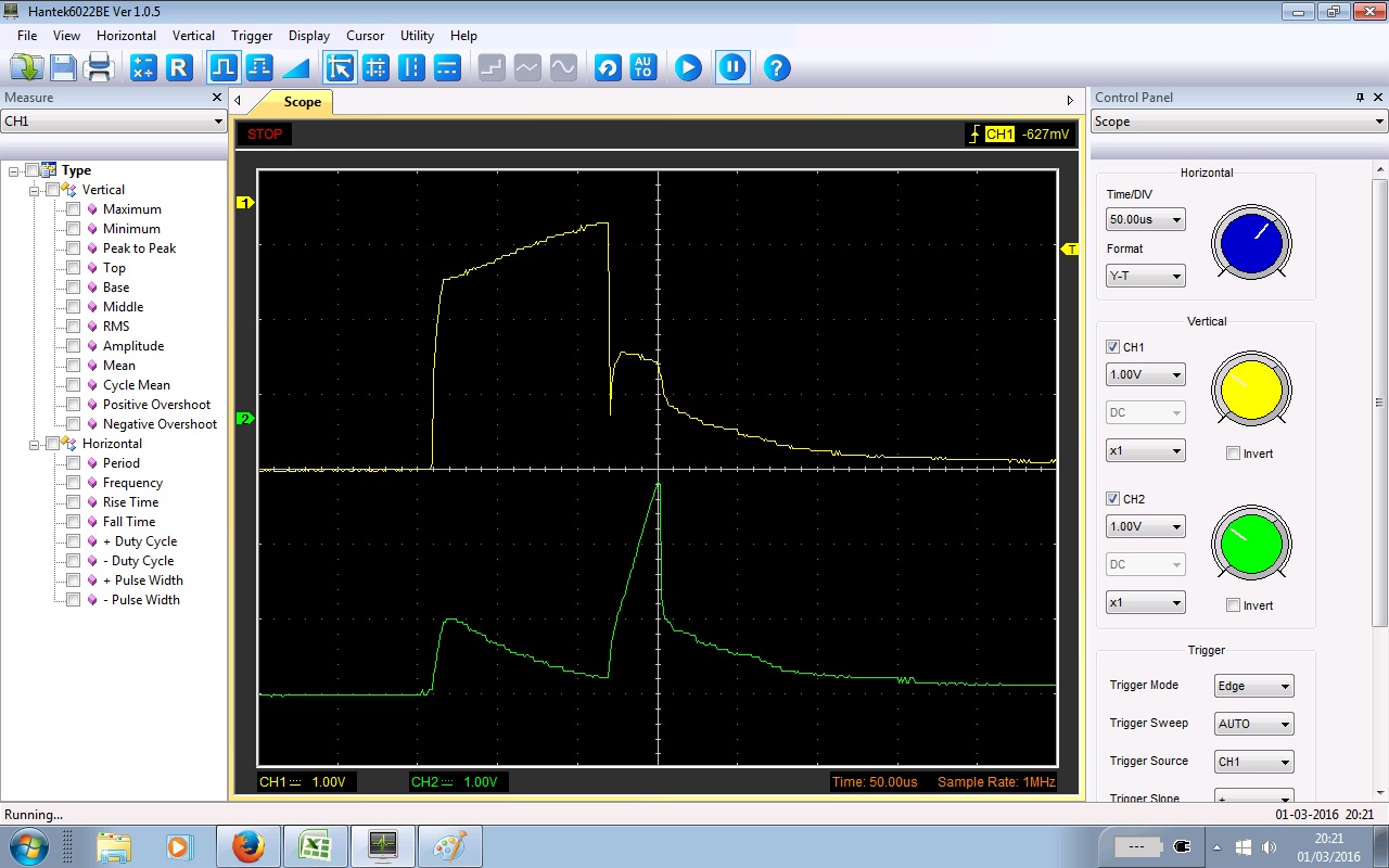

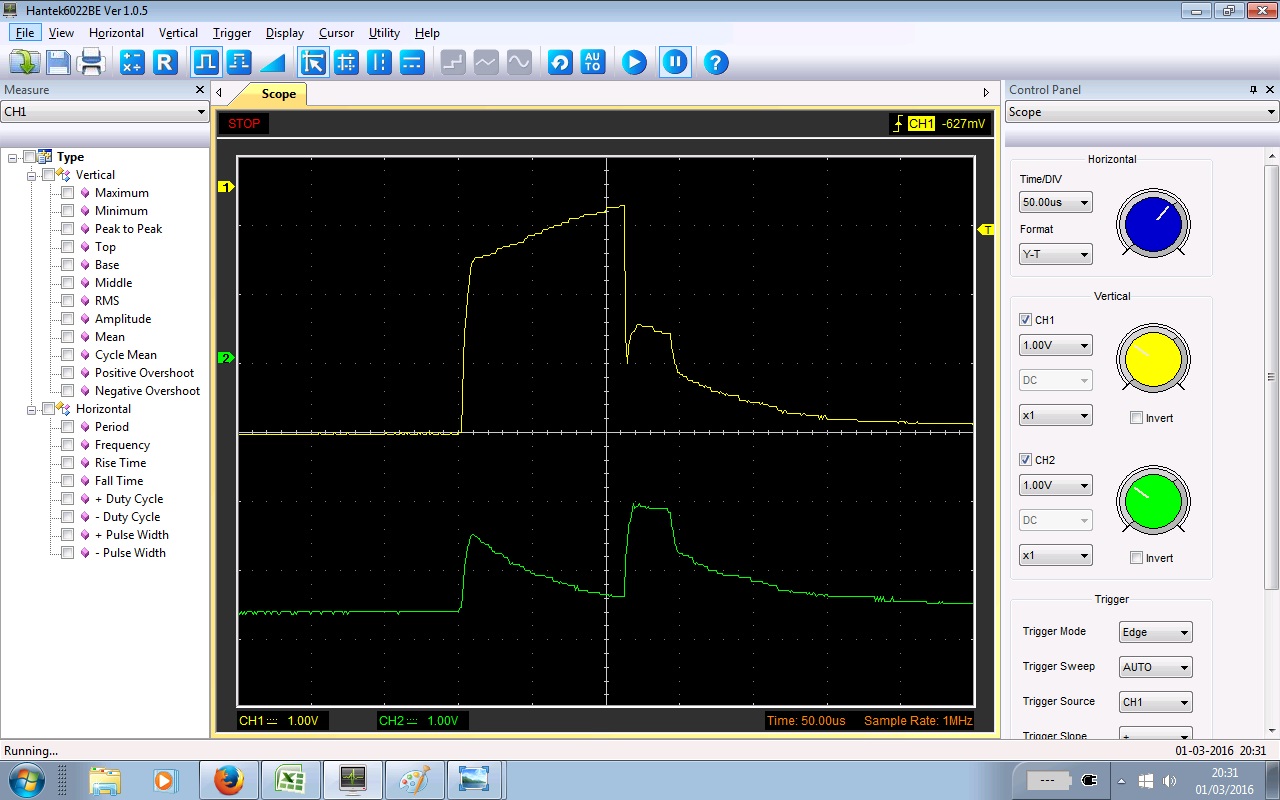

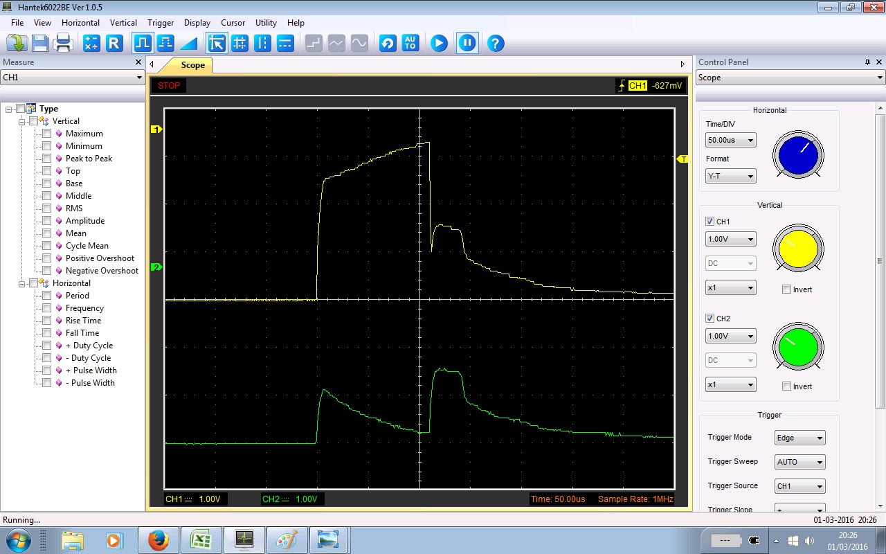

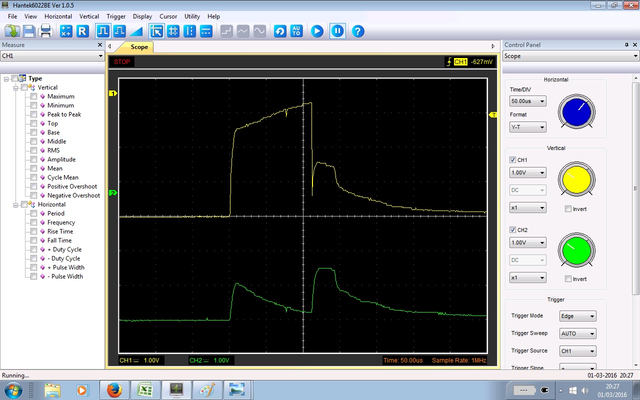

    • heres the data for 40106 pin 8 - 12,2,6,4 the delay trim is set at 12.5 ohms
      here
Name:	CH1 pin8 40106 CH2 40106 pin12.jpg
Name:	CH1 pin8 40106 CH2 40106 pin2.jpg
Name:	CH1 pin8 40106 CH2 40106 pin6.jpg
Name:	CH1 pin8 40106 CH2 40106 pin4.jpg

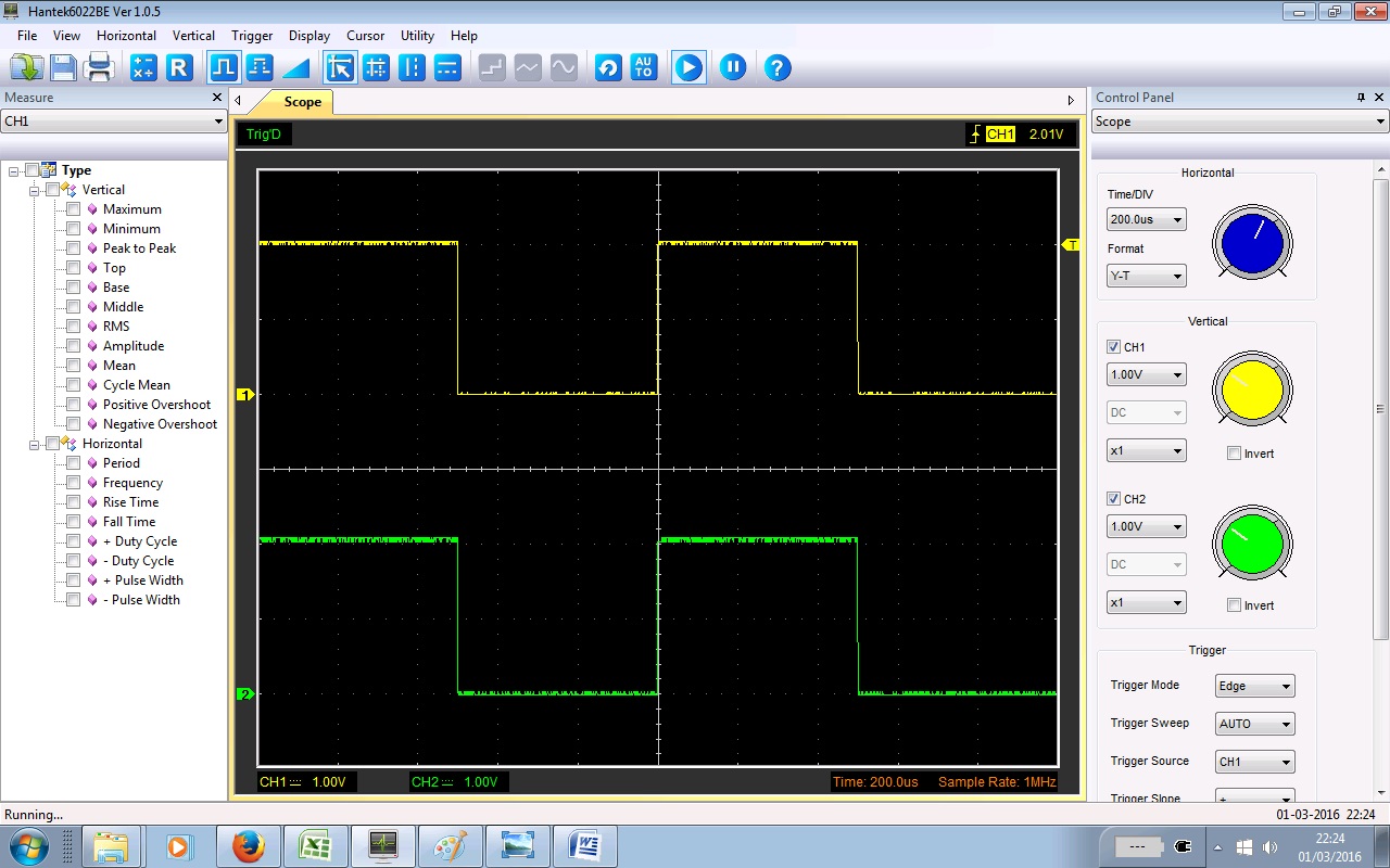

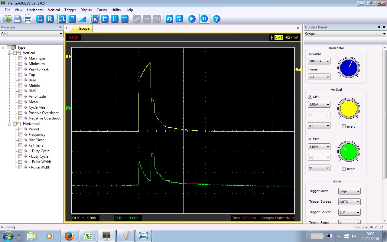

      and the last one at 200us
Name:	CH1 pin8 40106 CH2 40106 pin4 200us.jpg
      • Originally posted by Impulse View Post
        here
        [ATTACH]35371[/ATTACH]
        [ATTACH]35372[/ATTACH]
        [ATTACH]35373[/ATTACH]
        [ATTACH]35374[/ATTACH]
        [ATTACH]35375[/ATTACH]
        Can you repeat the last acquisition at 1 mS? This still looks wrong. Does the delay trimmer have any effect whatsoever on the relative positions of ch1 and ch2?
        Can you also show me the calibrator signal at 1mS per div on both channels?
          here [ATTACH]35370[/ATTACH]
          Those look right, can you provide all images in a horizontal orientation? Also what is your battery voltage, and the voltage at the the plus and minus regulator 78/79l05's relative the shield?

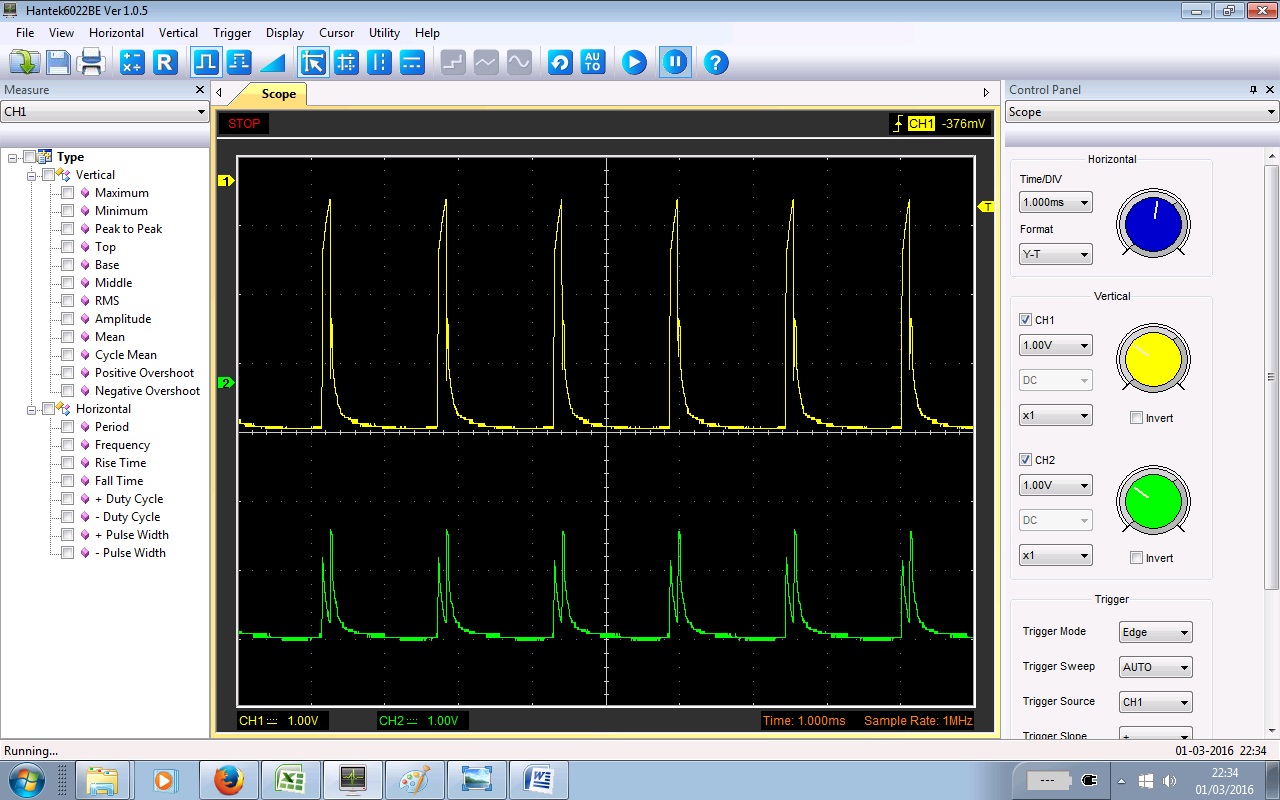

              • here is the 1ms trace Click image for larger version
Name:	CH1 pin8 40106 CH2 40106 pin4 1ms.jpg
                  here is the 1ms trace [ATTACH]35378[/ATTACH]
                  Thank you, also need the supply voltages. The transmitter and preamp are working pretty well. The sampling circuit is not as best I can tell. Can you compare the schematic values (all the parts connected to the 40106) to the actual ones that are on the board to confirm the parts are in the right place. If that is OK, then we have more work to do.

                    • ok i have had another look at the board and the schematic and the only thing that i don't have is the 10k delay pot? was this removed in Rev2? if so where should it go?
                      • Impulse, it would go in series with the delay trimmer in the place where the PCB has a Link between the two adjacent holes. You would have to cut the link with an exacto knife or something similiar and solder the 10K pot there using the center and left pins if they are facing toward you. BUT I don't think this is the problem. The 40106 is not working correctly. The pin voltages should be varying better -5 and 0 volts not just between -4.5 and -5.
                        Maybe someone who owns a barracuda could verify this.
                        It seems unlikely you would get two in a row that are not working. It seems more likely you either have a solder bridge, bad solder joint, wrong components, bad components, components inserted backward like diodes, or something similiar. If you have checked all those things then you try replacing the 40106 once again.
                        Did you ever check the supply voltages as mentioned a few posts above. What is your battery voltage?
                        • A couple more points the pot goes between the two pads that you can see to the right, and slightly down, from the delay trimmer when to board is held so you can read the lettering on the component side. Ohm between those two pads to confirm 0 ohms resistance. Also reheat all the solder joints on the 40106 socket as well as the delay trimmer . Some of those joints look cold. I don't know if you can make a clearer picture of the top and bottom of the board. Perhaps if you took it outside or used very bright light the depth of field of the camera would increase. What I need is very sharp images to see minute soldering defects. If you have an adjustable camera use small apertures like F5.6 or F8 or even larger. Use a shutter speed of 1/60 or faster if possible. In sunlight this should be easily possible. If you remove the 40106 from the socket you should be able to use to use your multimeter to confirm the components installation and values. Hopefully your meter also measures capacitance. If you do an more boards it is a good idea to install the components one section at time to confirm each section works. For example power supply, transmitter, timing section, etc. of course without a build doc this is tougher.

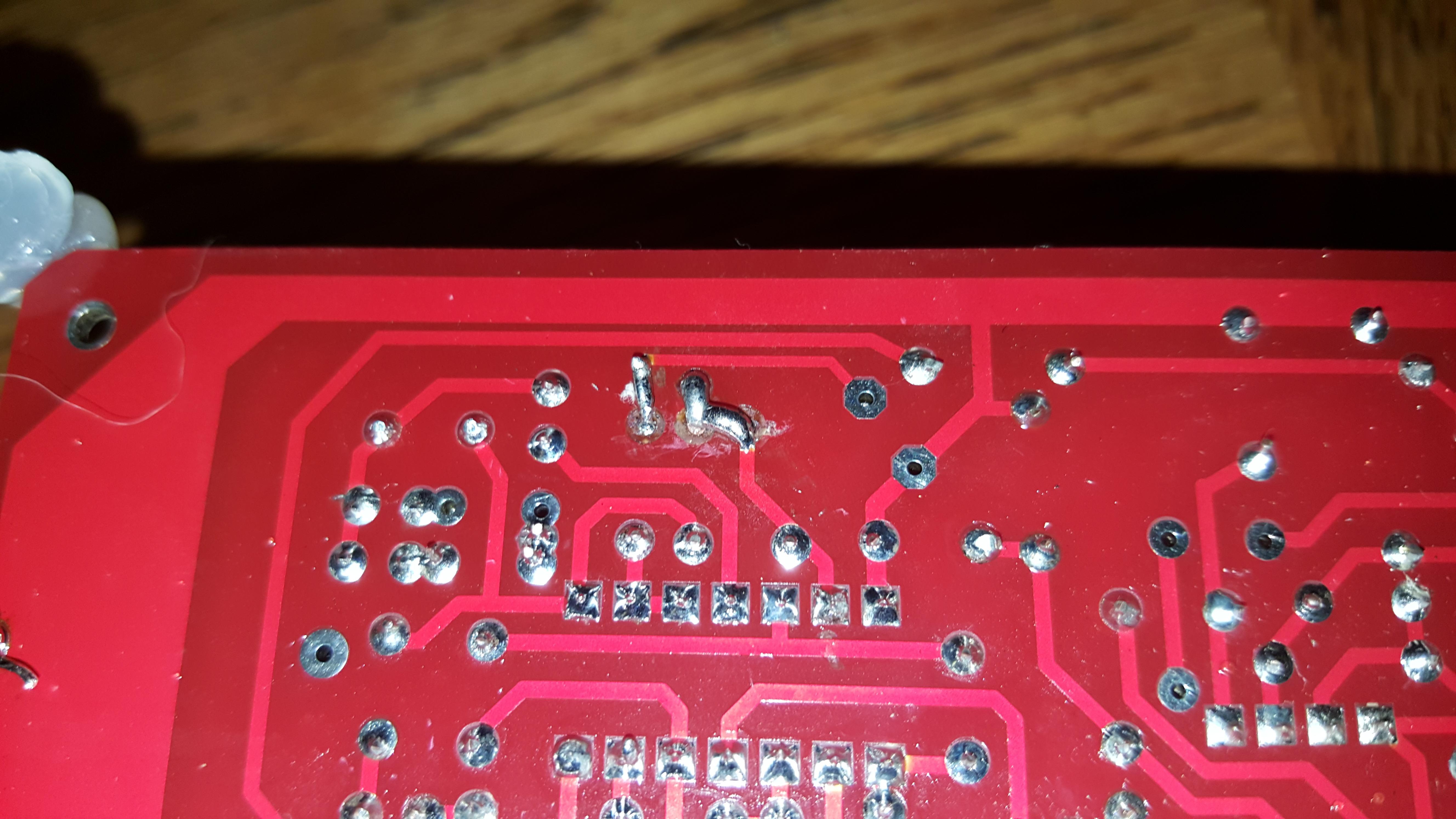

                          • ok i went over the connections and the soldering iron was too hot and broke the board connections for the delay trim so now im back to square one with a messed up board!
Name:	State of that!.jpg
                            • iron was too hot
                              soldering station
                              • Impulse, welcome to electronics. The repair you did looks fine. Have you been using the scope probes in the X1 or x10 position? If the X1 position try setting them to x10 and probing pins 2 and 4 of the 40106. Don't forget to change the scale factor settings in the scope interface to x10 so the readout will be correct.
