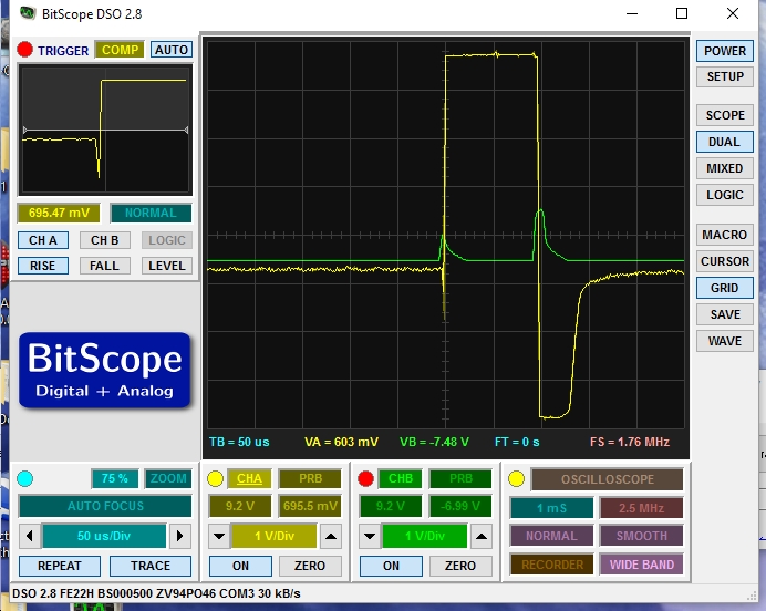

              • hey old cart i have a new soldering station (temp control) and i have taken off the 330ohm balance resistor off and it is fine?
                • Originally posted by Impulse View Post

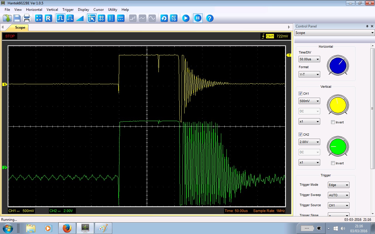

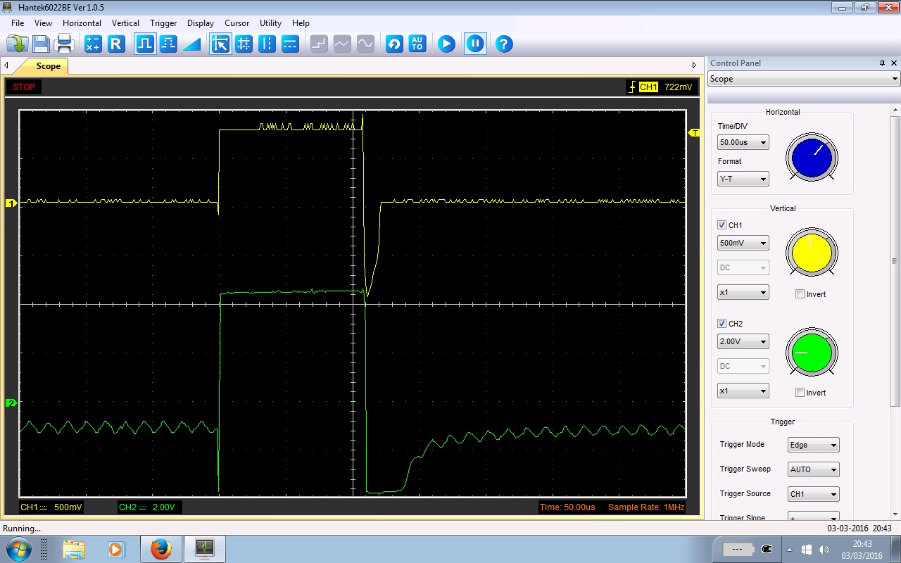

                  Ok show me the 5534 pin 3 and 6 waveforms again. With and without the resistor installed.
                  • ok i have resurrected the old board and it has the same issue with a different coil? 11.4v batt volts. i will go back to the board that we have been working on and desolder the 330ohm balance resistor then take 5534 pin 3 and 6
                    here
Name:	5534 pin3 and 6 with 330 bal resistor.jpg
Name:	5534 pin3 and 6 withOut 330 bal resistor.jpg

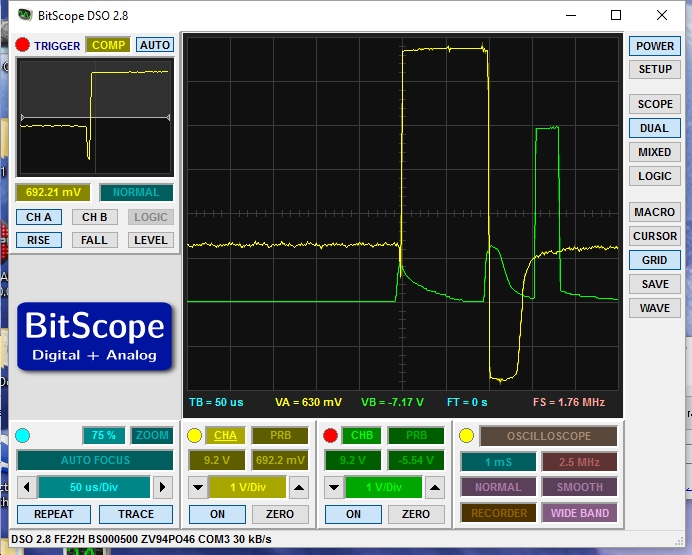

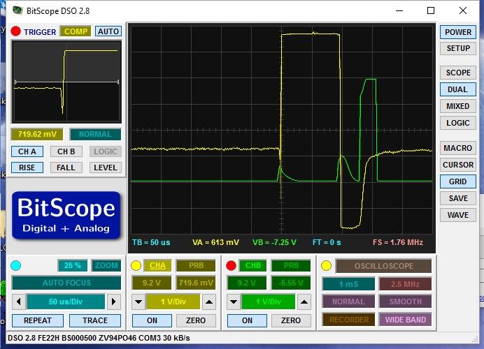

                    • Barracuda Legend Kit Problems
                      Hi Impulse
                      I have a Barracuda PCB freshly purchased and populated. Not sure it's 100% yet, but I attach comparative traces for the effects of the Delay pot. It is actually 20K (marked '203') rather than the expected 25K, but has sufficient movement for my 10" regular wound coil. The pot. is I think a 20 turn, so very fine adjustment. Rotate it clockwise to reduce the resistance and the delay. (It starts clicking when it reaches the minimum, but I failed to note that at maximum).
                      The following monitor traces are:
                      Yellow (main sample): 40106 pin 2;
                      Green (coil pulse): NE5534 pin 6.
                      I think I used 9V power supply (rather than 12V). The relative vertical position of the traces as not significant, being the most convenient to fit both on the screen.
                      The Delay moves the primary sample (main green pulse), with the aim to span the tailing off of the decaying negative pulse.
                      With delay at maximum, the pulse is probably too late:
                      (There are a couple of additional small voltage spurious pulses, when the coil is switched on and off.)
                      With delay near the required point:
                      With delay near minimum:
                      With the delay near minimum the pulse disappears. (and Old cart is saying this is a dangerous setting) My thought was, is there any chance that you have the delay near this clockwise limit and so are losing the pulse? 10 turns anti-clockwise from clicking point seems a good initial setting.
                      It looks like the sample pulse height is 4V, which hopefully addresses Old cart's query.
                      Other figures: The circuit current with no coil attached is around 27ma. With coil attached, it varies by supply voltage and coil resistance and I have figures from 100ma to 200ma. At 200ma both VT1 and the large coil resistor get hot and I've attached a small heat sink to VT1.
                      I hope this makes sense and is a helpful contribution. My first attempt at attachments on this forum. I just hope they work OK!
                      Ray
                        here
                        [ATTACH]35392[/ATTACH]
                        [ATTACH]35393[/ATTACH]
                        First one with damping resistor is good. This is what you want! The second pic, without resistor rings like a door bell, as expected without a resistor. THIS IS WHAT AN UNDAMPED COIL LOOKS LIKE.
                        Do you know that coil inductance? If you do if you take another shot at 10uS per division trigger on the neg edge of the main pulse we can accurately determine ring frequency and knowing this we can calculate the effective parallel capacitance. This will help tell us how good the coil and cable are.
                        • Originally posted by raygdunn View Post
                          Hi Impulse
                          [ATTACH]35395[/ATTACH]
                          [ATTACH]35394[/ATTACH]
                          [ATTACH]35396[/ATTACH]
                          Ray
                          Ray you are correct in all your statements. Those sample pulses look correct and the mid sample position is just about spot on.
                          Impulse have you been rotating the pot 20 turns, that might be the whole problem? If so thanks Ray for helping us find the problem.
                          May be best to just rotate it as described above until it clicks then go back ten turns.

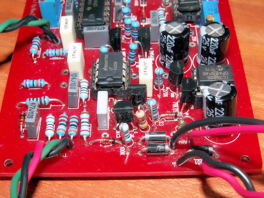

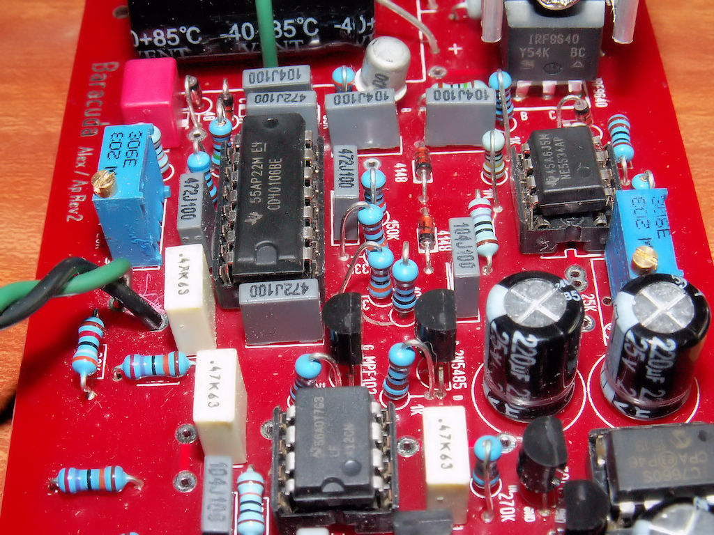

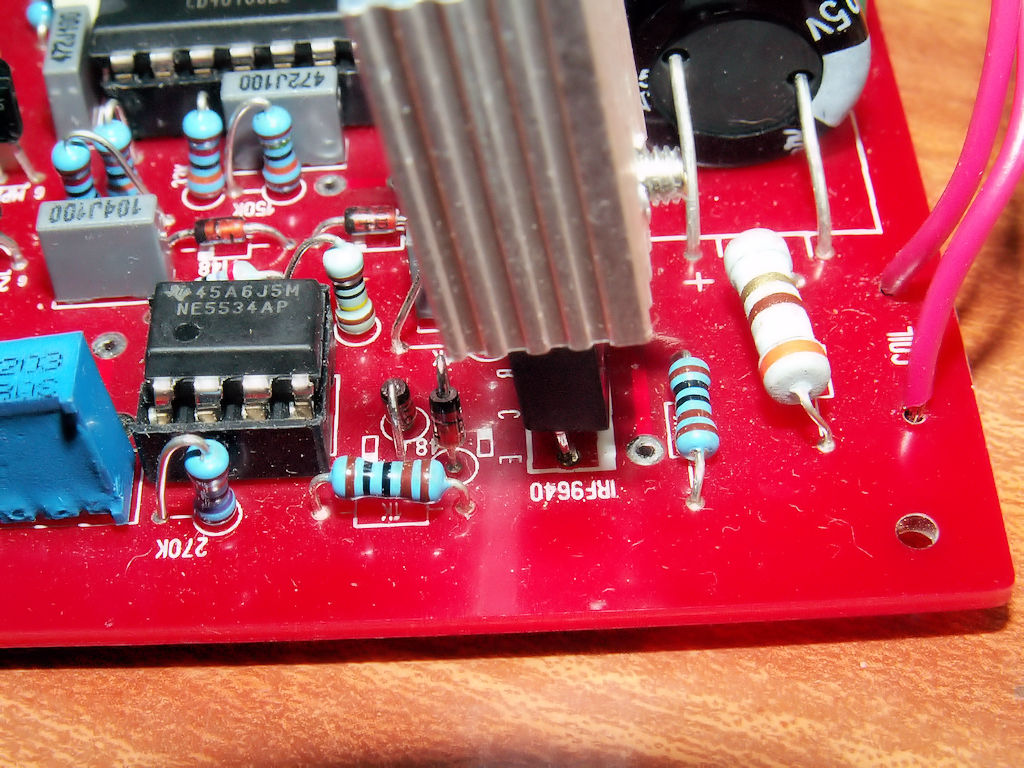

                          Ray,is it possible to get a good clear picture of the component side of the board for comparison, thanks?
                          • With delay at maximum, the pulse is probably too late:
                            It may be possible to eliminate those spurious pulses by bypassing the supply pins 7 and 14 on the 40106 with a .1uF ceramic or film cap with the leads trimmed as short as possible mounted to the back of the board. Those extra pulses can not help anything.
                            • Impulse I estimate that your ring frequency in post 204 about ( without damping resistor) is 300000Hz which is way to low. This probably means you have too much cable capacitance. How long is you coax? If it is long than 1 M it is probably too long and this wil have significant effect on how the coil damps. Simple cut it shorter and you wil fix this problem. This wil allow us to adjust the damping and set the sampling much earlier which is good if you looking for gold or other low conductivity items. If you are looking for iron it wil not help!

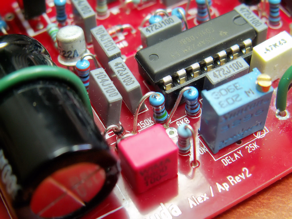

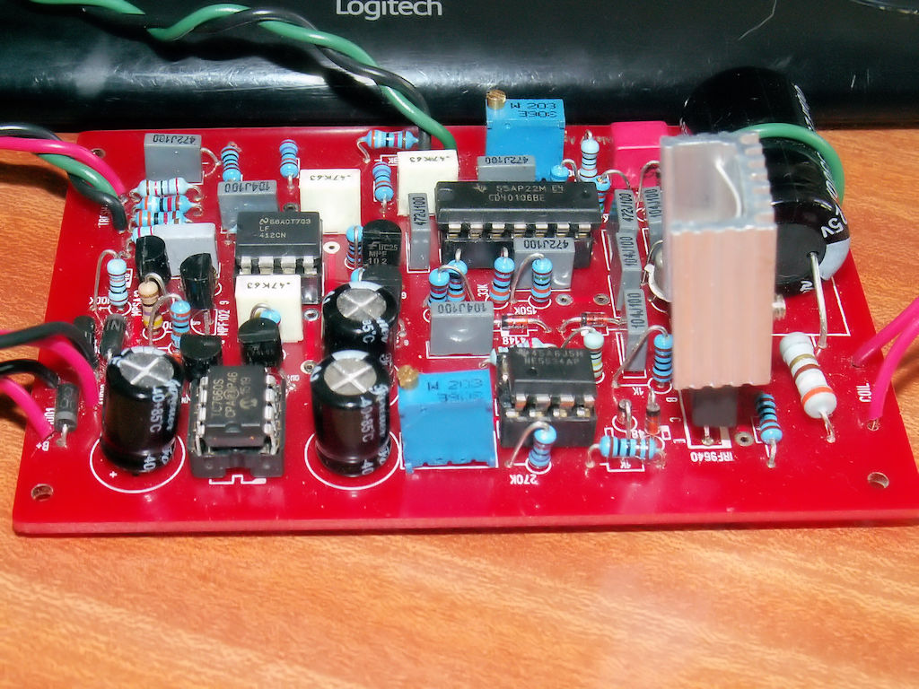

                                Several photos from assorted angles, not 100% indentifiable but close I hope.
                                Ray
