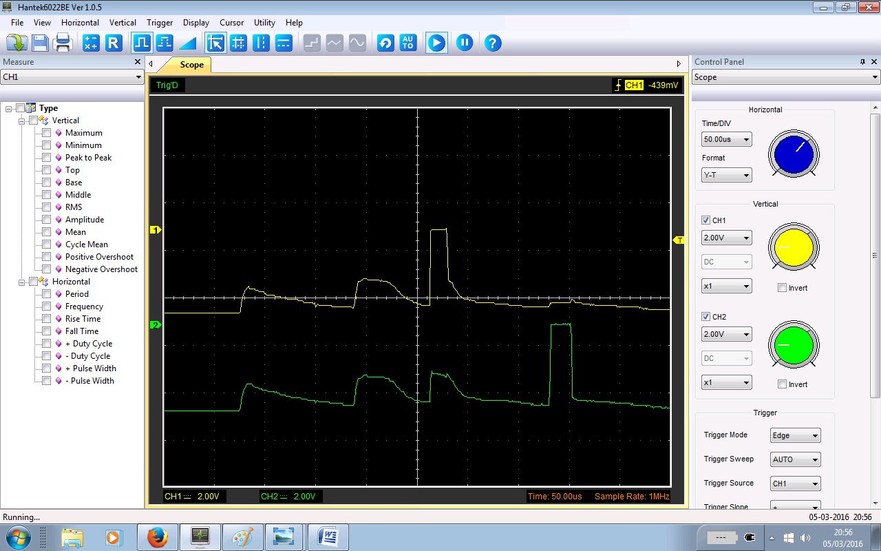

        • Originally posted by Impulse View Post
          ahh now i know what you mean sorry i thought i was missing something, yep no delay between the signals. I have looked at post 210 and all the components are in the correct place. i have a spare 10k pot i can put across the external delay pot connections?
          The problem is with the delay generator U4f, c5 and r10. Something is wrong there. I think the signals pin 2,4 of 40106 have no delay between them because the signal getting to them is too small, it is just a spurious signal that is actually coming from crosstalk between the transmit pulse generator U4 d and e and the imput to the delay u4 f. I thin if we fix the underline part above the circuit will work.
          The 10K pot you have will work great, just set it for max resistance between the center pin and the left pin as viewed with the pins facing down. If you get this correct clockwise rotation of the pot should increase the resistance and the delay. This is the OPPOSITE of the trimmer where clockwise rotation decrease the delay which is illogical and confusing. Then cut the delay pot Link on the board with a sharp knife a measure between the two PCB pads to ensure you have cut it. Lastly solder the two wire from the 10 k external pot. And take traces at pins 2 and 4.
          Make sure you are clear what trace ( Link) to cut before doing it. Ask if this is not clear.
            You do not see THE DELAY between THE signals (the samples' strobes).
            KT I think the problem is those strobes are not being fed the right signal from U4 f, the signals are too small to properly toggle the Schmidt inverters so what you seeing is just a pulse on the rising and falling edge of the transmit signal due to crosstalk. Since this is synchronous with the transmitter there is no delay between the signals. The 40106 has a hysteresis of .9 volt with a 5 volt supply so it will not respond to voltage below that. In this circuit there is a lot of crosstalk, that part if the design looks less than optimum.

              • ok i have CUT the link and put the 10k pot in its place
                here Click image for larger version
Name:	40106 pin 2 ch1 pin4 ch2.jpg
                    here [ATTACH]35414[/ATTACH]
                    This is progress! Try depth test now. Have you got a .1uf cap? If so please solder it, with the leads cut as short as possible. One the back of the board between pins 7 and 14 on the 40106. Remember the pins are upside down and reversed becuase this is the back of the board so confirm before soldering.
