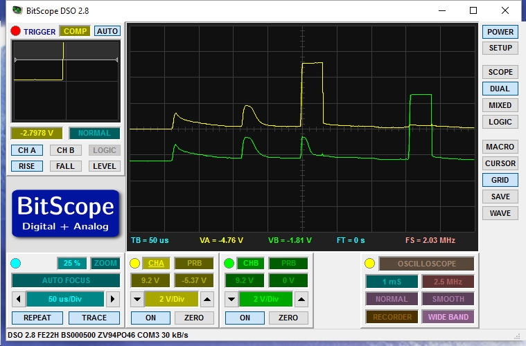

          Originally posted by Impulse View Post
          ok i have CUT the link and put the 10k pot in its place
          here [ATTACH]35414[/ATTACH]
          Hi Impulse,
          Wow that did the trick and now your trace looks like mine. I thought mine was faulty, with those extra glitches, but there they are again.
          I've tried Old cart's suggestion of a 104 capacitor between the power pins to no avail and then confirmed all power lines looks stable. I've actually ordered more chips on the basis that I've damaged the chip and there is some internal cross feed... Noew I'm not so sure. :-)
          Ray

            • Originally posted by raygdunn View Post
              Hi Impulse,
              [ATTACH]35416[/ATTACH]
              Ray

                      There are several things that could cause crosstalk:
                      1. Defective chips
                      2. Flux on board
                      3. Capacitive coupling due to poor trace routing.
                      4. Inductive coupling due to poor trace or wiring routing.
                      5. Power supply bypassing due to inadequate decoupling caps on the board
                      Figuring which one or ones is causing the problems is sometime tough. You just have to attack them one at a time.
                      Replacing chips is easy as is cleaning the board.
                      Power supply bypassing is easy to check you just look for low noise on the individual supply pins. This can hard to do, particularly using cheap scopes and probes which are often noisy.
                      The coupling ones are perhaps the hardest to find and resolve. Sometimes reroute get wiring can help , sometimes the board must be relaid out.
                      It does appear the KT315 has this sorted.
