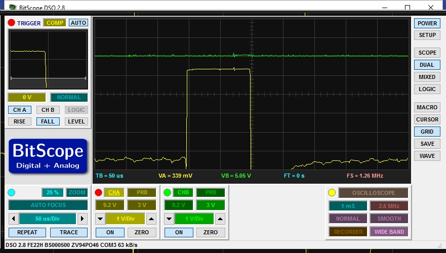

                      I've spent some time looking at this today. With the USB style BitScope, I'm just getting complete mush at 50mV per grid unit. Examining the 5V supply outputs at 1V per grid unit I get the attached. Both monitors compare the NE5534 pin 6 output pulse with the power line. I switched to a high power battery for the following but couldn't see a difference, but bags of supply power from a 1300mah Lipo at a little under 12V.
                      The 78L05 has just a hint of somthing towards the end of the pulse.

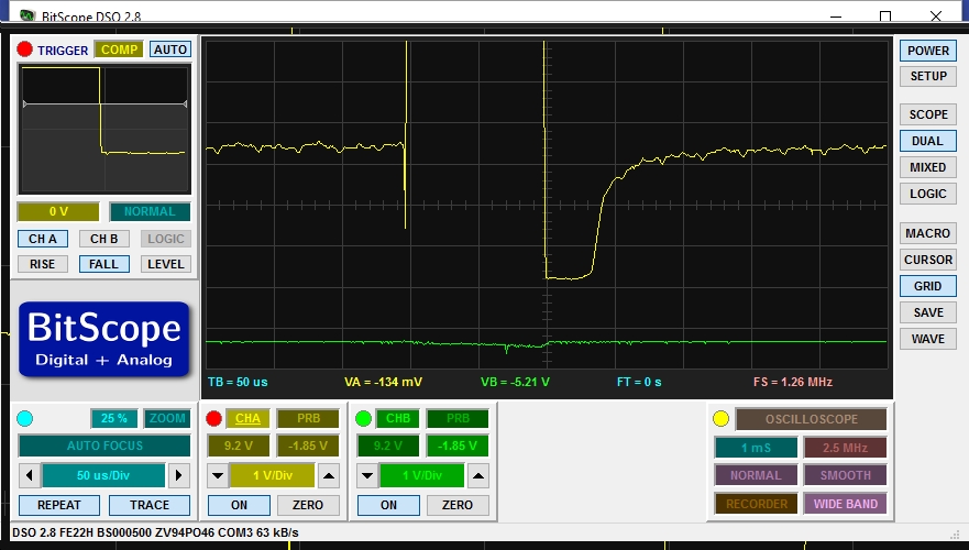

                      The 79L05 (supplying the logic circuit) has what I'd take to be a dip and recovery when the coil pulse ends. My estimate was 0.1V recovery from the grid.

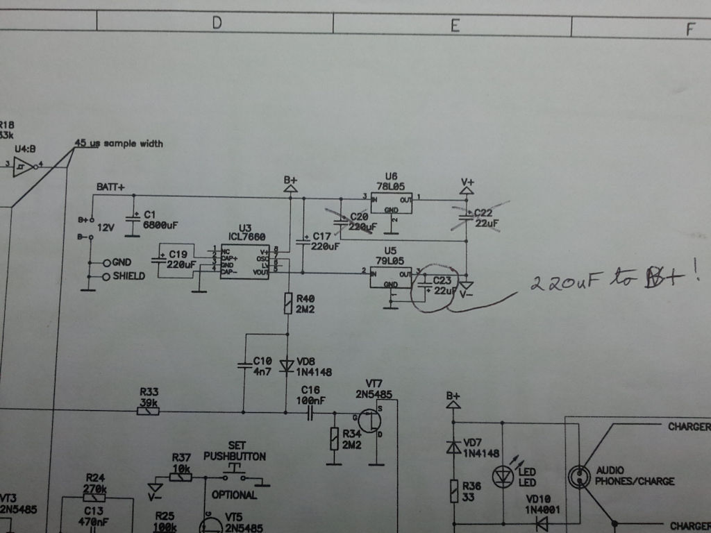

                      I compared the latest schema with the top of PCB image showing component placement around the power supply area. (And marveled at how people can produce a schema from a populated PCB!)
                      C23 on schema is 220uF (not 22uF), which is good, but instead of connecting to ground it connects to B+. Does one lose anthing doing that?
                      Suply stabilising capacitors C20 and C22 are not part of the PCB design. Just possibly this was aimed at reducing bulky components or an error in translation? Not sure C20 would be needed, as C23 does something similar.

                      I could try connecting C23 to ground instead it has a long separate copper track that can be cut and a wire added to the back of the board.
                      Ray

                            c23 should be 22 uF and looks to be correct in the schematic. It should not go to b+. C20 and c22 should be there but may not be on Silverdogs PCB layout. I don't like them going to -5v But somebody did it this way for some reason, so you try this connection first. Then if you want you could try connecting the negative side to ground and comparing the results. Sadly your scope does not have low enough noise to make a proper measurement so you wil have to test subjectively. If you have a good multimeter with true RMS you could try to use it in AC volts, which will reject the DC component and just measure the ripple. By good I mean one that costs more than $100US?
                            Do NOT use AC+DC volts range if your meter has it. You should note that the multimeter, unless it is VERY good wil not make an accurate measurement but it wil make a relative one.
                            To do the caps you can just tack solder them to the back of the board,using the shortest lead length possible. Be careful not to short traces. I would be interested to hear how this goes.
                            BTW bypassing is as much art as science. Sometimes it does not help at all. One such case would be if the supply is not really the source of the noise. There are ways to isolate noise but the require a lot more equipment and knowledge than most of us have.

                                Thanks Old cart,
                                I do hate getting things wrong... I was expecting C23 to be like the rest at 220uF. I see now that the capacitor I thought was C23 was actually correctly connected C20! So C22 and C23 missing.
                                I'll try tacking on those two capacitors. Then maybe look at the longish power track to the logic chip. It will be tomorrow before I can try it now.
                                Ray
