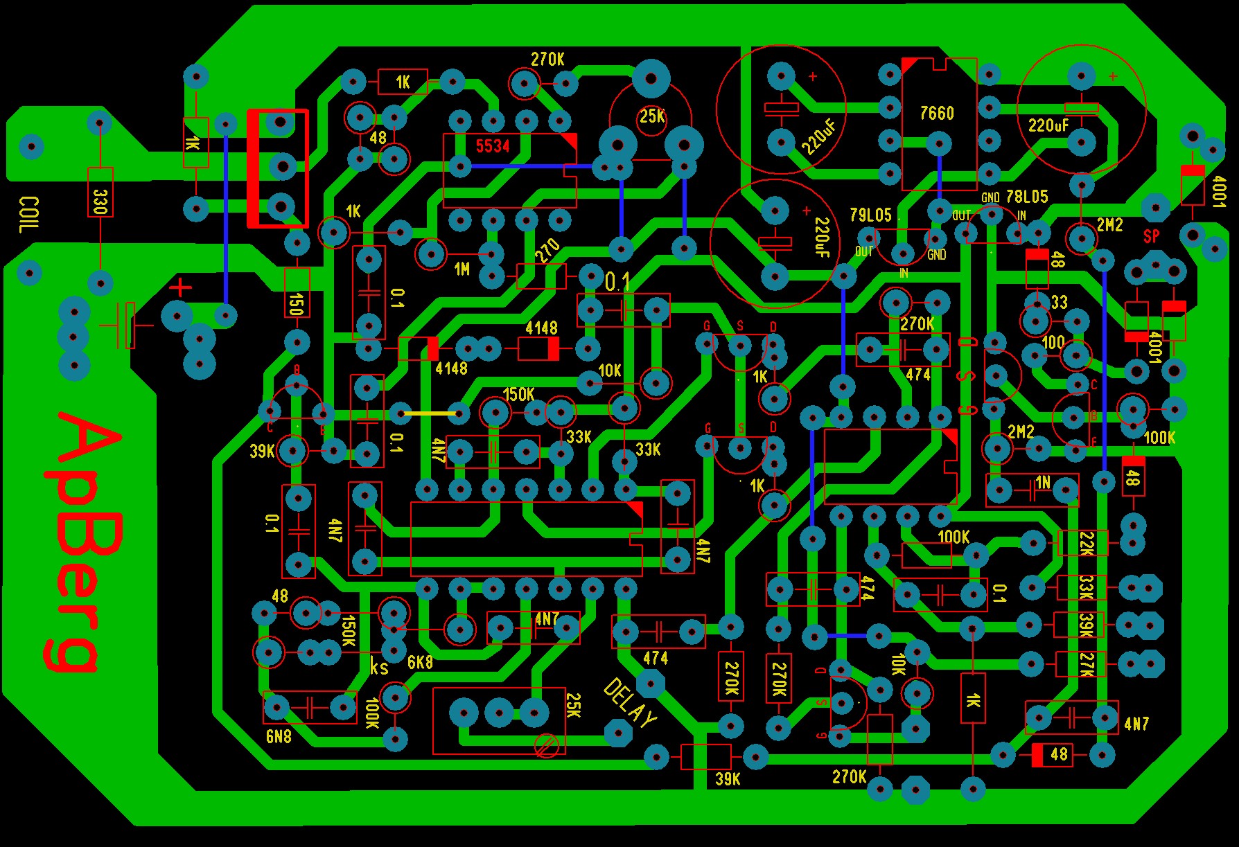

                        You may also have noticed that there's a 100nF cap connected to the gate of the 2N2222 (which drives the MOSFET). I presume the idea behind this is to prevent the MOSFET latching on if the TX oscillator stops working. However, this also means that the TX on-pulse is actually shorter that the applied driving pulse, which results in an extra delay between the time when the drive pulse goes low and the main sample starts. This is why I'd like to see some scope shots of the various timing signals, as I suspect things are not quite as they seem.

                          I haven't followed this topic (building such detectors is like riding a bike, you made first one... than you made them all the same) and i am not sure exactly by what pcb draw you are making it;
                          but i can repeat here again 100% checked and proven pcb which i used (as i recall drawn by our nice friend ApBerg (which should be respected and printed on each pcb copy done&sold by others here)):

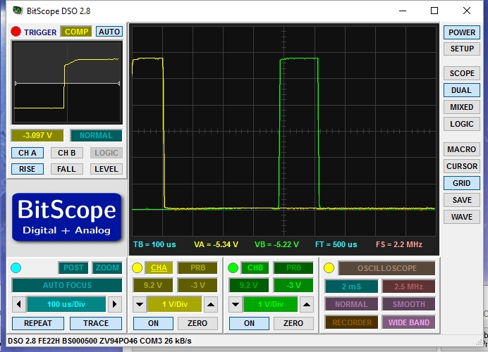

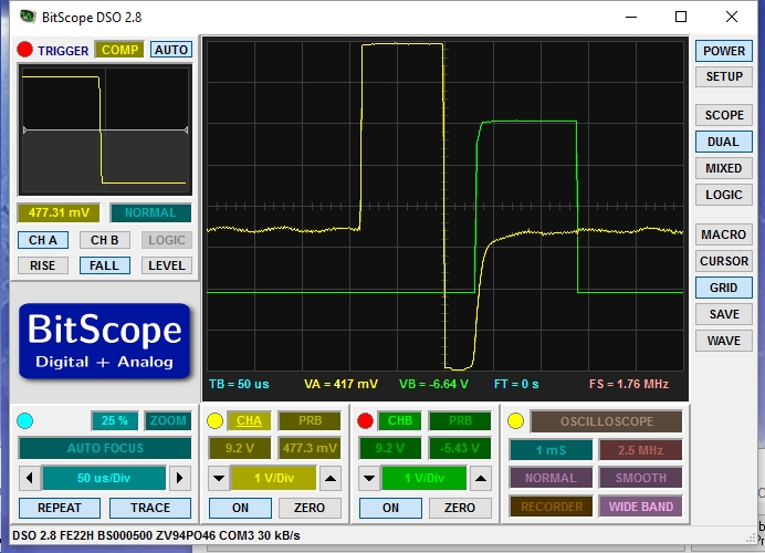

                          • Originally posted by Old cart View Post
                            Here is a good example. Impulse has .55 volts on pin 1 of the 40106. This is an actual measured voltage, not a simulation. This clearly exceeds the absolute maximum input voltage rating of TI. This 40106 also is not working correctly. It introduces additional pulses that should not be there. They are runt pulses ( smaller than normal) the occur on the rising and falling edges of the transmit pulse. These may have no effect on the Baracuda operation, but they should not be there!
                            One simple solution would be to cut the trace that leads to the +5 volt regulator very near the 33k resistor attached to pin 1 of the 40106. Cut the trace between the 33k and the regulator NOT between the 33k and pin 1. This will allow R17,18, and 19 to float. Then tie this point to pin 14 of the 40106 with a thin jumper wire. This hold place pins 1 ,3 and 5 at 0 volts which is still a logic high and will not exceed the chip specs. However it will likely alter the timing of the two timing pulse and require resistor value adjustments.
                            if someone can look this over it advise if I have this right that would be great.
                            Hi Old cart,
                            I've moved the timing resistors supply from V+ to Earth. (Removing the chip before I started :-) )
                            * Initial sample pulse start point looks unchanged
                            * Initial sample pulse width increased from about ~40us to 100us (KT schema reads 45us)
                            * Delay start of first to start of second sample now ~480us.
                            * Second sample width was about 40us now ~130us
                            * This mod has no effect on the rounding of the leading edge of the first sample pulse. I thought it might. This separate oddity arises when the Delay is moved to an early position and starts somewhere close to optimal. This is on a standard 10" coil. Strangely it appears to cope better with the very short delay on a spider wound coil.
                            Pin readings from 40106 are very different:
                            1: -4.60V
                            3: -4.53V
                            5: -3.40V
                            And without further adjustment I still get 8" range in a GB half penny, (which I thought was a 1p in a recent post, so quite small).
                            Retiming this, I'd guess would be by soldering a couple of leads across a timing resistor (150/33/33K) for easy access, add a 100K pot (plus possibly another fixed value) and adjust until the scope shows original width. Then calculate the combined value of the two parallel resistors.
                            Trace showing wider primary sample pulse Click image for larger version
                            Trace showing extended delay from start of primary to secondary sample pulseClick image for larger version
                            Ray

                              • Mods part two
                                Originally posted by raygdunn View Post
                                Hi Old cart,
                                1: -4.60V
                                3: -4.53V
                                5: -3.40V
                                Trace showing wider primary sample pulse [ATTACH]35557[/ATTACH]
                                Trace showing extended delay from start of primary to secondary sample pulse[ATTACH]35558[/ATTACH]
                                Ray
                                Well done!
                                i would not expect any performance improvement only that the detector would be more reliable becuase the IC's are run within spec.
                                if you want to continue the experiment parallel a 100K pot with each of the resistors below adjust for the timing stated. If you know how to calculate the parallel combination do it and replace the each resistor with that calculated value. Please report the results to us.
                                RESISTOR. ADJUST. MEASURE PIN ON 40106
                                R19. 45uS. 2
                                R18 45uS. 4 should closely match width on pin 2 value should be similiar
                                R17. 150 uS between the two pulses above. 2,4- you may have to use a larger value pot than 100 K.
                                That should do it. The delay should work as it normally does and should move both samples the same amount and not alter their values. Since you are measuring I would adjust the delay trimmer on the board to set the minimum deal ( with delay pot set to 0 ) to the delay we discussed earlier with the fastest coil you can build. Then use the separate pot to set the delay to reject small foil etc if you are search for big stuff. You always want to use the smallest delay possible when searching for low conductivity items like gold.
                                This mod also might make the delays more stable. Most people do not think about this but delay jitter causes noise. You might retry the bypass caps we tried earlier if they have been removed. Mainly the ones between pin 7 and 14. The reason this may help now is that it will remove noise on the minus supply. It did so before BUT the delay was referenced to and affected by the noise on the plus 5 supply, which we did not bypass.
