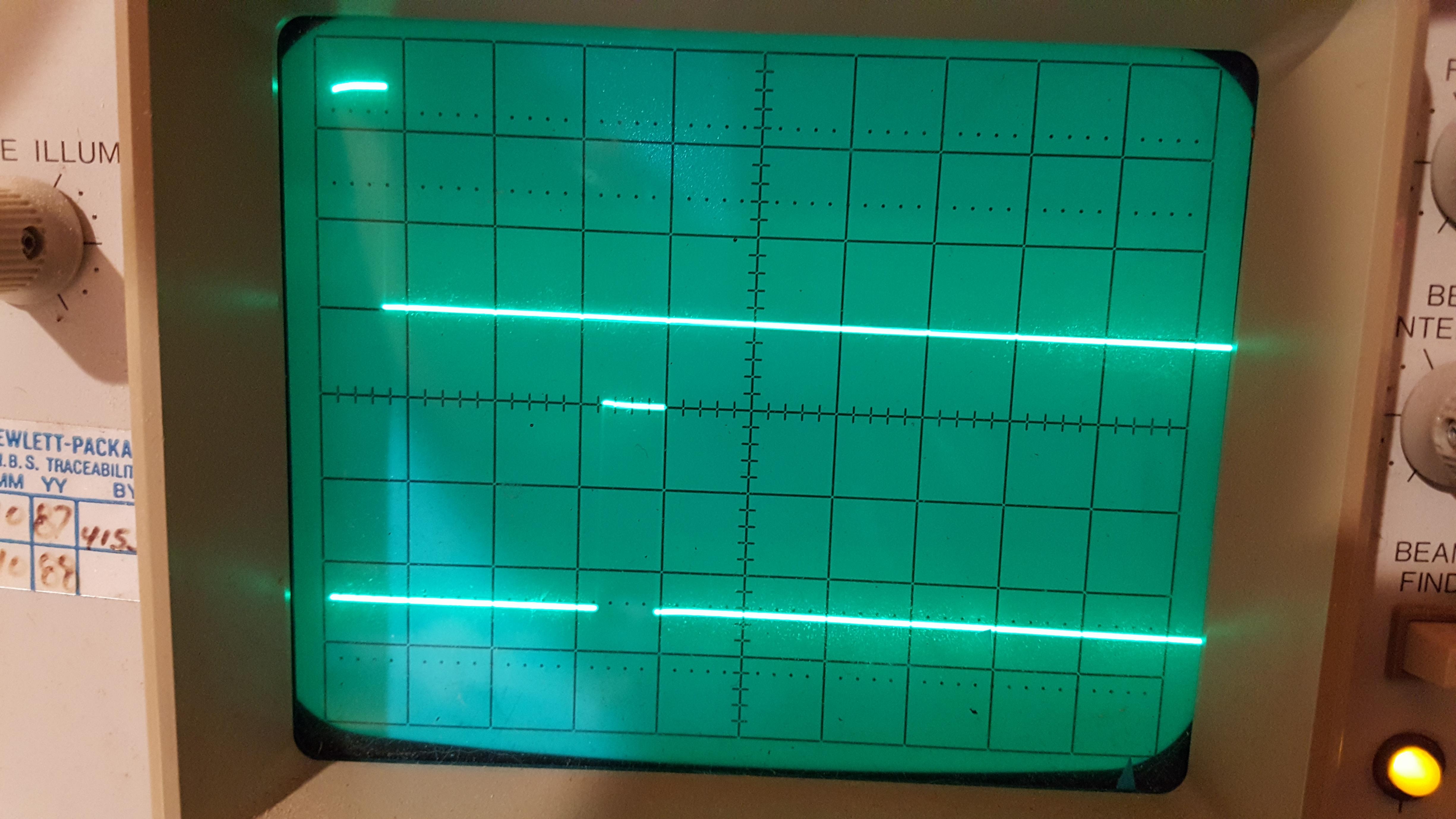

          Don could you measure and submit photos of the 40106 pin 2 and 4 waveforms measured relative to ground from Bara 2 above? That might help us figure out what is going wrong.
          Here u go.. Top trace is pin 2. Bottom is pin 4.
          Sweep = 50uS/ div
          Y axis is 2V/ div.
          Pulse is essentually returning to ground from -5V. I have my scope ground reference on the minus lead of C1.
              Sweep = 50uS/ div
              Y axis is 2V/ div.
              Don, those look very clean, there is no spurious signal riding on them as we have seen. The earth field pulse looks a little narrower than the main sample pulse. Maybe not enough to be an issue. It appears like the 40106 is working great.
              Can you also repeat with the preamp out pin 6 and main sample use shown on the same trace? Trigger on the negative going edge of pin 6 above ground and maybe 10 uS per div. Looks like you have a good old hp analog scope there. is the 20 MHz bandwidth limit on?
