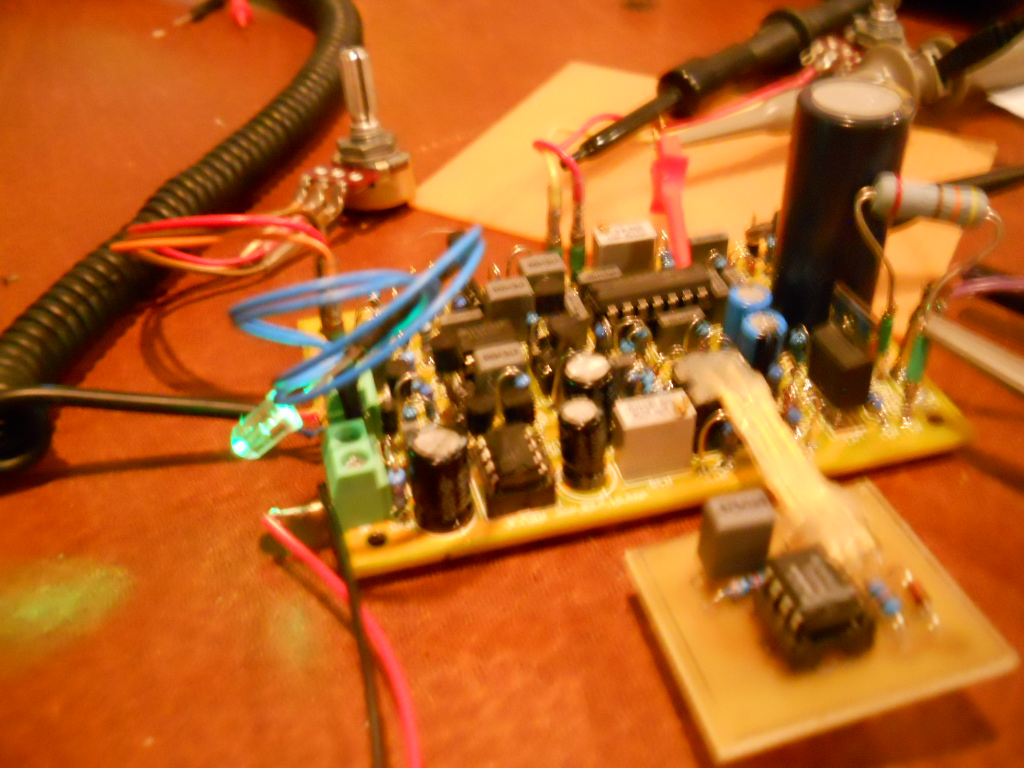

  • Hi Qiaozhi,
    My new 40106 is working well with all the mods in place. ☺ Audio send is more stable. Many thanks for the capacitor mods. Haven't tried it for movement sensitivity yet. First stage of 412 shows an offset of something like 1.25V. I guess this is likely to show some earth field sensitivity when off balanced from zero. This varies somewhat with the Delay setting. I take it that the ceramic magnet test is better than plain zeroing. Both by pulse width adjustment.
    ICL7660S is a different story. Still overheats at 11.8V without 40106 in circuit. But runs cool on 9V (so useable). Other chips the NE5534A and LF412ACN seem to be running normally. I've checked all pins connect through the DIL socket OK. I still have the option to change the 79L05.
    I finally figured out the basic workings of the 412 stages. Not bad, once I focused on the op. amps. I now see why the control is called Threshold. I had wondered.
    Ray

        Did you adjust both the main and delay sample pulses to the same width before tweaking with a magnet? There is another way to adjust the 412 sample integrator for better balance. It involves adding a 100ohm trimmer with the two outer pins going to the two fet sources and the wiper going to the junction or r20 and c11 ( KT315 schematic). This involves cutting the trace between the two sources. By the way the schematic mentioned above does not agree with this. The layout has the sources and drains exchanged. This should allow very fine balance of the FETS wither the magnet test and the sample pulse widths equal.

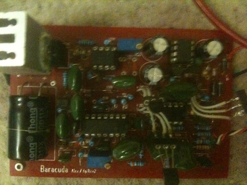

        • One more inconsistency between bara PCB (rev2) and schematic...
          On the schematic, both the 78L05 & 79L05 have 220uF caps on inputs (even though both are connected incorrectly)... however, the 79L05 actually has one 220uF connected to its input and another 220uF connected to its output... The 78L05 has no 220uF cap on it input as indicated by the schematic... And neither regulator have the 22uF caps on their outputs as indicated on the schematic...
          The input to the 78L05 comes from a battery so chances are it really doesn't require a 220uF cap on its input (good practice is to include one) but more importantly voltage regulators almost always require an electrolytic or tantalum cap on their outputs...
          So... in a nut shell, the board arrangement is close with the following exceptions... 1) the fact that the 79L05 has both cap's positive terminal are connected to Bat+ when they should be connected to Ground (Ground is positive with respect to -5) and 2) the 78L05 has no output cap (~220uF)...
          Just thought I'd add this for those making changes to the caps and as a reference for next build...

            • I tried the instruction too... set pulses width to matched but I'm still not getting 12" for a UK pound... more like 6" ;(
              @Ray, did you notice my last post (2 up) re caps on regulators?
              Turns out the -5 volts supply has both the 220uF caps on it for rev 2 board... one on input and one on output... the +5 has no smoothing caps...
              I think I may have disconnected the output cap (-5) which would be an issue... tomorrow I'll correct that and try again...

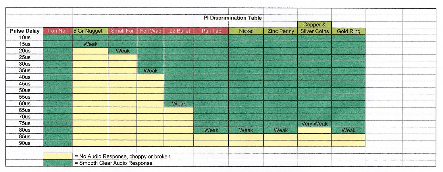

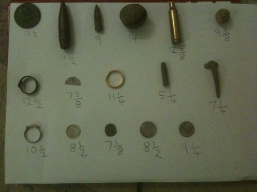

                • What's a good target for testing/setting the delay setting.
                  If I set for maximum distance on a small gold ring I get poor distance on a small fibula. Where as if I set for maximum distance on the fibula a only loose less percentage wise on the gold ring.
                  • Originally posted by Koala View Post
                    That's normal. It depends what you're searching for.
                      This table was made by somebody else and tells a couple of stories.
                        Cheers thought I had a good compromise. Small hammered coin (14mm) at its maxim 6-7" (solid-faint) and Victorian Penney only lost an inch @ 9.5-10.5" and still had some discrimination. Fibula was still close to its max.
                        However when I went back to a gold or silver ring I was down to 8" down 3 inches.
                        Bit more testing needed but ran out of power in the batteries.

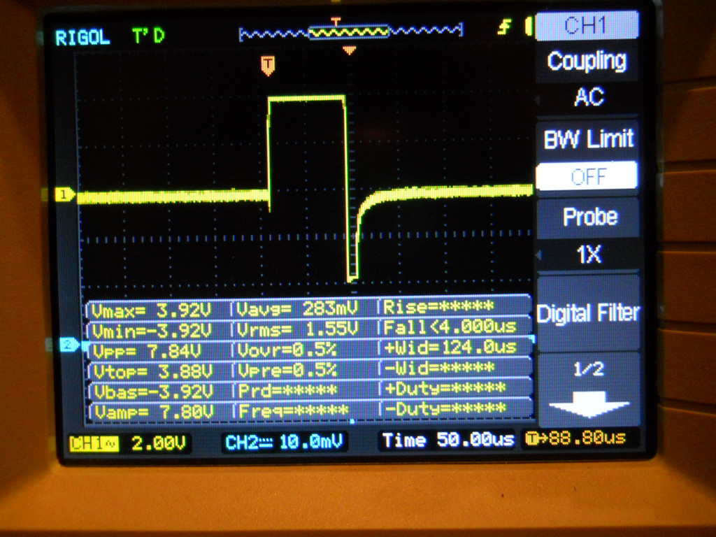

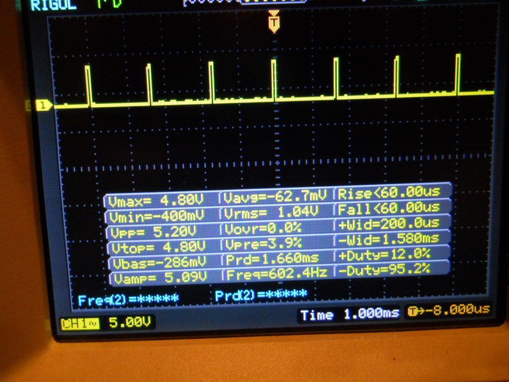

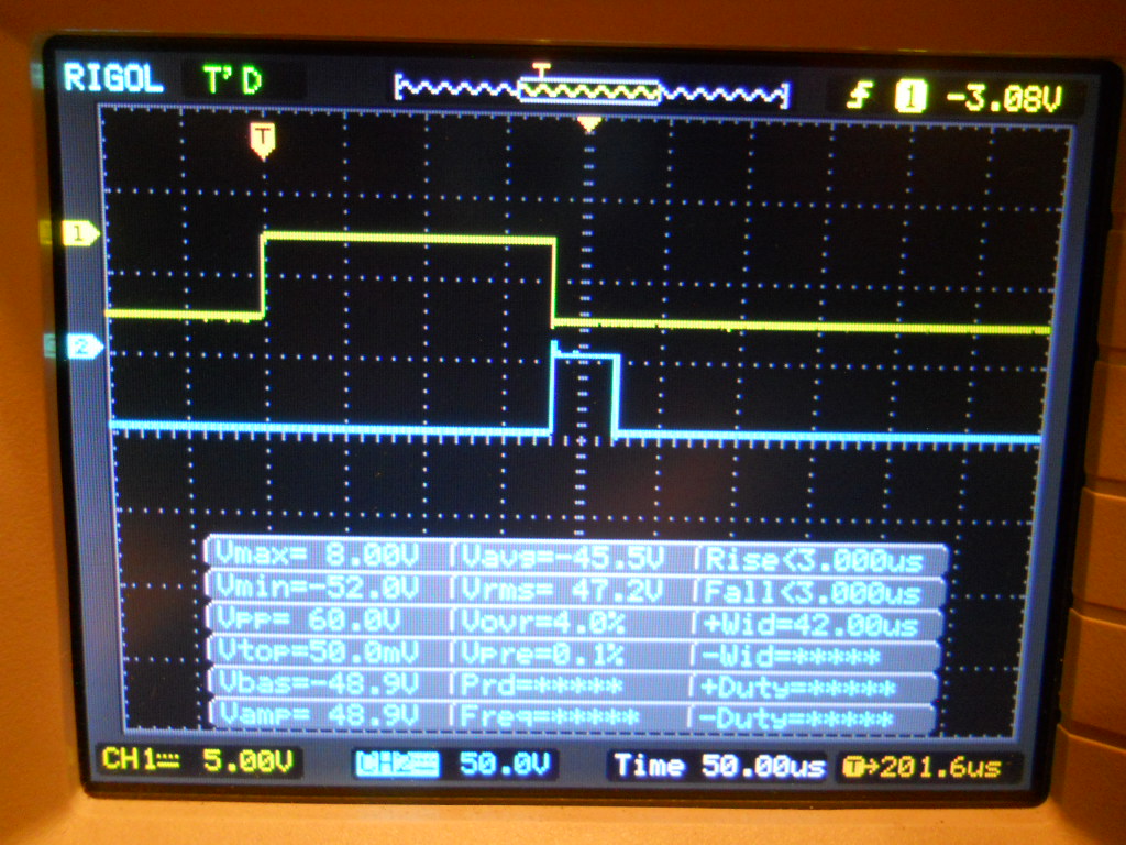

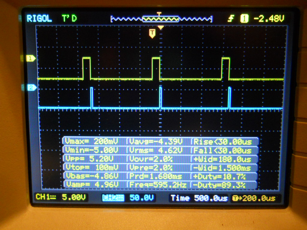

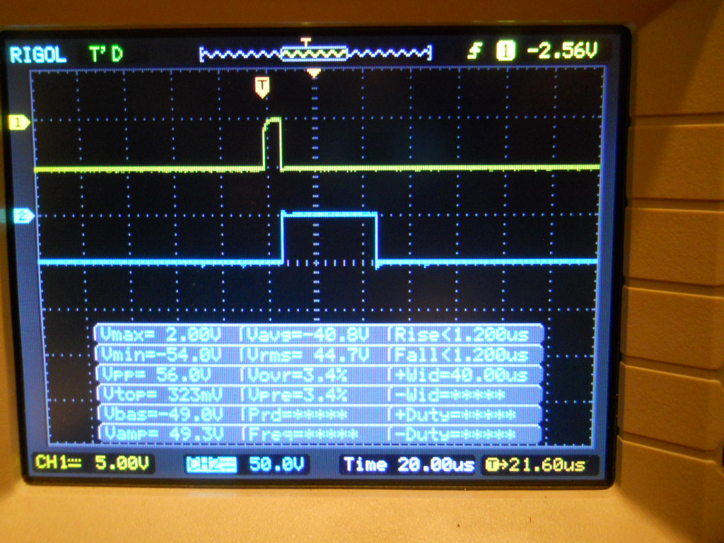

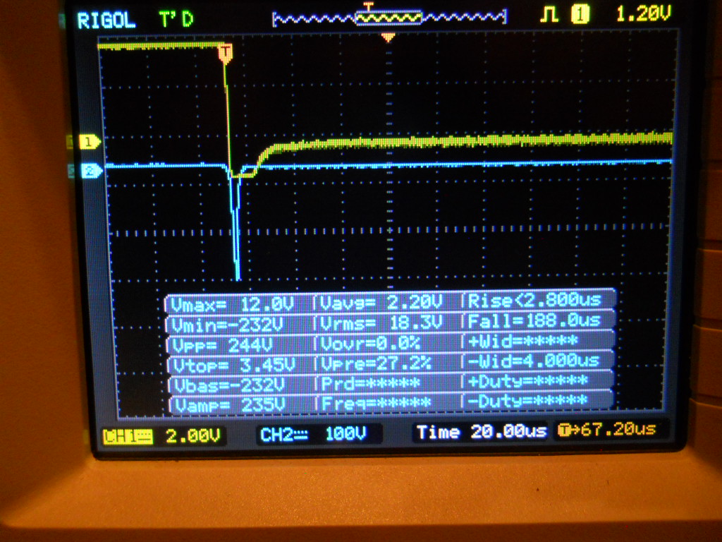

                        • Here are some scope shots from my Barracuda Kt 315 version. Im on the road again and all of my testing has been indoors in bad EMI and also lots of rebar in the floor.
                          Performance depth is pretty much on par with most other posters. Nickle at 10 inches in bad Emi.
                          At first I thought the motion non motion did not work but turned out I needed to move the coil 4 feet off the floor due to the rebar. It picks up large metal very well but strangely only has a depth of 4 inches on all my other test targets from gold rings to coins all hit the same.
                          Tx Pulse

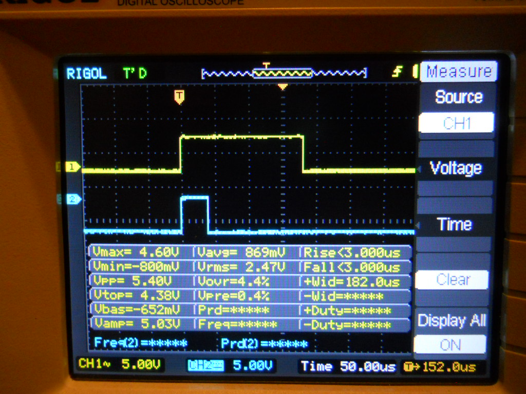

                          Tx and main sample delay
                          Sample delay and main sample

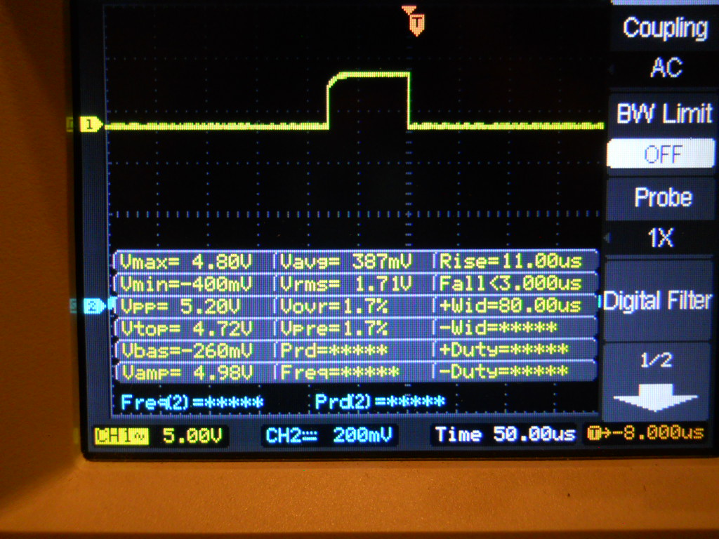

                          Earth field delay and main sample
                          Earth field sample

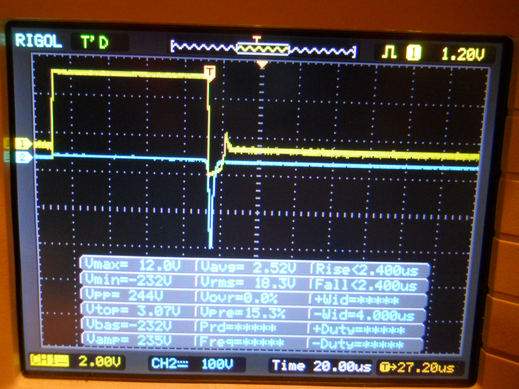

                          Pre amp out and voltage across coil. (maxim 410)
ID:	345454Click image for larger version
