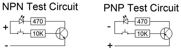

                      Its very easy to test any NPN or PNP transistor. When you have the correct pins the led will light.

                        • Woo-Hoo! PN2222 reversed. Offset pot removed and checked. 0v available at offset-best signal at approx.100mV. I just can't understand how it was working with the 2222 reversed before??. Now for delay/coil/damping/ic swap experiments, as still only and inch with the Oz 10c piece.

                          That tranny tester's a keeper 6666-showed me the PN2222 did indeed need to be reversed. Despite checking the datasheet, I still stuffed up.
                                CHILDREN GARDEN!!! i give you right way! you can CAN NOW! check all semiconductors and MOSFETS too!
