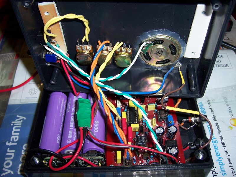

      Anyway, now I have tried a few more component changes. I am at 750R with the damper, Tried 82,220,330,430,510, and now have Oz 10c piece at 5 inches, and can detect a ladies fine gold ring at 2 inches, and an Oz 5c at 4 inches. Previously these were un-detectable.
      TL062/LF412 no difference, so back to 412.
      My batch of 5534s, I have now binned 5 out of 10. 2 with broken pins, 3 failures prior to or during 2222 dilemma. The HEF 40106s came pressed into styrofoam, causing static, and both have now failed. The CD40106 is OK, but I have not tried the other 9 of them. I will try not-so-cheap suppliers next time, and different manufacturers.
      Still no threshold tone........
      I did have one intermittently, with top cover skewed, before the sparks, and 2222 inversion.
      Any suggestions please?

        • Another angle at the no threshold problem. Which resistor value would I lower/change, or resistor/capacitor combo change to increase the threshold? I have sort-of figured R24/C13 on the KT315 schematic. But perhaps the problem is still with my 40106, or VT3/VT4 combo?? Or maybe VD1 or 2 faulty?
          If the R24/C13 change is an option, what values please?
          I am at a loss to the poor performance/lack of threshold.

            • Thanks for the reply FatBob. I have a Tacoma56 SurfPro DD, and with the ML CommanderDD 10x5 it's and awesome machine, and will match my Infinium with the 8 inch mono on my 1.7g flour gold test-about 7 inches in-air.
              I'm reasonably sure 'tain't external noise, although the times I did have a threshold, it could have been the reason.
              Maybe voltage (10v), or current. I'm using 3x18650's@2500mA(11.1-12.6v), and need the 10v reg, otherwise my 7660scpaz's cut out with fully charged batteries-don't have a 12v reg currently, but changing to a LT1054 converter, when they arrive. I will turf the reg then. I tried a LM317T regulated to 11.5v, and the 7660 still didn't work.
              I'm leaning towards a faulty/poor 40106 still, so more/better/differents on the way.
              In the meantime I will temporarily lower Rs on either side of thresh pot for a try.
              If none of this works, I'll change out the 4148s, then the matched fets one at a time to see if un-matching them gives me a threshold.
              I am sure some of the gurus are reading this, and shaking their heads- some input please?

                    Check for shorts between the wires going to the threshold pot, also on the pcb itself. Check to make sure the threshold pot is OK. Last check the resistors attached to it for correct value and operation.
                    The 40106's have been major cause for problems as have the 40106 pull up resistors.
                    But until you have the supplies all correct all bets are off.

                      • Thanks Old cart. My board is spotless and traces correct.Will check/change the thresh pot and have a squizz at the Rs there. I did notice the pullup Rs changed on the Alex version from earlier ones, so worth consideration. Although my 7660s are scpaz, I fear this batch are inferior, as my 40106s, so I will replace both when my new batch's arrive.
                        I won't cut and shut anything until I get a voltage converter that can handle 12.6v.
                        Thank you sir-sound advice, and a process of elimination for me to follow.
                        All my builds so far I use 3x18650s, with an on-board 4A charge controller(alongside batteries in pic above). The method in my madness is that they can be charged from any un-regulated 12v source. I have a 12v 1.5w solar panel mounted on my stem for constant charging, to extend battery life on long hunts, and charge while idle.

                                Look at the posts found in this thread
                                http://www.geotech1.com/forums/showt...it-Rev2)/page3
                                the pull-ups values have been changed as have the voltage they are referenced to. Plenty of good discussion there. You wil also find a new schematic further down that captures all the changes. But read it all. Even the last schematic has a 2.2M resistor in the threshold circuit. Later in the thread the value is corrected to 39 K as I recall.
