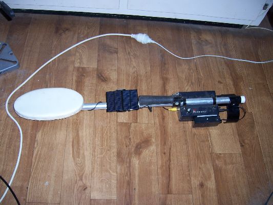

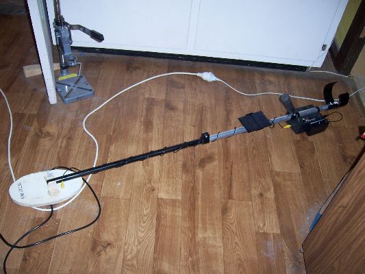

Here are pics of my standardised design.
Thank you all for your input!!

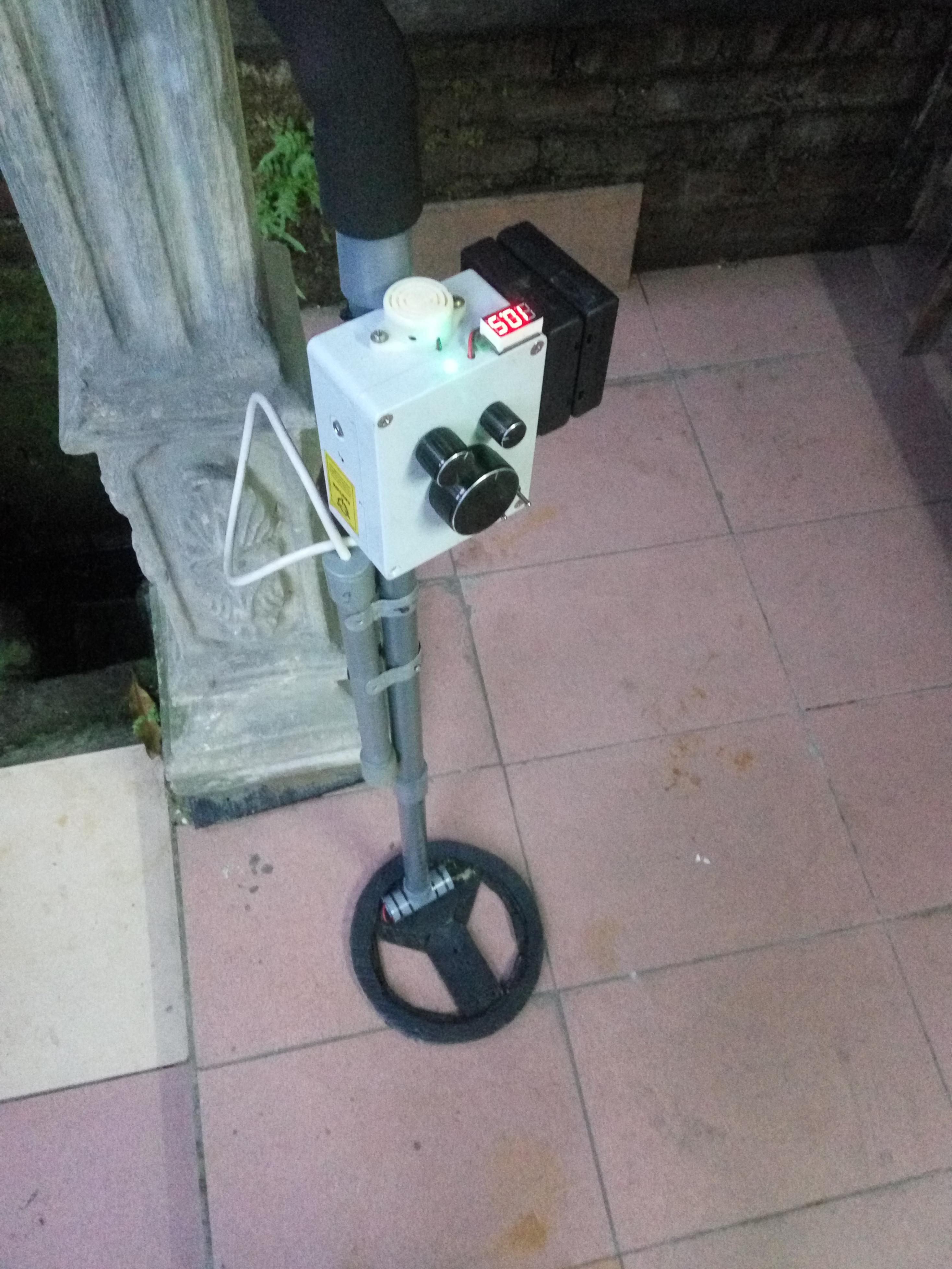

My bara setup
That's a wild looking weapon ripsdevala! Is that a pinpointer strapped to the side?

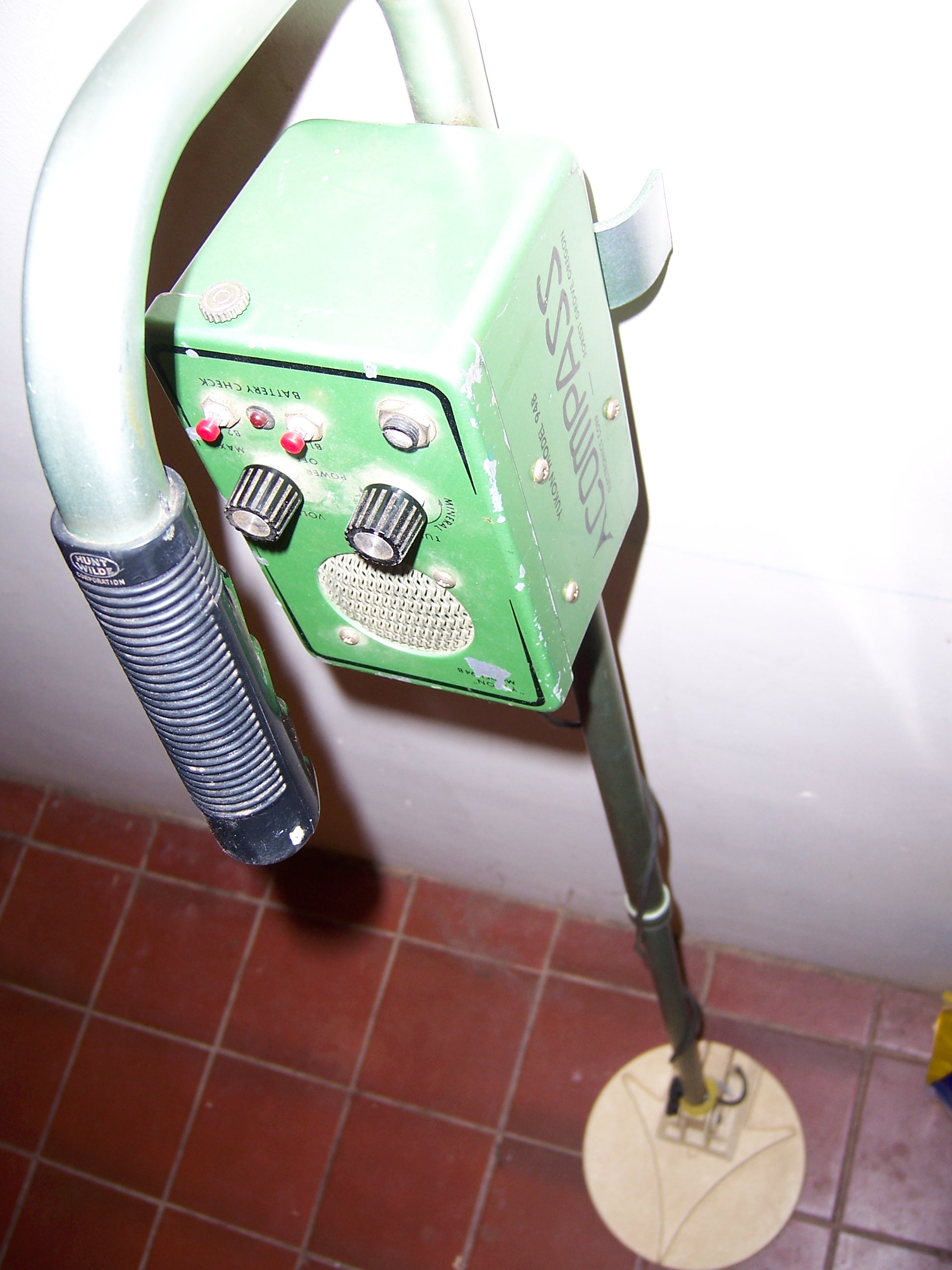

The Compass 94B schematic I posted back a bit ignores all small iron but sees very small gold etc. It is induction balance 100kHz. They excell on trashy areas, and are still used by many around old buildings etc. My original one I use daily.Attached Files
