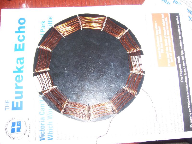

          • I made a Tuggle style spiderweb coil - .5mm 6 inch, but didn't make the slots deep enough, so was only able to wind 285uH worth of wire on it. But it works really well on the Bara. About 3 inches on my 1.7g flour gold. The Coiltek was sensing as metal left the field. I went back perusing the IDX thread and saw the post about a double signal being remedied by changing coil wires around, so I just tried this on the Coiltek-ML pinout GND to pos on Bara- and bugger-me-dead, it works! Now have 4 inches on 1.7g flour gold, on an 11 inch coil- and I haven't even re-zeroed the offset yet.

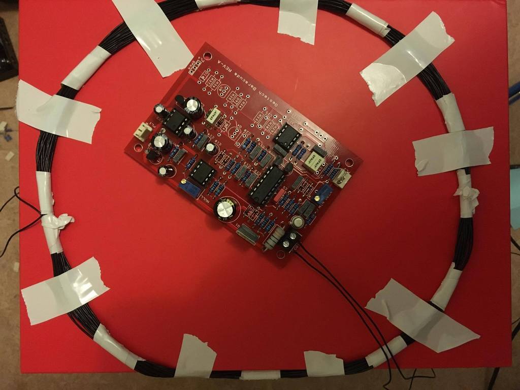

              • Hey guys! Got one problem with the kit, i have only multimetter. i assembled board until step 7, +5v -5v ok, my voltage at U7 pin1 is +1.19 ( this is the minimum i can adjust from trimmer R14) and when i aproach metal near coil is increasing to max +4.5. In the step7 says that i shoud have voltage at U7 pin1 -2.1V. The coil is only for testing 23turns 190mm diameter of 7strand pvc cable 0,12mm. This is what i have... also i get the tone if i connect speaker to u4 pin4 and 0v, and tone if i put the coil near a pear of headphones.
                • And photo
                    The voltage suggested in Step 7 was based a single build, and may vary between different builds. The important point is that it changes when metal is placed near the coil. Obviously, without a scope you are trying to build the project with one arm tied behind your back, and the DVM tests are only there as a guide.
                    • thanks, i did the last steps, is working, 15cm for a coin, but thats a start, delay need to check (no sound for small coin and al foil).
