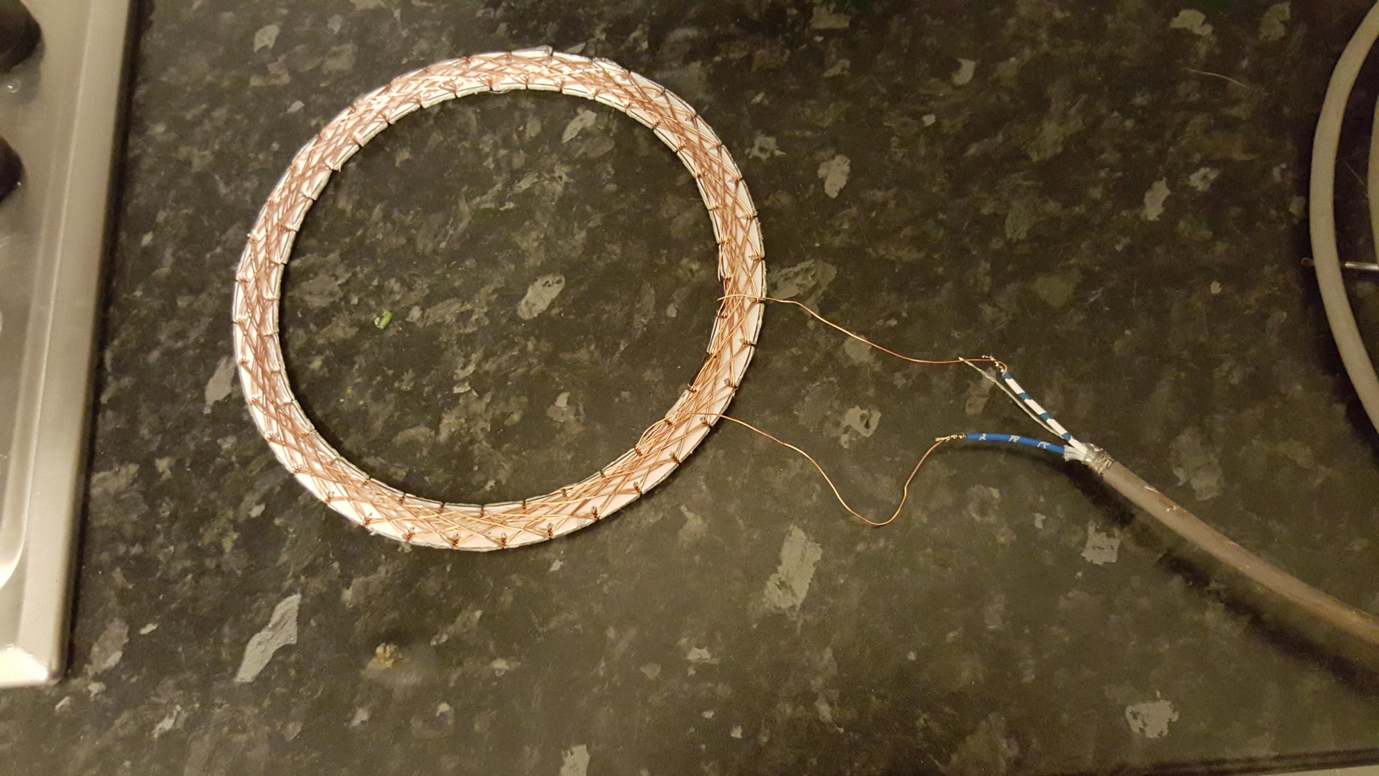

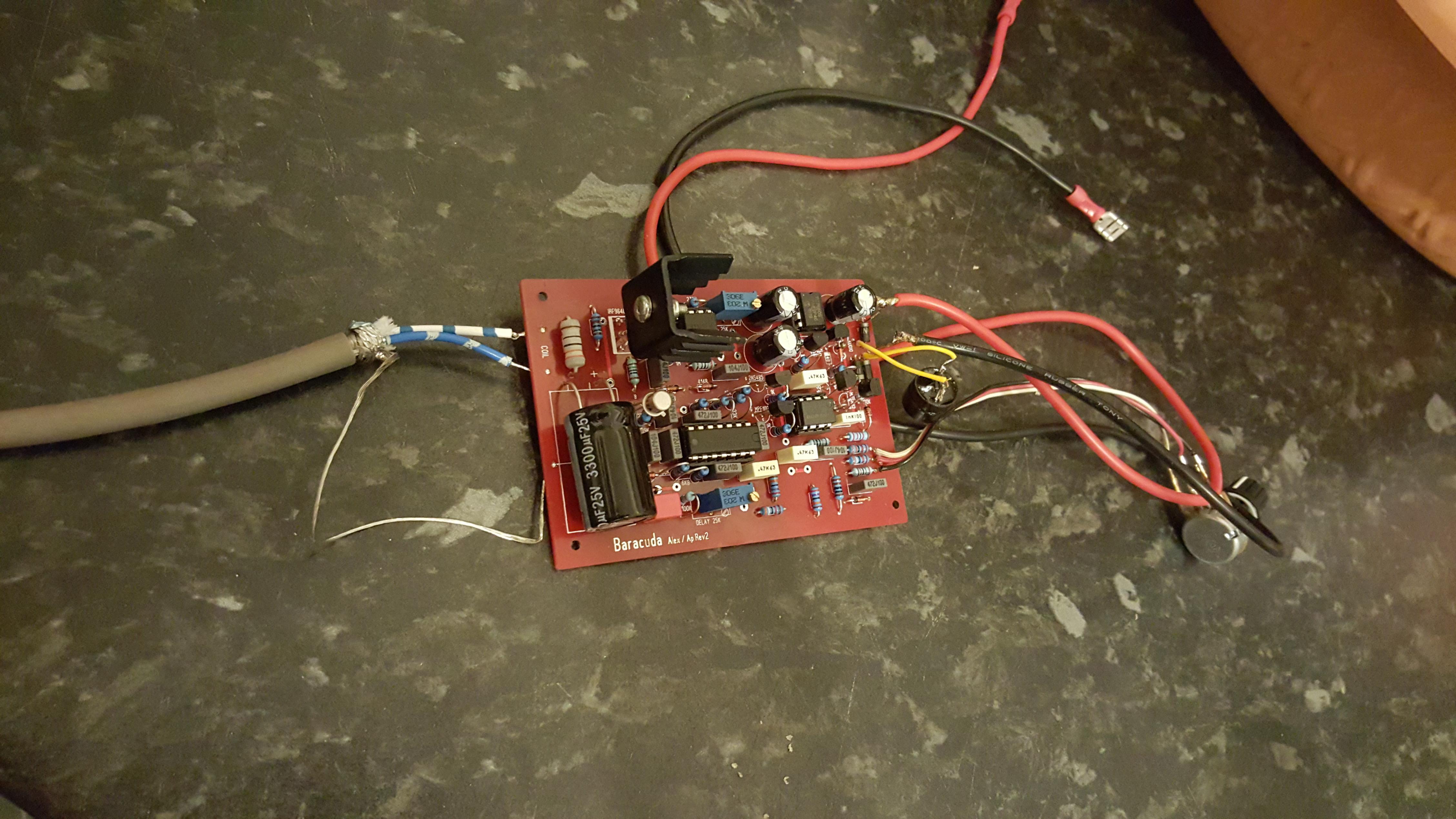

      Ok I have tried the new wire hasn't helped I just get a static like noise if I adjust the delay pot at a certain point I have even tried another coil which didn't help.

        This might be a stupid question ... but you have actually connected the cable screen to 0V at the PCB?
        I see something that looks like it's connected between the cable screen and the PCB in your image, but I'm not sure if that's a wire connection or the plastic covering of the screen.
        • #94
          Yes this is important. In addition to grounding the cable at the PCB ground, you might try connecting the shield at the cable end as well. Try both connections at the coil, one at a time.

            ok i have tried connecting just one end of the shield and 'nothing' and with the shield connected both ends it is better/more stable so i tried taking one loop at a time off the coil to bring the uH down to 'balance' (Im guessing at this point) the coil and i started with 24 loops 10.5" then as i go down (taking loops/coils off) nothing nothing nothing Then i get to 17 and it gets better so i keep going and i reach 15 and i get a scattered/sketchy signal but about 25-30cm away gold ring, also the coil now picks up a 5p (which it didnt before) at about 20cm so i continue to take loops off and it gets worse about 2 loops in so is the 'sweet spot' about 17 turns? i have also taken the insulation tape off the coil so i can do this. I feel slighty hopeful at this point yay. The o-scope should be here wednesday so i will be able to test the circuit (with your help ) and set it up properly. also with each coil/loop i took off i adjusted the top and bottem pots to get the best distance.
            • #96
              Impulse, sounds like you are making progress. The performance you are seeing is in the ballpark of the best you can expect. My guess is a tweak of the damping resistor and it will get very usable.
