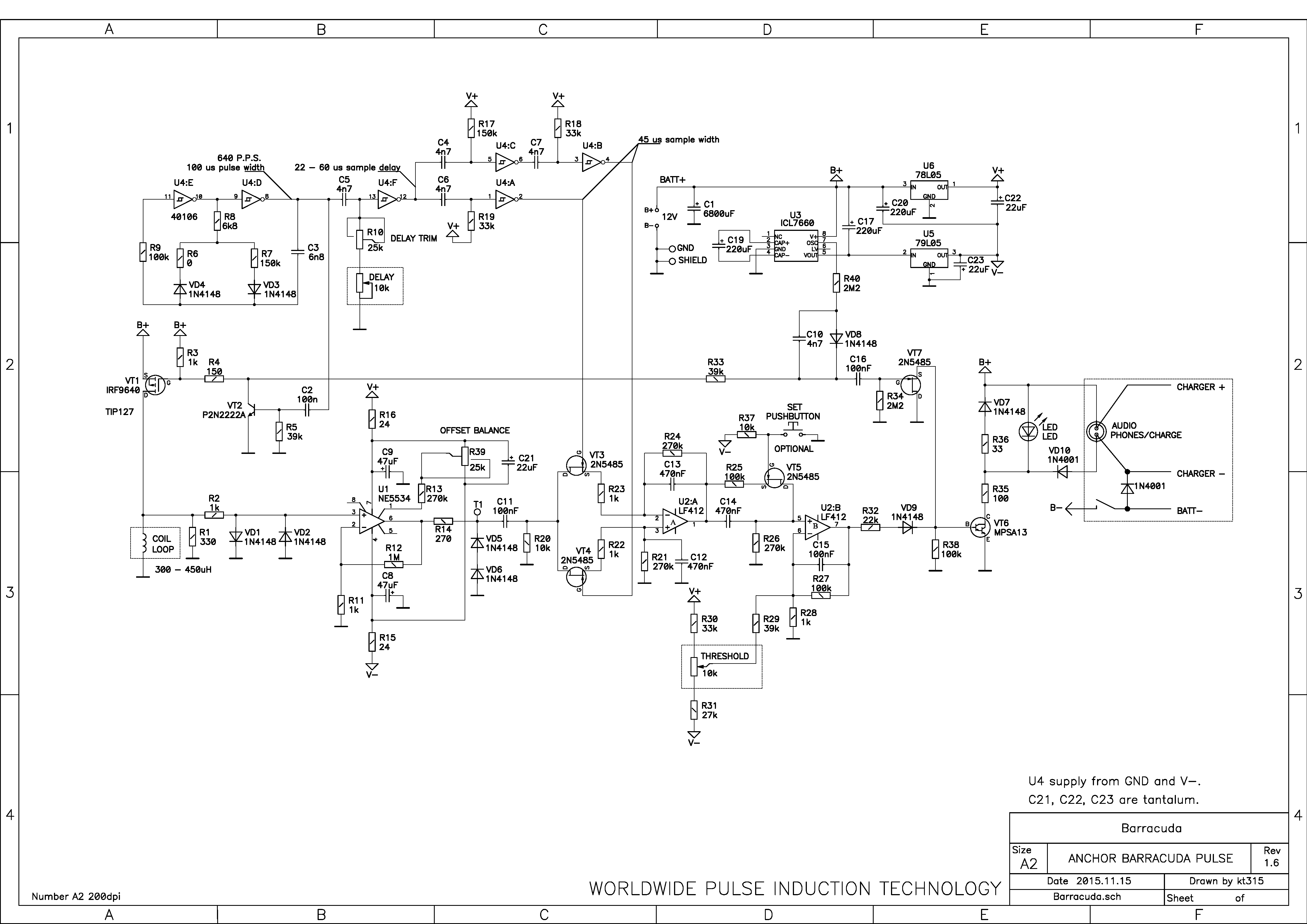

    I'm now going through the design but it appears there are several schematics posted and I don't know which is which...
    Questions:
    Can anyone direct me to the correct schematic for Baracuda (Rev2 Alex/Ap as supplied by silverdog 2016)?
    Have any changes been implemented to improve this design I should know about so I can implement them?

      kt215 has kindly produced a more up-to-date schema, fixing bugs in the original. (Check out the immediately preceding posting to see fixes from the original in the project sticky.)
      http://www.geotech1.com/forums/showt...367#post213367
      This schema does include the pin pointer feature, which has been bypassed in the current kit. The audio output can vary. The kit supplies a buzzer. One can easily add the LED, speaker or socket for a headset.
      Other differences in the kit: The external delay pot is bypassed with a link, so is now an optional extra; the multitude pots are 20K and in my case the coil resistor is 390 ohms rather than 330 (we will all try to increase this significantly anyway I expect ☺);

            @kt315, this one seems to be better but it's missing supply voltage for 40105 (probably +/-5 volts but on some schematics it's 0 volts (ground) and -5)... also missing U2 supply... again must be +/-5 volts.

              ok. you can make sure yourself that all traces are ok on board.

                I'll trace the board I'm using as there may be some differences...
                      Mike
                      On Silverdog's board, I've traced the 40105 supply back to the 5V from the 79L05. Definitely no more than the 5V on this one. One imagines it might be more stable on the 78L05. This may reflect the original commercial design it's based on. And there would be complications with VT3 and VT4, which are not voltage decoupled.
                      I haven't traced it, but U2 will be the 10V like U1. Allowing the op. amp. 5V swing either side of earth. I guess audio is on the full battery voltage to reduce load on the regulators. That makes sense. A slight positive rise from earth voltage and VT6 switches on.
                      I'm missing a lot of the subtlety of the circuit, like the effects of VD5 and VD6, which must clip one side of the signal. It might be useful to vary the main timing pulse width to limit pulse current on a low resistance coil. A wild guess would be to change the ratio of R7 to R8. It is of course a chance to learn about the online circuit simulator frequently referred to in the forum.☺

                              @kt315, can you post that image without the the pop-up (Edit Nets window), that way I can see the rest of the traces?
