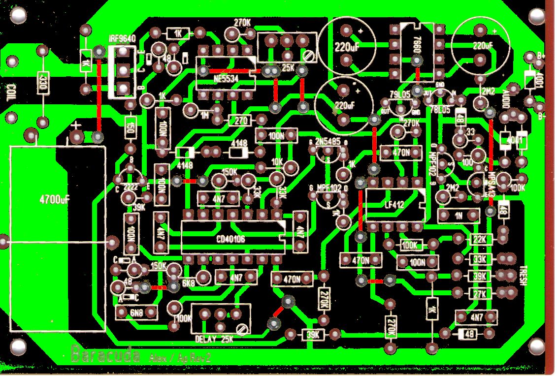

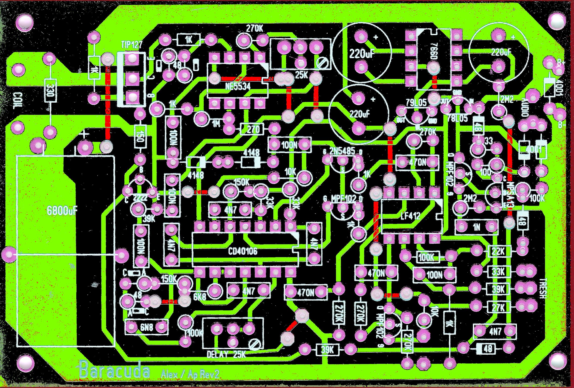

    Just looked at my pcb Rev2, it's different ... the holes and traces for the MPF 102 and resistors are missing ...
    The plot thickens ... drum rolllllll.
    [ATTACH]35721[/ATTACH]
    Well the first effort is great. I love these X-ray views. Thank you. Both boards are rev 2! But they are different!

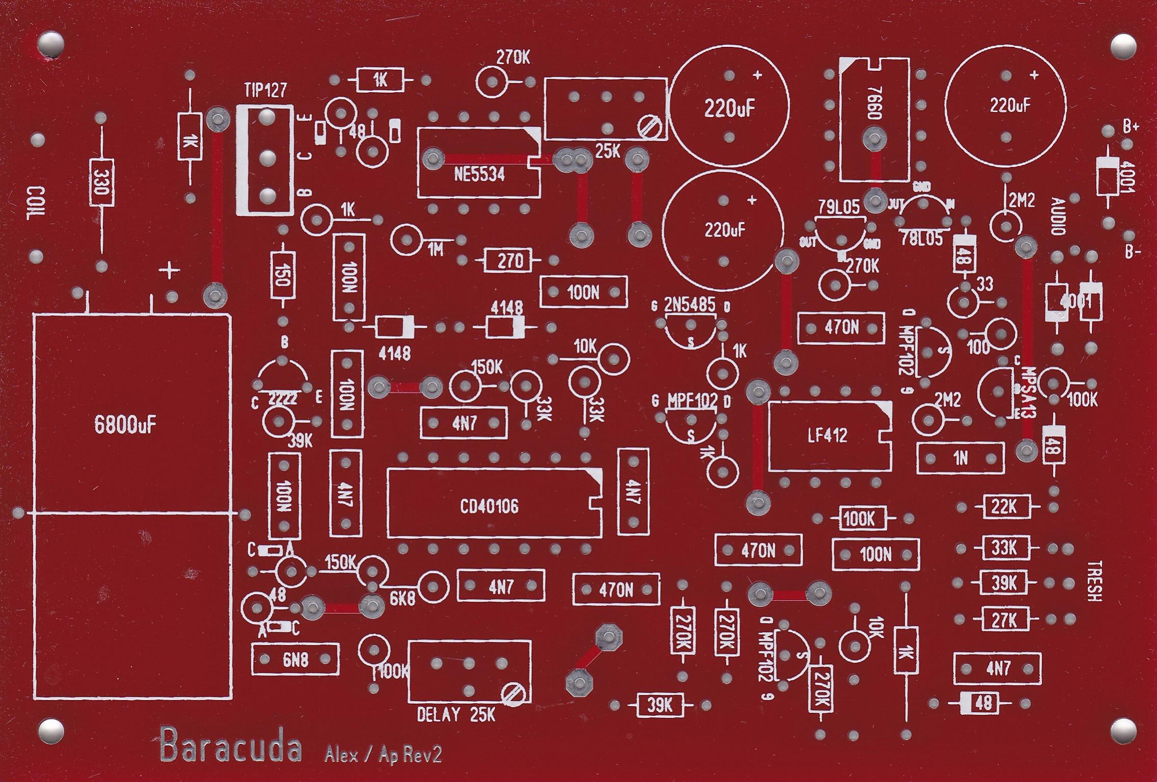

      My pcb in high res for what its worth.
      • #63
        @ Koala & Old cart (about different Rev 2 boards)
        Thanks! I'm seeing some light at the end of the tunnel...
        I always thought different boards have incremental revision numbers.
        • #64
          @ 6666
          Great! High res is always better.
          I have made the two versions of the rev2 board as xray in high contrast.
          Thought that might be better for printing and checking, although I find the lower contrast ones easier on the eyes when on screen.
