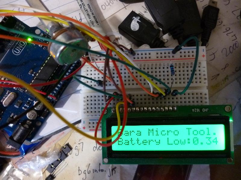

    • Just plugged it in , no buttons.
        You can use a jumper wire from ground to any of the key inputs to test...
        The low battery indication is because the monitoring point would normally go to the battery positive...
        The two resistors divide it down to about 1 volt for full...
        The code is not optimised, it just a quick test... will improve later...
        I am working on two versions...
        I have a standalone version that replaces the 40106 on your Baracuda (I de-soldered the 40106 and fit an IC socket)...
        That way I can plug in header pins (or another socket on top) with the connecting wires soldered in place...
        The other is a complete Bara + Micro in one design... I need to experiment on this one for voltage levels...
        I can post both schematics if anyone is interested but they are experimental...

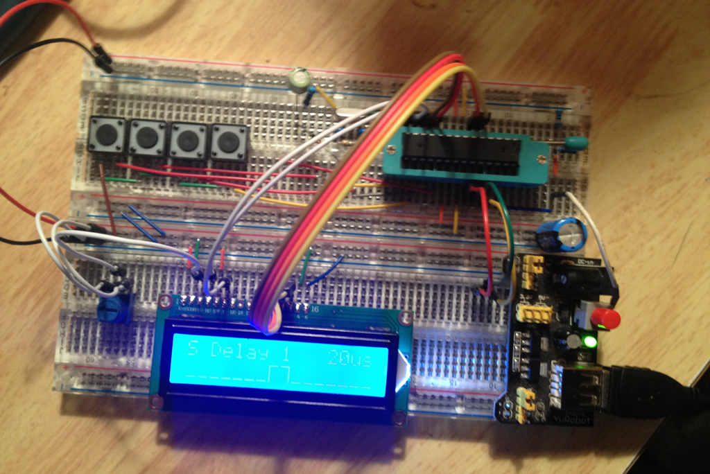

        Here's the breadboard image (poor lighting)...
        Mike
        • I can post both schematics if anyone is interested but they are experimental...
          Please do.
          It appears from my quick test that when the low volts alarm comes up, that over rides the menu function.
          is it pin PC5 that does the voltage monitoring.
            Please do.
            On power up it shows the Name and the Version...
            After a minute or so, it replaces the version number with the battery voltage (or low voltage)...
            Once you press the menu button and pick an option to edit something, the battery voltage is not shown...
            Yes, it's PC5 (ADC5) that monitors the voltage...
            If you want to temporarily turn off the battery part comment out
            Code:
            if(bcount++ > BCT && !in_menu) check_battery();
            recompile & upload...
            Mike

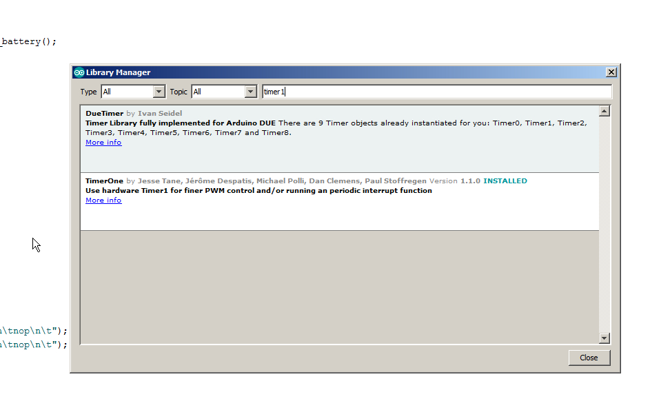

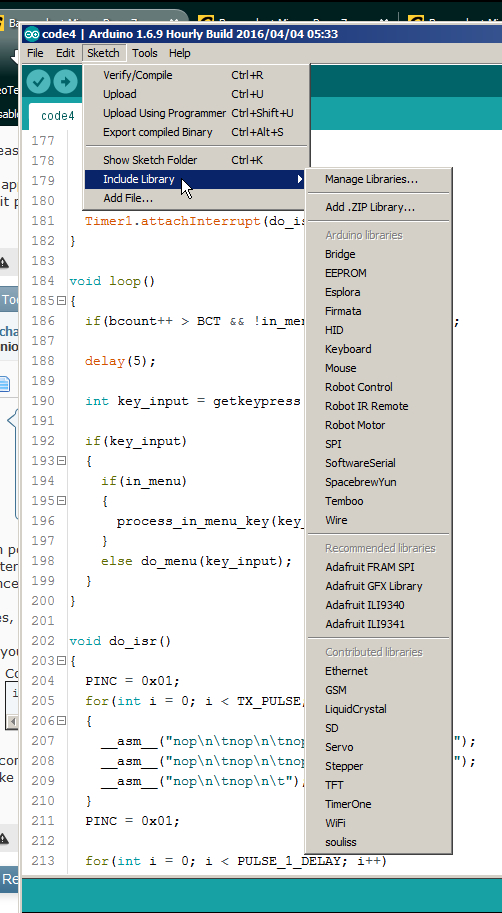

            PS, A quick way to add a library to the Arduino IDE...
            From the menu choose Sketch > Include Library > Manage Libraries...
            In the popup window, type the library name in the filter field...
            Select the one you want to add...
            I think it pulls from the Git Repo...

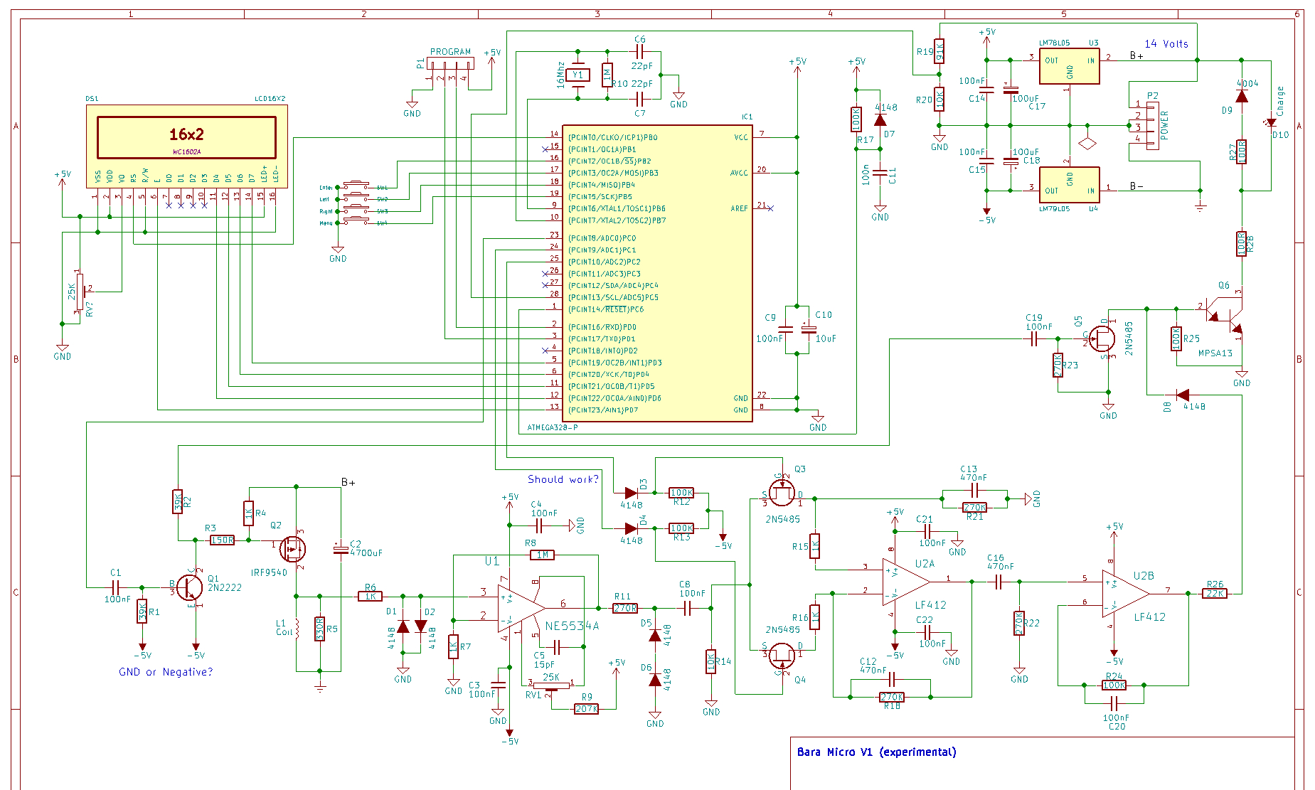

            • Experimental Designs...
              Will post standalone schematic when I find the latest...

                What happened to the 100k on the buttons ?
                can it be dropped,
                I am useing it but cannot get buttons to work with it.
                I took a chance and removed 100k and useing straight ground , now can access the menu
                edited the code ok and defeated the voltage check ok thanks.
                • @6666... I dropped it, it's not required... Check the schematic in my last post...
                  Strange the second image should have been a 3D version of the board but it's the same image....
                  In the above schematic, Q3 and Q4 are biased off as the output from the ATMega are set to tristate (inputs) after pulses...
                  This is a little awkward so I may change the diodes D3 & D4 to caps... as I said, it's experimental...
                  The only other question is the voltage at the emitter of Q1 and R1... ground on all schematics but they don't use a split battery virtual ground...
                  Mike
                  • Ok 100k not required
                    if I just push the menu button I get the "[T] [F] [S] [D]" on the top line.
                    if I push the menu button again I get the TX pulse screen
                    but pushing the menu button repeatedly again I stay on TX pulse screen does not take me back to menu.
                      I think your buttons are reversed...
                      Pushing the menu key twice should bring you to the Sample Delay 1 (S Delay 1 20us)...
                      In the Menu ("[T] [F] [S] [D]"), mine are from the left... TX Pulse, Cycle, S Pulse, S Delay... the button line up the same way....
                      The rightmost button should be the menu if no menu is showing and the D if in the menu....
                      After turn on, pressing any key will displays the menu "[T] [F] [S] [D]"... I might need to change this so that only the menu key brings it up... that way we can determine if things are the right way around...
                      Sugar!!! I don't think I check the key layout... I may have changed it... if so apologies... BRB with any corrections....
                      Mike

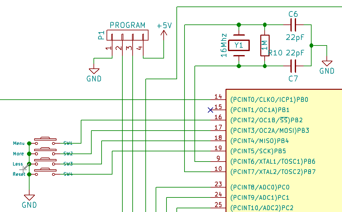

                      • Button Connections
                        PB3, PB3, PB4, PB5 with the menu button being = PB2....
                        On ATMega that's pins: 16, 17, 18, 19
                        On Arduino Uno that's pins: 10, 11, 12, 13 (on the 10 pin connector)
                        The orientation of my Blue LCD with pins on top left... [T] [F] [S] [D]
                        The keys are above in my case but in the same sequence....
                        I had the keys label wrong in the schematic.... is there an avatar for moron handy...

                        • Originally posted by Michaelo View Post
                          [ATTACH]36164[/ATTACH]
                          AHA, IF I PULSE PB2 THE MENU CYCLES, yep the key labels on the schematic were mixed up
                          glad we got that sorted.
                          One push brings up [T] [F] [S] [D]
                          second push brings up S Delay 1 20uS
                          third push brings up [T] [F] [S] [D]
                          Like this
                          https://youtu.be/elsl1mIP5Kc
                          • @6666... Looks good.... remember we only have menus 1 deep, so Menu > Option then press either of the two centre keys to set the value... Once finished setting an option use the menu key to go back to the main (and only) Menu...
                            It's a pretty simple menu as we only have four options to change... if we had more it would be a little more complex... perhaps I should build it with the rotary encoder... I can see a few advantages...
                            The main one being we can use the full 16 characters to display more meaningful information...
                            @6666 ... The video is private!!!
                            • @6666 ... The video is private!!!
                              Please try again changed settings should work now I hope.
